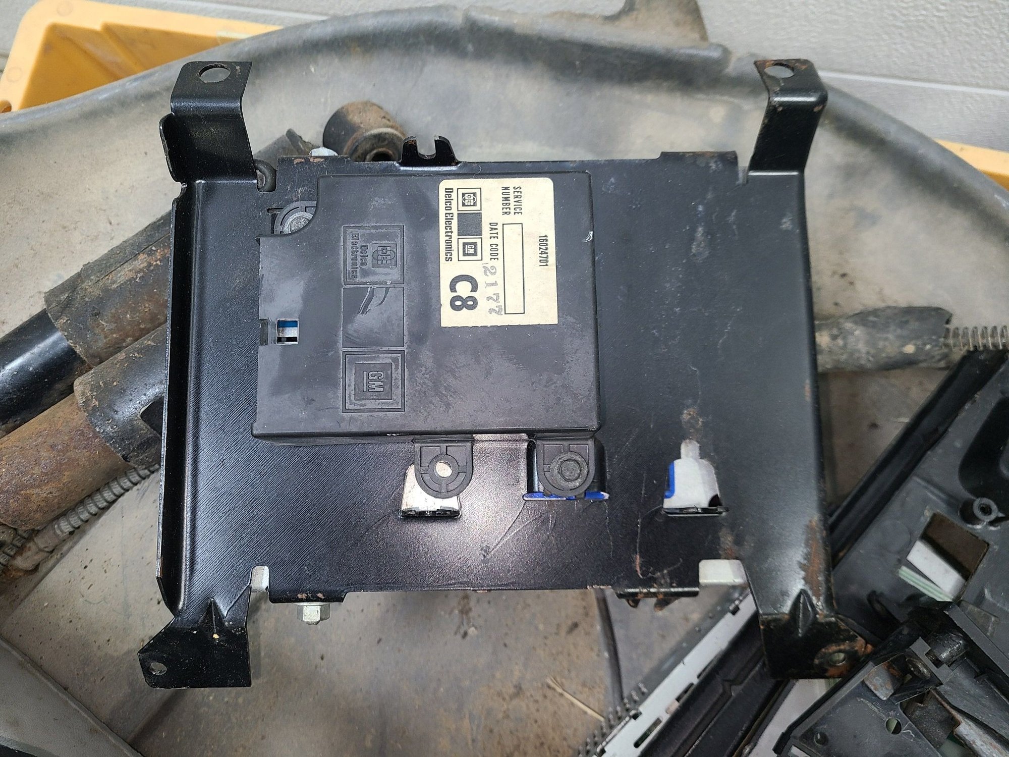

I just want to start a thread documenting my removal of the ECM and Theft Module with lots of help from @Fly skids up! I'm almost there.
I'll start with the ECM location which is in the battery compartment in front of the battery. It's kind of hard to see in there and it's even more fun to remove.
This it the rear face of the ECM, the large holes had rubber expanding nuts and I had to use vise grips on the metal part of the nut while unscrewing the fastener.
Here is the front of the ECM and you can just see one nut that holds the ECM to the frame.
JT
