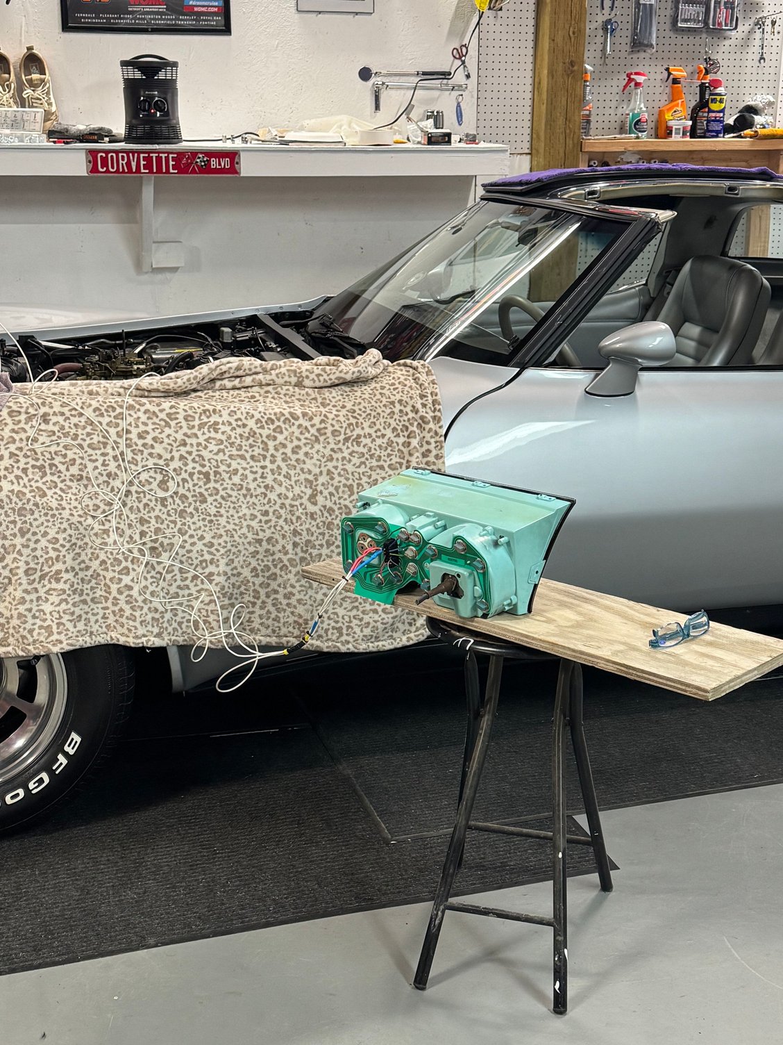

my question to the gurus is this; …if I have another 81 Tach outside of the vehicle I SHOULD be able to wire the tach board to hot, ground and run a signal wire from the HEI to the signal post on the tach board …and that outside tach should operate normally correct?
I have a different tach jumped to a 12v tractor battery and a jumper to the HEI Tach port. The Tach goes to zero when powered to the battery but when I start the car I’m not getting any needle movement…

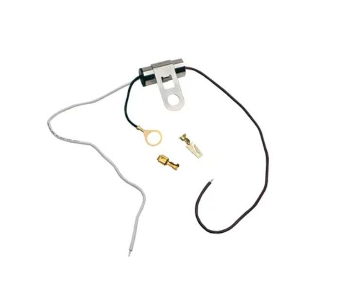

Check the tach filter before tearing the dash apart.
You can make one cheap enough, for a couple of bucks, if you how to use solder and heat shrink. Used to be able to buy the components to build one at radio shack but I reckon you'd have to buy them online nowadays .....
Here is what they are purchased.....I'll go find the post for how to make one.
https://www.corvettecentral.com/75-9...lter-ca-393125

Thanks for the reply! …yea that was my next hurdle after bench testing a Tach externally was replacing the filter. I’ve unplugged it to bypass it. The new filters have a ground wire …I don’t see that the OEM filter has a ground wire. Wondering if it’s grounded just the way it’s mounted.

Don't skimp on grounds make your own if you have to.... however the image in that corvette central website does show a ground

I'm certain my tach filter doesn't have a ground wire. Would assume it's grounded through the mounting strap.

Hey guys just an update…I used the power and ground at the under hood light and the bench test was a success 👍
I don’t know why it didn’t dawn on me that t
he signal and the power had to have a common ground …electricity is a Voodoo science to me 🤣
I also connected the signal wire to the dash side of the OEM filter and it works good also.
