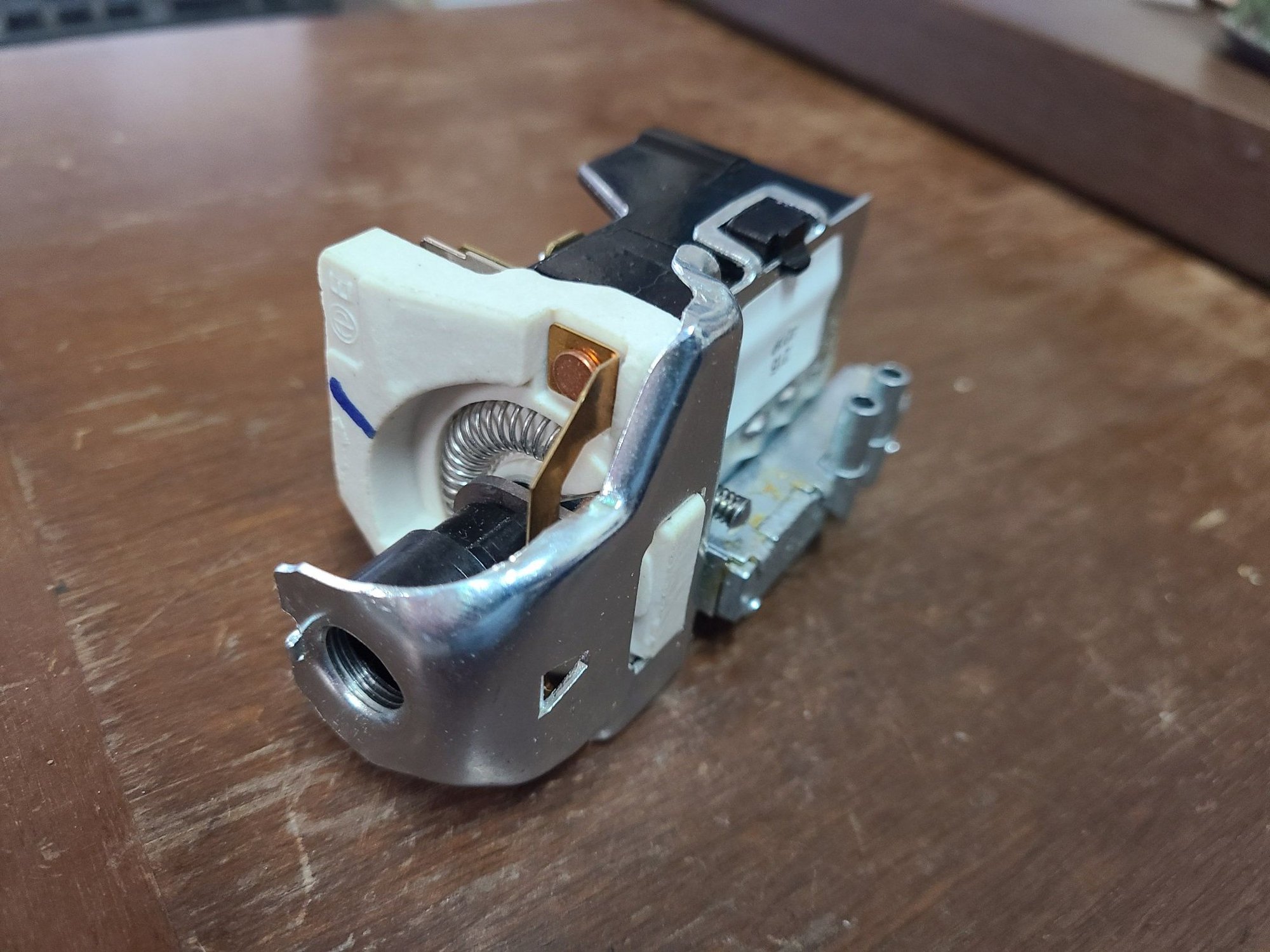

This is what the replacement switch looks like, the part that fits into the dash is much bigger at the bottom than the OEM switch.

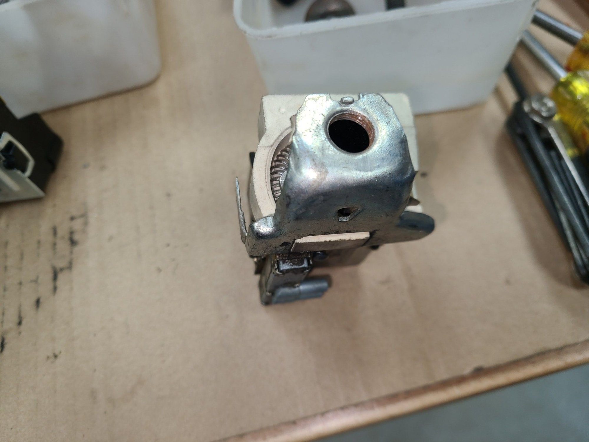

This is the OEM switch, I should have taken a photo at the same angle as the file photo above.

Originally Posted by BKarol
The 78 AIM calls for part #1995215 which Zip references. Part #1995191 is for a 77. Is there a number stamped on the part you received?
The 1982 Factory Assembly Manual calls for the same part #1995215. Doc Rebuild shows a photo of the correct switch and mentions there are differences between the Chinese version and the USA version. Most notable is the front part with the threads in it, the bottom curves up faster on the USA switch than the Chinese one. This is the reason it won't fit in the recess of the dash. Other wise the switches are pretty similar.

Old Jan 30, 2026 | 04:44 PM
jthornton's Avatar
jthornton
Joined: Apr 2023
Posts: 2,597
Likes: 1,565
From: Poplar Bluff MO
Here is the NOS OEM 1995215 headlight switch taken at a similar angle to the china one and you can see the bottom is sloped up faster than the china one and the nose is a bit smaller as well and that's why the china switch won't fit in the recess of the 82 dashboard.
