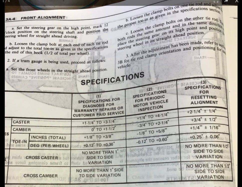

not sure if your alignment shop offers but i do the 1 year unlimited alignment (Belle Tire) when i work on suspension and after every job have it aligned. Tips-
- make sure you have a trusted guy who knows what they are doing
- get SS shim package so they can dial it in. They will not have any for the rear, and the fronts i just use standard ones and shape as needed.
- once you find a guy tip well.
- get printout before and after
- i use factory rest specs on my 79 no issues.(pics)
- some may recommend another custom alignment but depends on usage.
- measure your end play in the axles. I was very surprised how that improved handling when tossing around.
- good advice/ replies
good luck!
