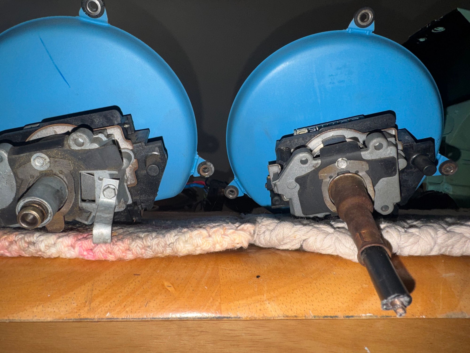

Hi guys, question regarding the unique speedometer on a stock 81’ with VSS (vehicle speed sensor) on the back…
Ive read everything I can find about it but still murky about specifics. My question is does the VSS simply control the lockup TC? …meaning if it’s not connected the trans behaves ‘normally’ except for lockup?
Or with it not connected is the trans ‘wonky’ now in some way …meaning not shifting correctly at shift points etc. Thanks in advance for any input…
