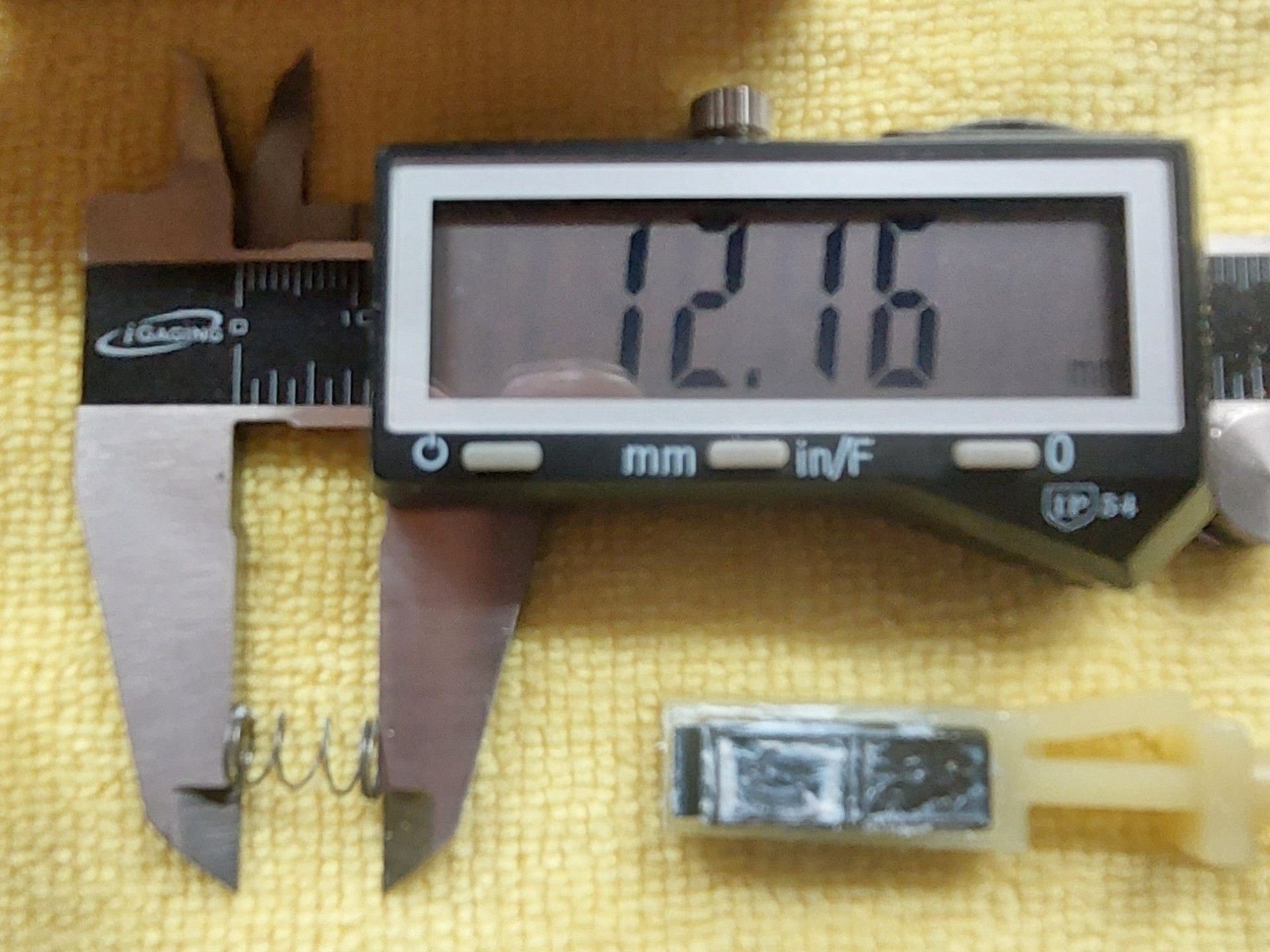

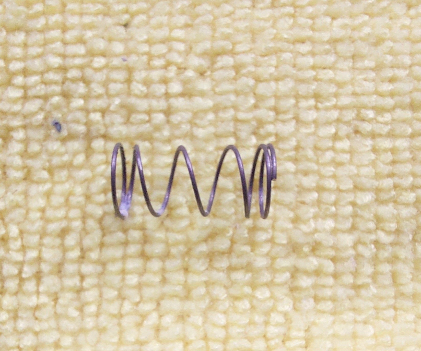

Yes there is a spring inside...
It measures a little over 12mm or a 1/2" in length...
If you look inside the switch housing you will see at the bottom a round post, the spring rests around that to keep it centered...
Hope this helps...
