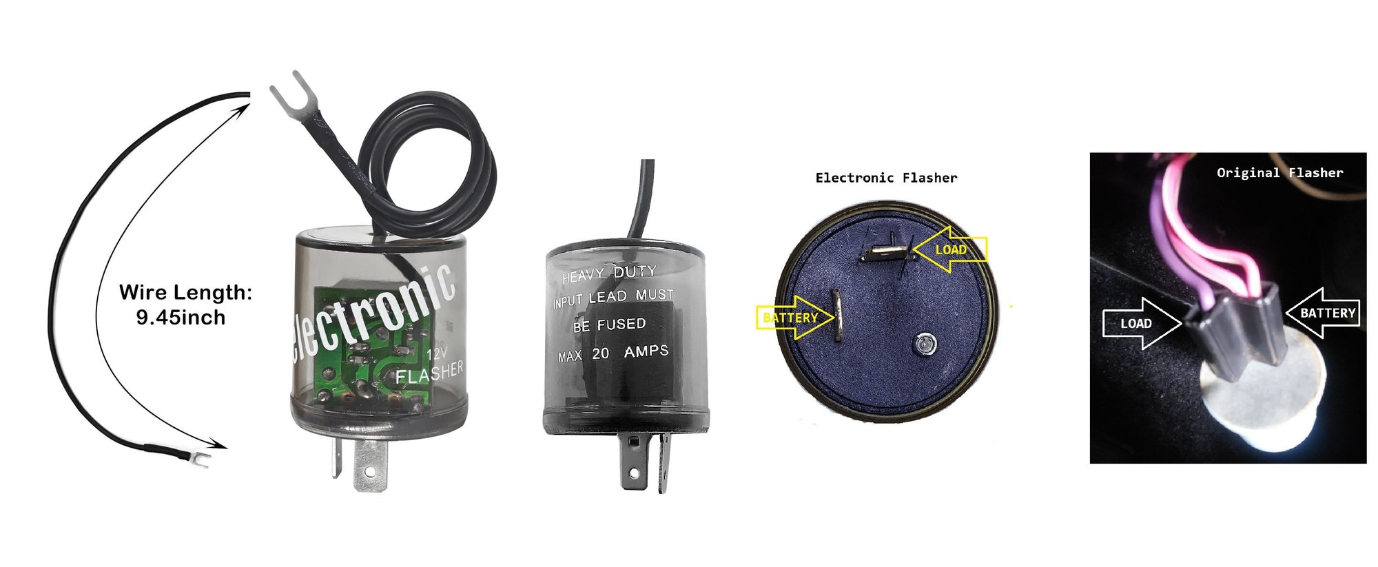

You will need an electronic flasher relay in place of the original bimetal flasher relay (behind map pocket)
One thing I did have to change was the polarity at the flasher relay, simple pin change...
The new flasher relay terminals may have a L & B embossed near the terminal I needed to swap mine around.
Here is the style of Flasher relay I used...
