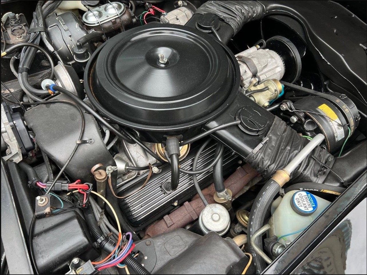

You're going to remove fan shroud, belts, radiator fan, along with the alternator and compressor...or move compressor aorund with hoses attached (if A/C). An L82 is a bigger radiator vs. L48. I took pictures and notes I'll search around to seem if they would be of help.This is an L48 automatic.
Why wait...here's the engine compartment somewhat bare less engine. You'll see the radiator in place but I have removed everything with radiator removal next step. I took the compressor off...it needed to be rebuilt. I was in process of replacing engine gaskets, refurbish and paint engine and general engine compartment refresh to factory materials and finishes. one that would comply with an NCRS top flight TIMJG event. If its an automatic...then tranny lines have to be removed and that means fluid catch or flush tranny. Did that too.
I stand corrected that is the A/C condenser assembly. Radiator has been removed.

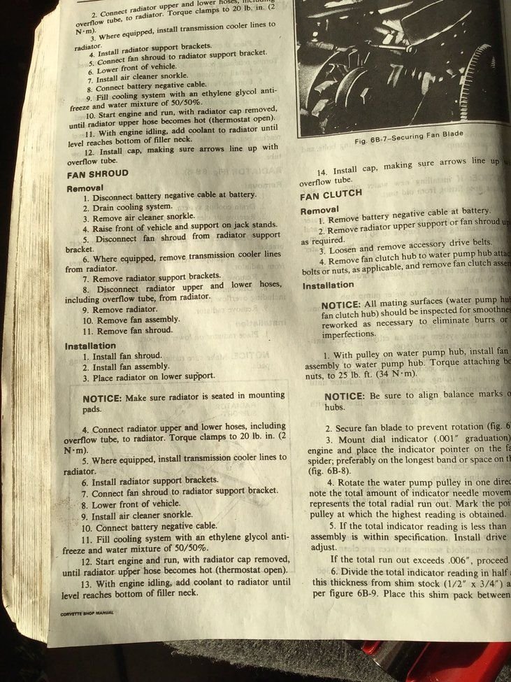

Finally getting around to installing the new radiator — life had taken over for a bit. I’ve pulled the water pump, thermostat, radiator, and shroud. Now I’m a little concerned about putting everything back in. I’m planning to follow the manual and go shroud first, then the radiator, but wow… it’s tight in there. Really hoping I don’t ding up the new radiator on the way in.

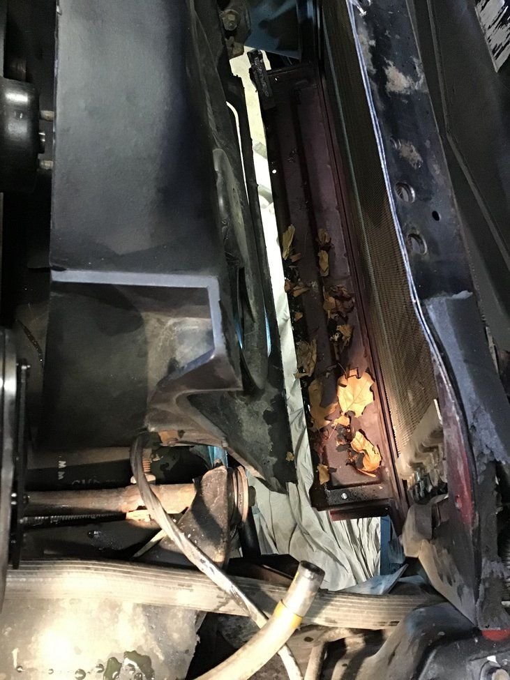

While it's out.....inspect the lower section of the rad cradle/support for corrosion. Now is the best time to replace it.
