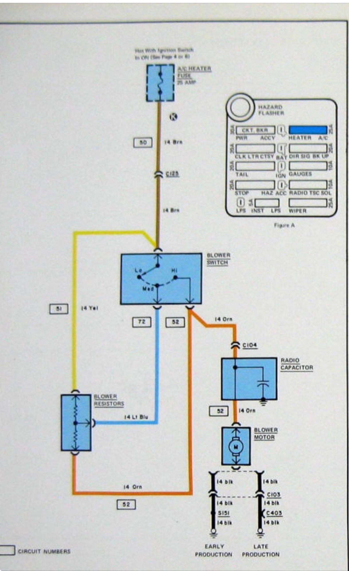

You could have bad resistor. Check the voltage on the resistors with the switch in the different positions. The orange wire is the output of the resistor.

Diagram helps a lot. Check that brown wire at the switch. It should have 12V with the ign on. With no fan at all, no matter what position the switch is in, its probably the switch or the brown 12V line to the switch.

I got it working! Thank you all for the help! Was no power in the brown wire. Thanks again!
