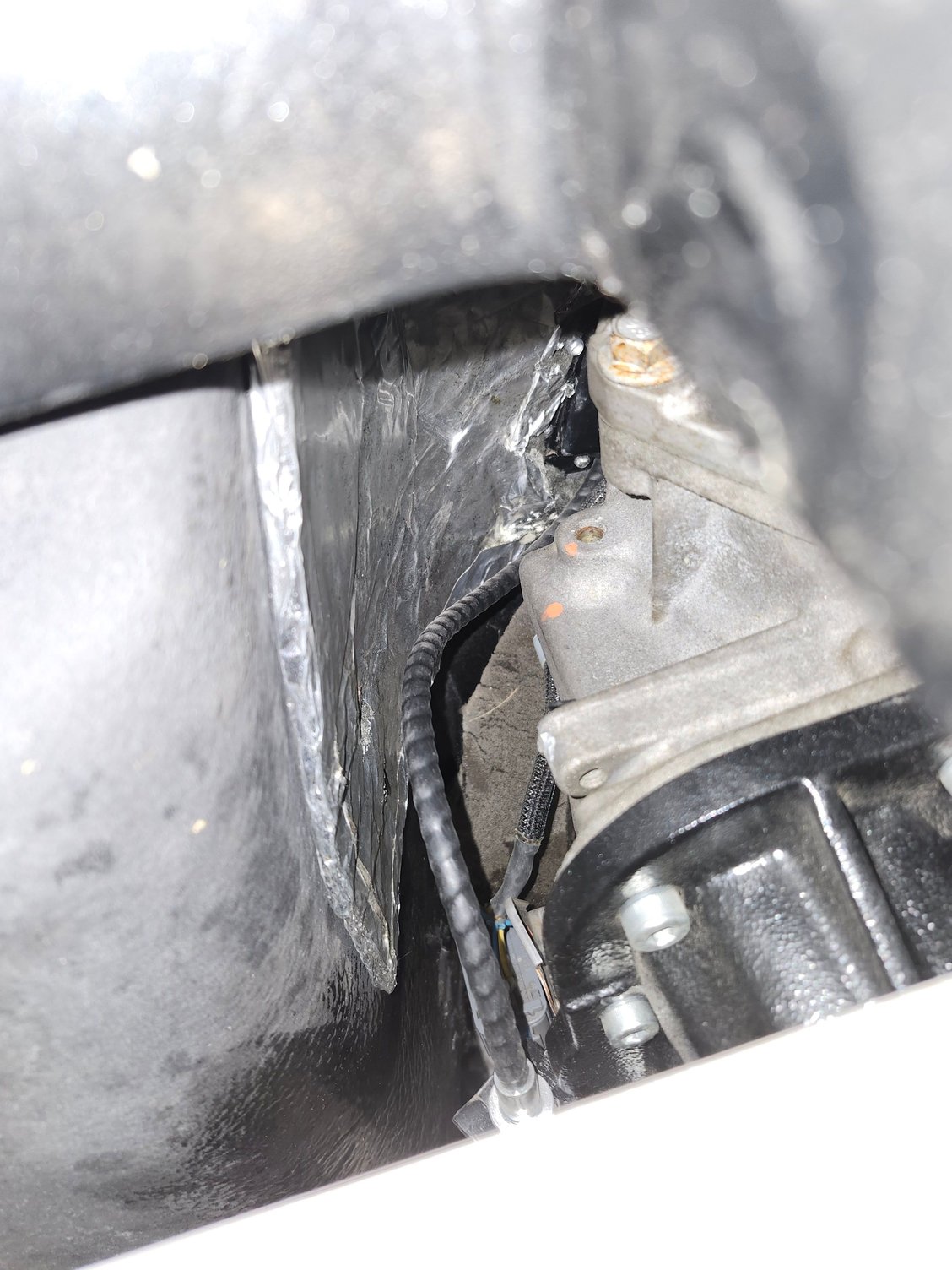

It's been a couple of years since I installed it, and I have a 4L65e trans in the car not the original 400. If I remember correctly mine has a fairly sharp bend to it and it works good. If you would like I can try to get a Pic.

Here are the pictures, not great but shows the bend radius.
