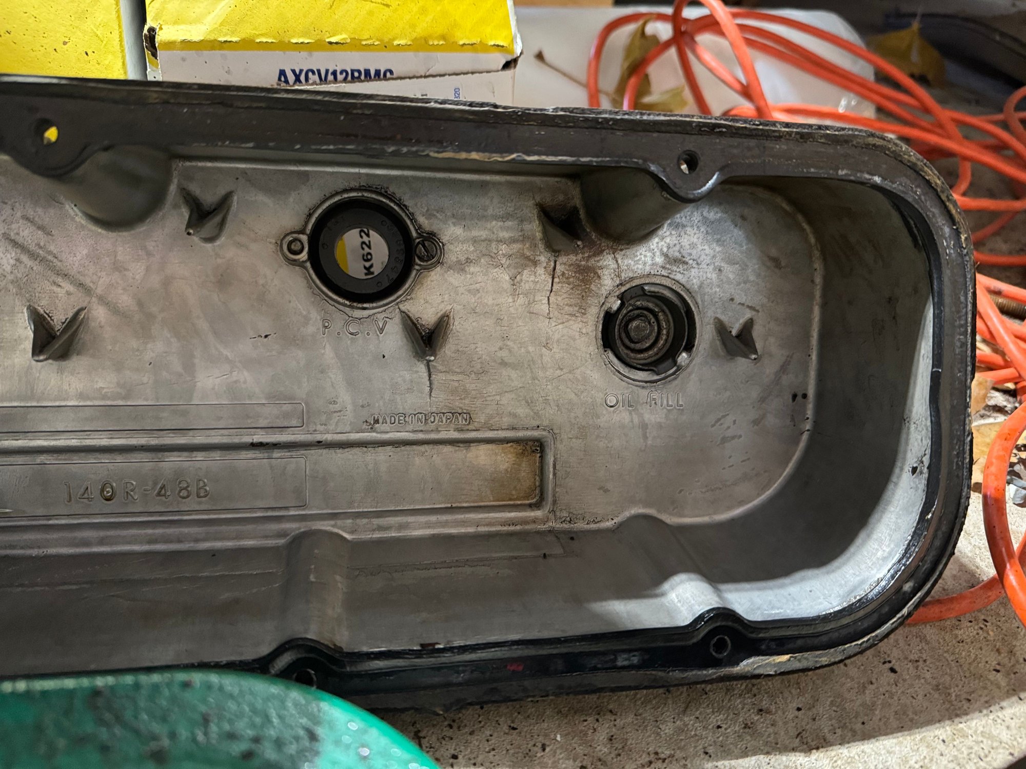

Replacing the valve gaskets and when I took off the drivers side cover I found this part floating around. It looks like it goes where the hose connects to the brake booster as I see it missing the top of the screw on the inside of the valve cover.
trying to find out specifically what it is and if I need it.
Old Mar 1, 2026 | 06:34 PM
1860army's Avatar
1860army
Joined: Feb 2020
Posts: 904
Likes: 569
From: Central NJ
Looks like it might have been an oil baffle, Hopefully that screw and the little piece missing from the baffle are just laying in the bottom of the pan...

Old Mar 1, 2026 | 07:22 PM
BKarol's Avatar
BKarol
Joined: Sep 2004
Posts: 3,227
Likes: 670
From: Northeast
Looks like these:
https://www.summitracing.com/parts/H...GB410Bx9mYmi_S
Old Mar 1, 2026 | 07:32 PM
BKarol's Avatar
BKarol
Joined: Sep 2004
Posts: 3,227
Likes: 670
From: Northeast
Ai added this
"The Holley 241-218 valve cover baffles are
bolt-in style aluminum baffles designed for specific Holley valve covers (often the Vintage Series or similar). They are attached to the underside of the valve cover to prevent oil from entering the PCV system.
Installation Method:
  • Positioning: The baffles are installed on the inside (underside) of the valve cover, directly underneath the PCV/breather hole.
  • Fasteners: They are secured using self-tapping screws that are generally included with the baffle kit.
  • Thread Locking: It is recommended to add a thread locking compound to the screws to ensure they do not vibrate loose.
Old Mar 1, 2026 | 08:48 PM
Rebelyell's Avatar
Rebelyell
Joined: Jun 2025
Posts: 1,722
Likes: 598
seems this whippersnapper AI has yet to discover staking or safety-wire.
Old Mar 2, 2026 | 11:49 AM
jlawn's Avatar
jlawn
Joined: Jan 2025
Posts: 85
Likes: 60
From: Grand Rapids, Michigan
Originally Posted by BKarol
Thanks for tracking it down for me! Sounds like i definitely want to replace it.
I did find "most" of the screw head. Looks like it fell off well before i got the vehicle.

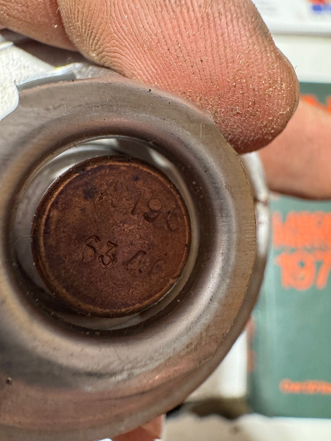

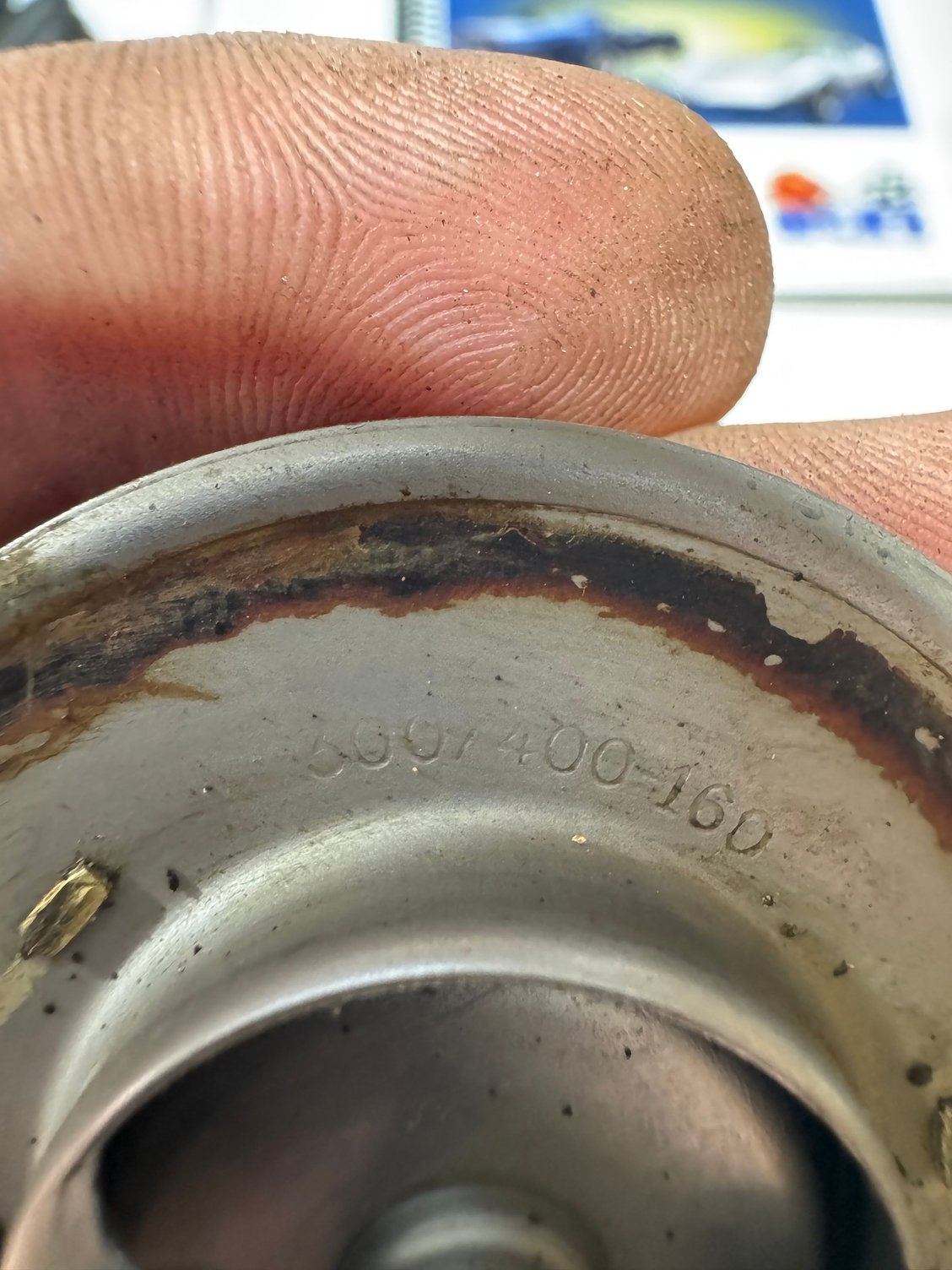

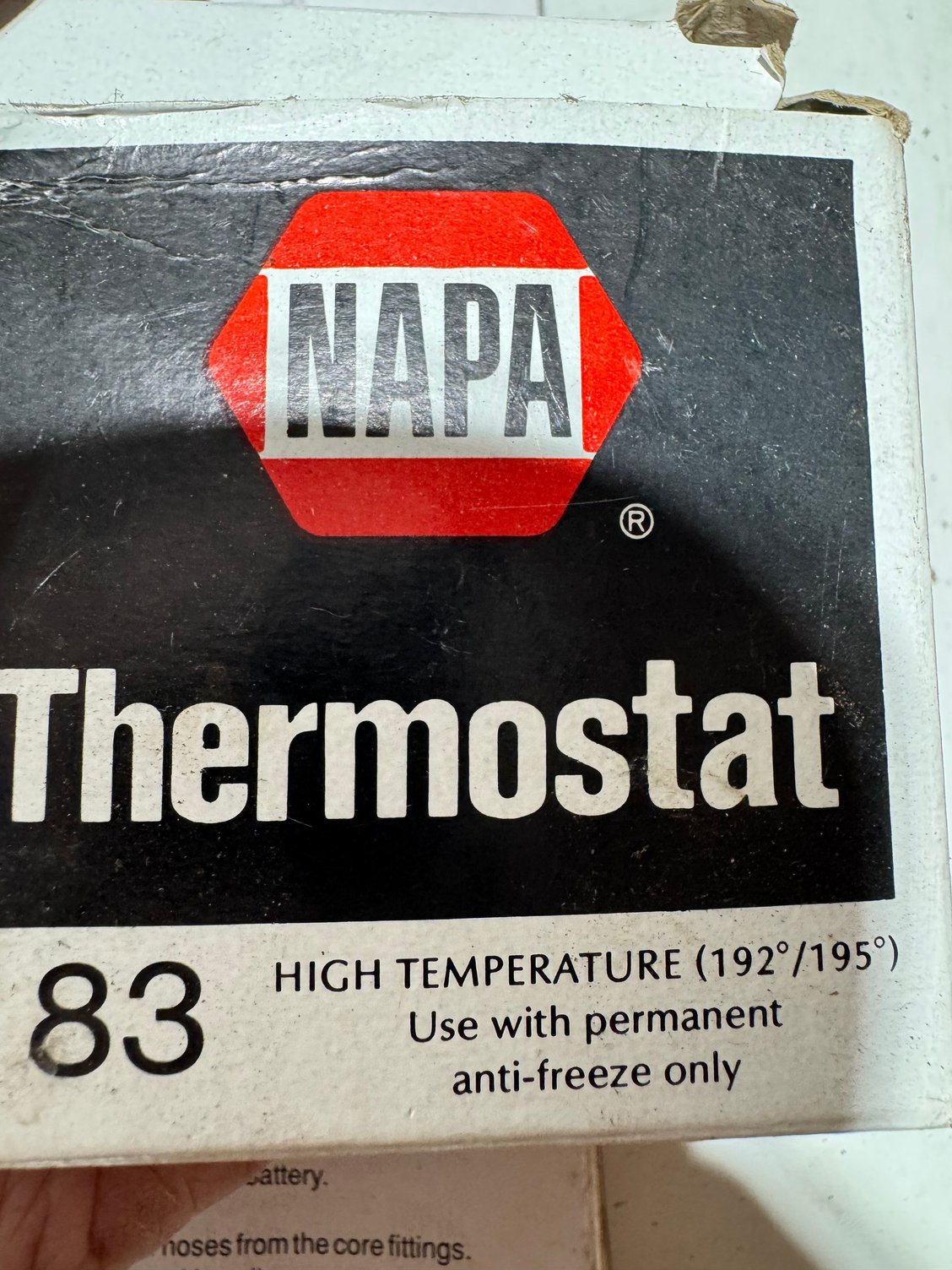

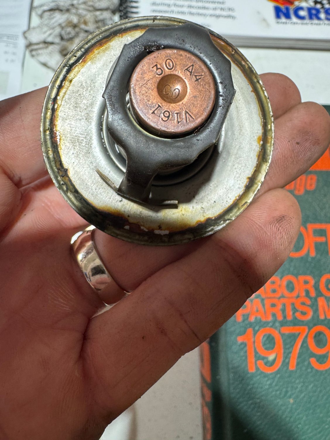

Going to keep my random parts thread going while I work on my intake manifold replacement.

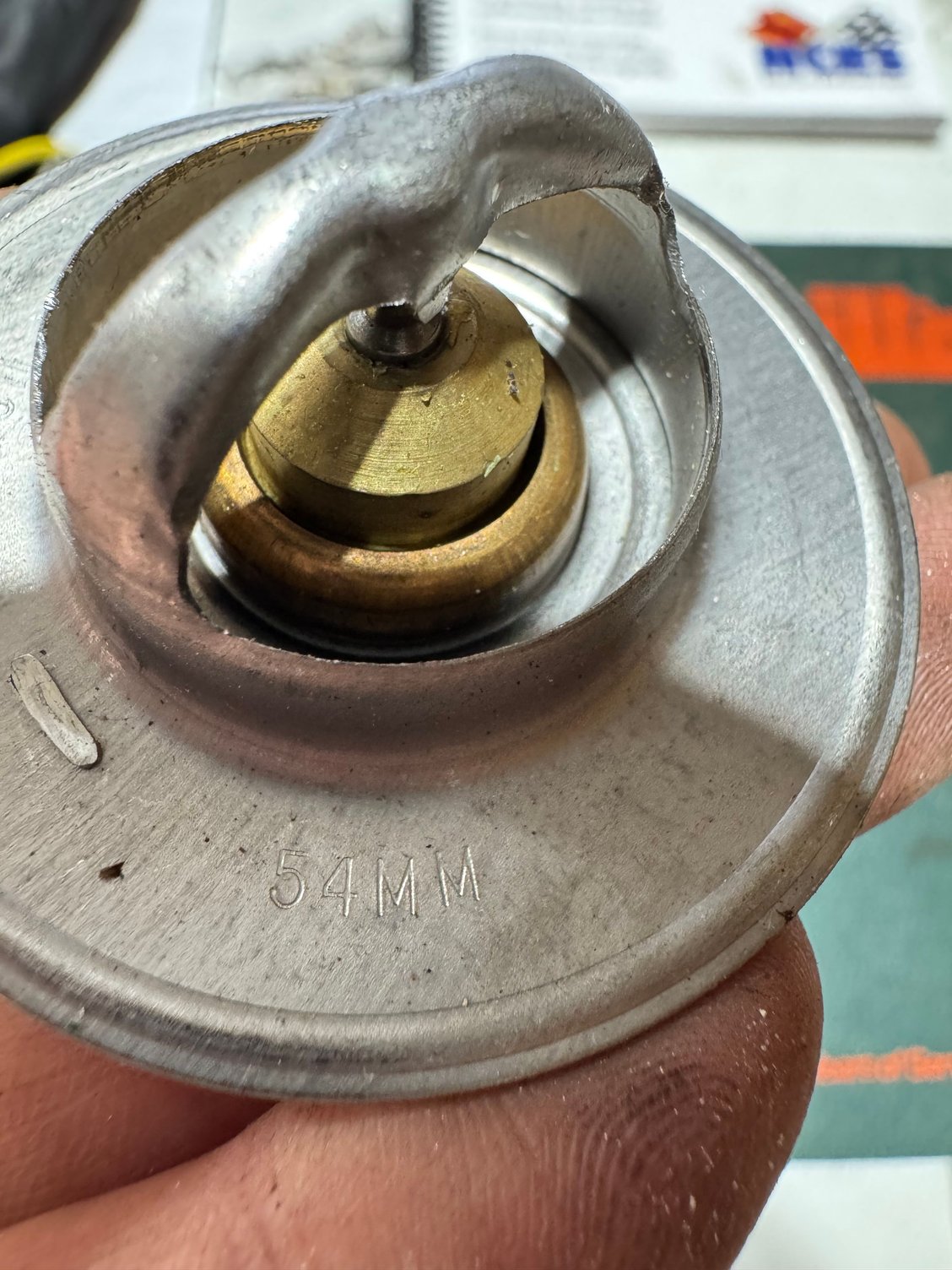

I discovered it had what I think is a 160 thermostat in it. Strange considering everything else is stock.
in the bucket of parts that came with it was a 185 thermostat in a nice vintage Napa parts box. If I am not planning on racing or modifying any other parts, would I have any reason to keep a 165 thermostat in it?
let me know if I should have started a seperate thread.
Old Mar 7, 2026 | 12:48 PM
OldCarBum's Avatar
OldCarBum
Posts: 14,406
Likes: 8,212
From: Napa Valley California
I wouldn’t run an old thermostat you found in a box.
Thermostats are cheap and I would install a new 185 degree high flow.
The high flow design just allows a higher volume of coolant to pass and not restrict the flow as much as some designs will.
As always, put the new thermostat in a pan filled with water on your stove and put in a cooking thermometer so you can watch at what temperature the thermostat starts to open and at what temperature it stays fully open.
Most will start to slowly open at their rated temperature and will be fully open approximately 5-7 degrees above that.
Old Mar 7, 2026 | 12:56 PM
jlawn's Avatar
jlawn
Joined: Jan 2025
Posts: 85
Likes: 60
Fantastic, thank you!
Old Mar 7, 2026 | 11:11 PM
barkingrats's Avatar
barkingrats
1967 Pedal Car Champion
Joined: Mar 2020
Posts: 9,137
Likes: 4,248
From: US-PNW
I'll chime in and say I'd have no problem using an old thermostat in a box. I like the old Robertshaw thermostats and have bought a few NOS off of eBay; none have failed yet. It's not like there are any electronics or mechanical friction, it's only moving from thermal expansion and contraction against a spring. Do the same pan of water test Old Car Bum mentioned above and check it.
BTW, a simple "trick" is to drill one or two 1/8" holes in the flat "sombrero" portion so any trapped air easily passes through. The amount of water using this bypass would be quite minimal and have no effect on its function.

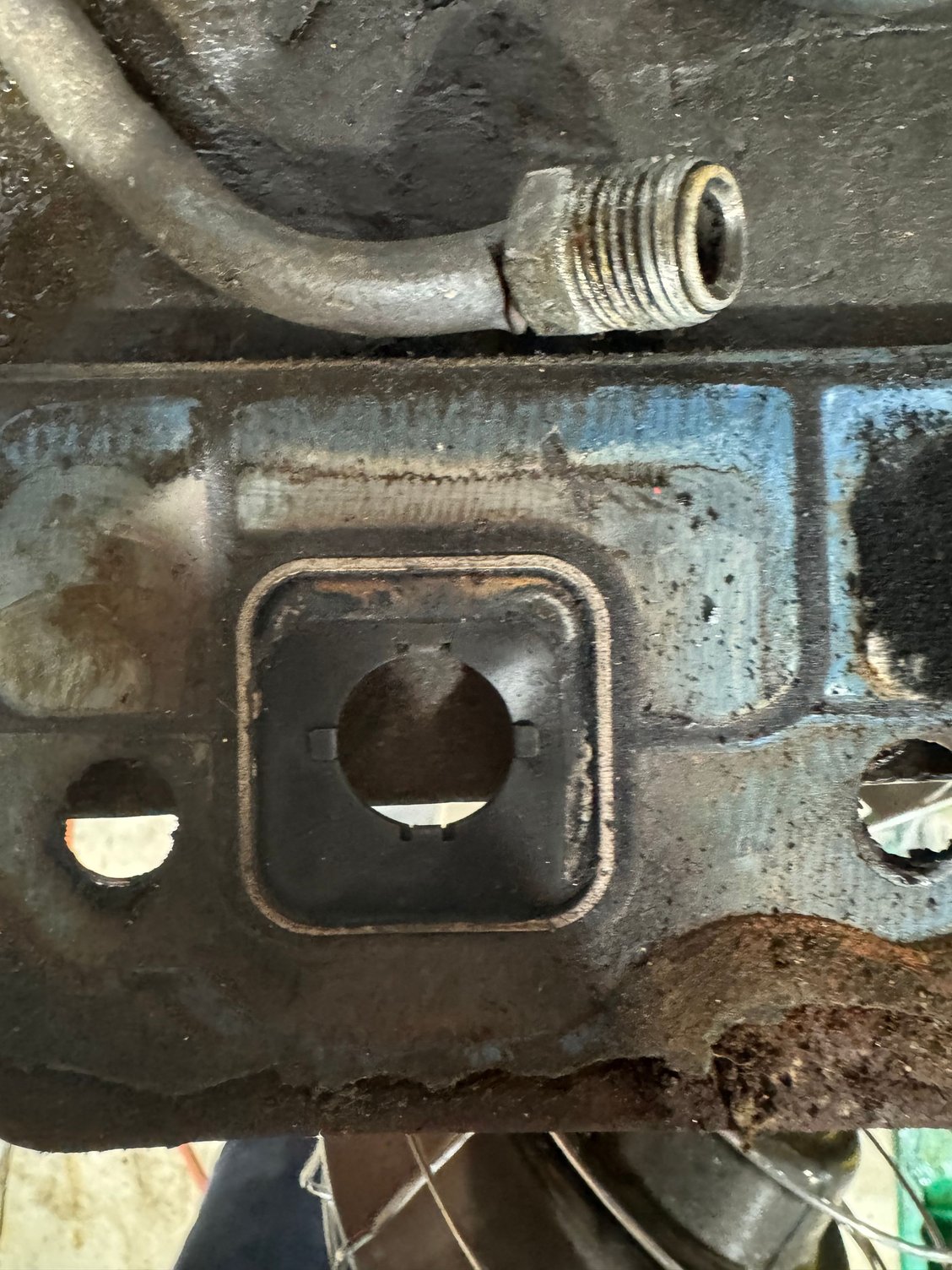

So I went from losing parts to extra parts.
pput the manifold in last night. Torqued it down and let it cure over night.
started putting parts back on the morning and realized I did put the restrictor plate back in the passanger side.
Did I just make a big boo boo and need to tear it back off now?
74 454, so you don’t have to search the thread for this information.

Nope, this little guy that goes in the intake manifold gasket.
Old Mar 15, 2026 | 02:49 PM
1860army's Avatar
1860army
Joined: Feb 2020
Posts: 904
Likes: 569
From: Central NJ
Yeah it helps with carb warm up on the stock system.... People go either way with it.. Won't effect performance enough to notice either way..

It mostly depends on where you live and also your intake manifold.
If you live in warmer climates or drive through stop and go traffic, it would be best to install the block off plates.
Cooler climates, driving in cool or cold temperatures you may want to leave the plates out.
Some aftermarket performance aluminum intake manifolds and cylinder heads are cast without any crossover.

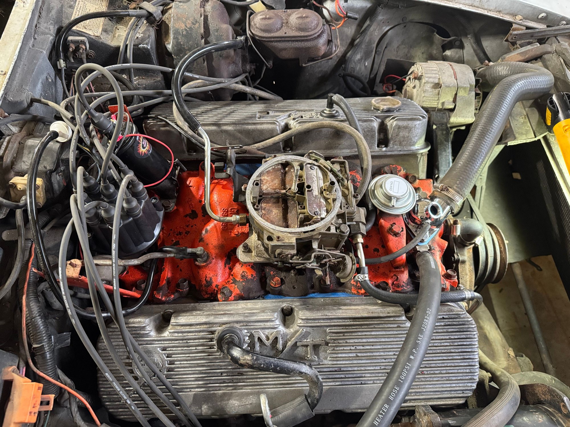

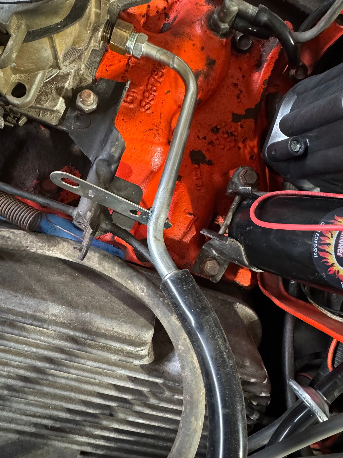

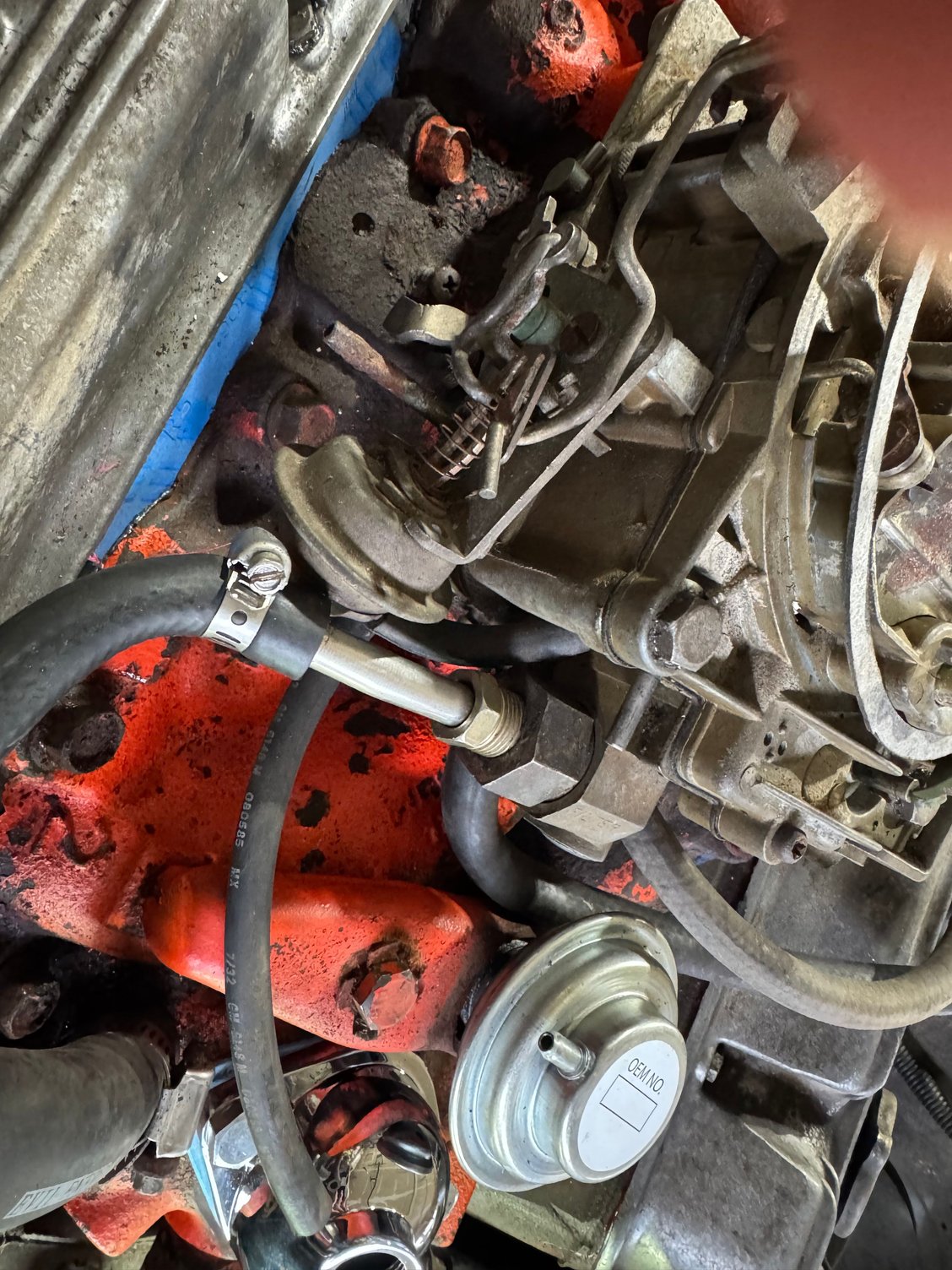

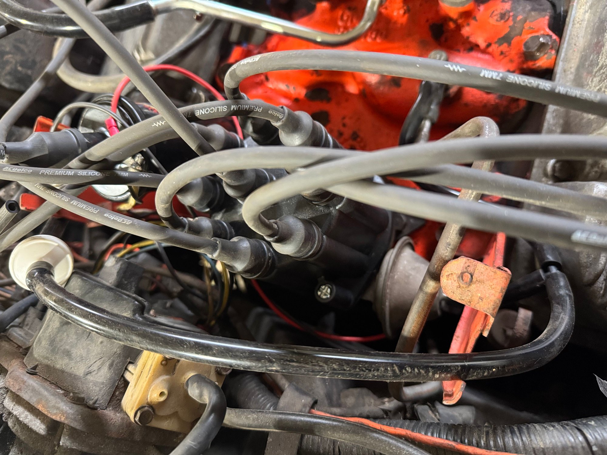

You were close. Grand Rapids Michigan. Once they start salting roads it will be parked for the winter in an enclosed garage. A good guess would be thanksgiving to Easter.

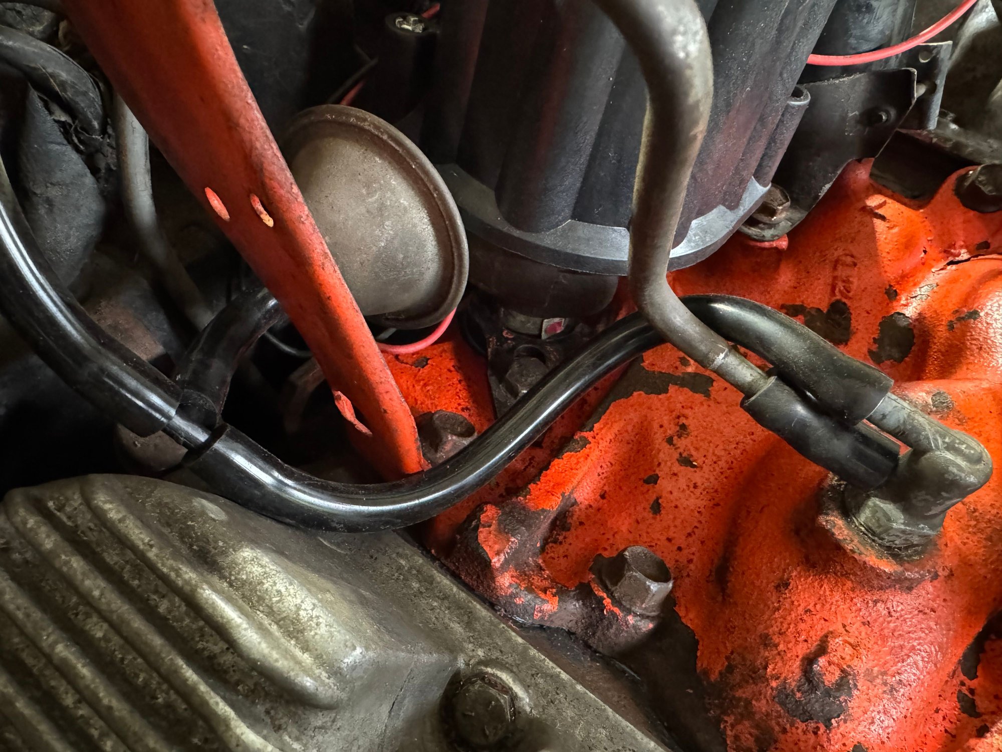

would someone be able to double check my vacuum hoses. I don’t think the previous owner had them hooked up right.
the wiring diagrams and factory assembly manuals I have don’t match my engine design. The EGR valve is in different spots or a AIR pump that I don’t have.
I also should have named the thread intake manifold replacement questions.
This switch is still on order, but I have the 2 lines connecting to the vacuum switch on the thermostat housing.
