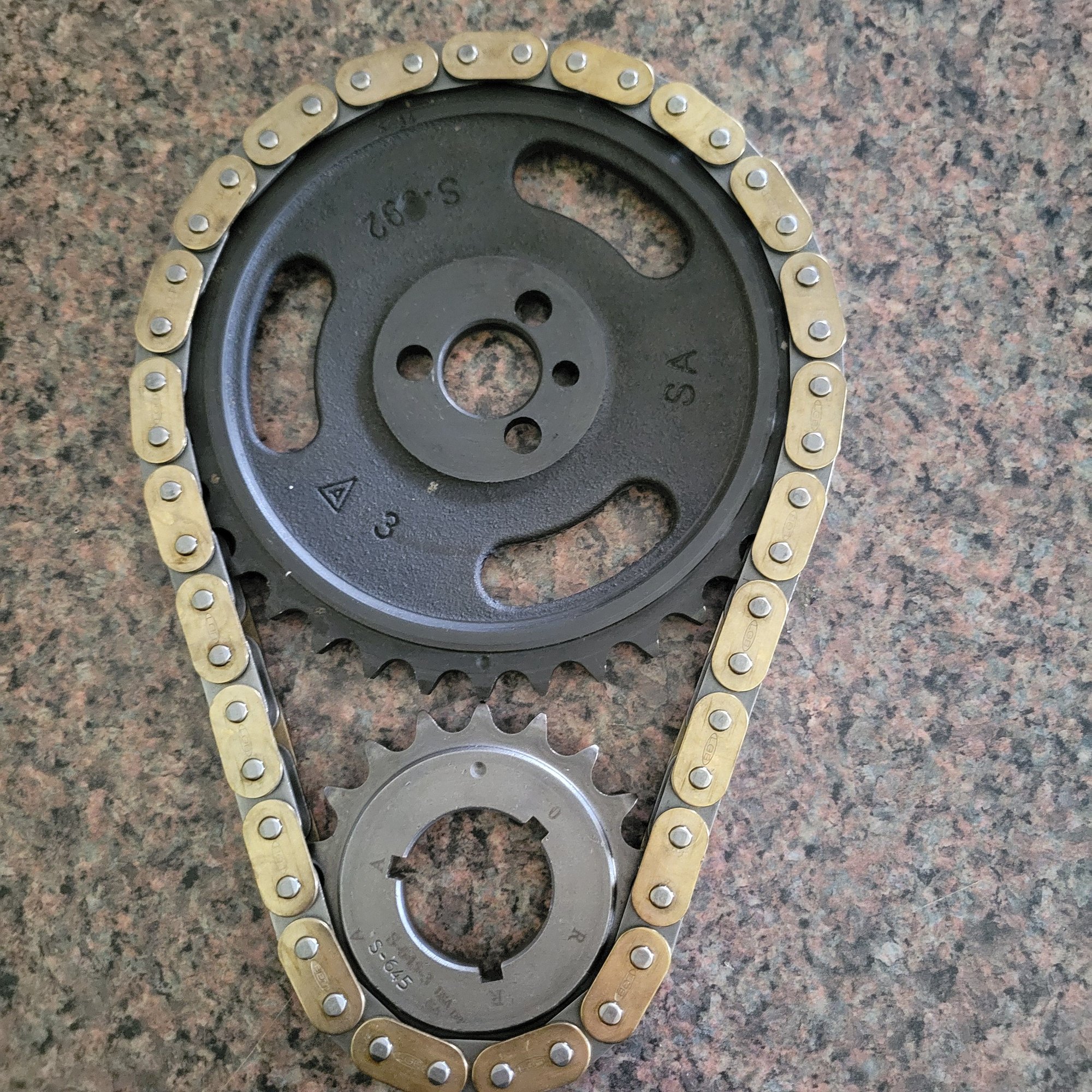

Is this the Cloyes part number you used?
Timing Chain
Old Mar 3, 2026 | 03:27 PM
Brown Bandit's Avatar
Brown Bandit
Joined: Aug 2023
Posts: 126
Likes: 22
Timing Chain
The first picture is of the timing chain that i had on that didnt last too long. The second picture is of the one that was loose from the start, when it was just put on.
Neither one is the top quality chain in the link I provided.

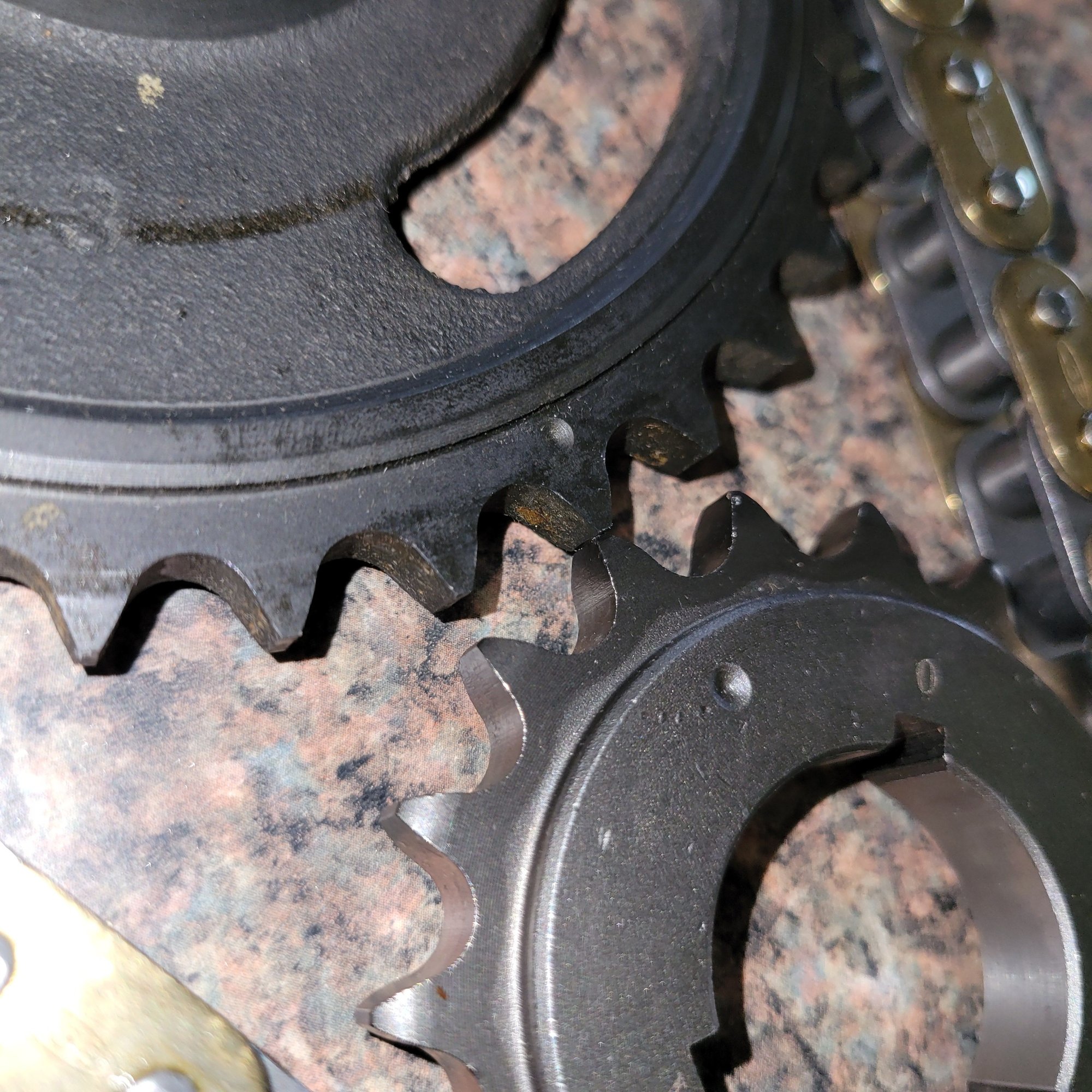

So ordered the Melling 40500 timing chain. Seems like a robust timing chain which is always good, but my concern is there is very minimal and i mean every minimal space between the camshaft gear
and crankshaft gear. Look at the pictures. Not even a 1/16" . You can barely see daylight between the 2 gears. Im thinking they are going to hit eachother when in the engine and rotating. Whats yalls opinion on this?
Old Mar 14, 2026 | 12:08 PM
MelWff's Avatar
MelWff
Posts: 18,782
Likes: 2,597
Did you check that with both gears bolted up to crank and cam?
