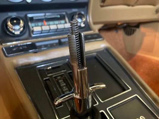

Before you get too far into this unscrew the shifter ball and see if the spring is sitting on top of the T-Handle. Sometimes people take it apart and put the spring in first and then the T-handle and then it doesn't work correctly. If that happened, you have to fish the spring out and it tends to fall to the bottom of the handle. A wire with a small hook on the end can help to get it out.
When you unscrew the ball, it should look like this.
