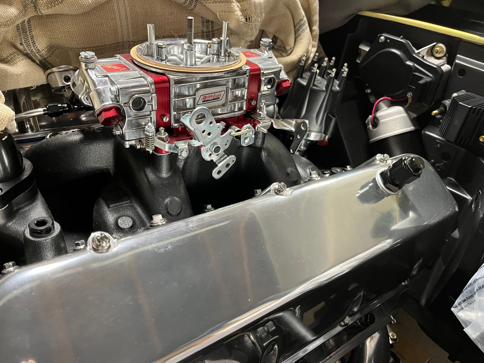

Putting 72, 350, 4 speed car back together after a resto mod rebuild. The 350 motor has a decent 585 lift cam, 109LSA. The aftermarket aluminum heads have no crossover for the choke so now I'm looking at rebuilding the "rebuilt" Quadrajet, adding an electric choke and making a lot of modifications just to get it work with this motor. The Quadrajet core that I have is not the best. I'm considering going with an EFI system and it looks like the ACES Fusion or Killshot 2 system may be a better choice over the carb for a little more money. Any one here using the ACES EFI system on a modified motor? Single plane or dual plane intake? The installation will not be an issue for me as I'm still in the process of putting the car back together. The motor has been ran and it's currently sitting on a run-stand. The original carb was terrible so I need to make a change in the fuel delivery area.

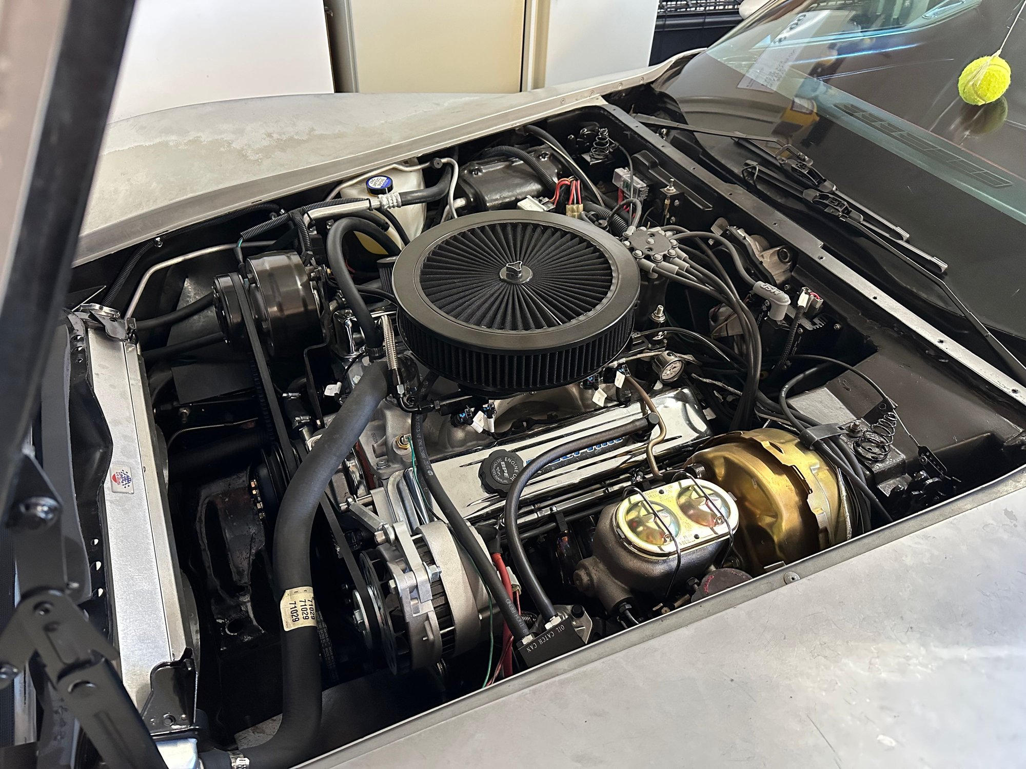

Aces EFI on my C3. Great system, went through the startup wizard and car fired up on the first crank of the key. Stay with carb if you don’t have basic understanding of engine concepts, electrical skills and/or have trouble reading instructions.
