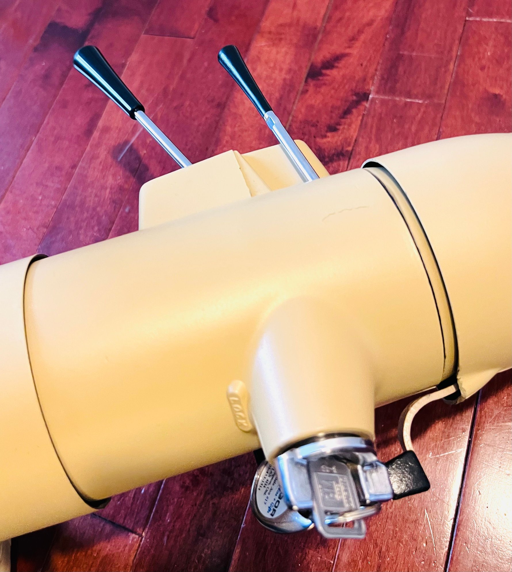

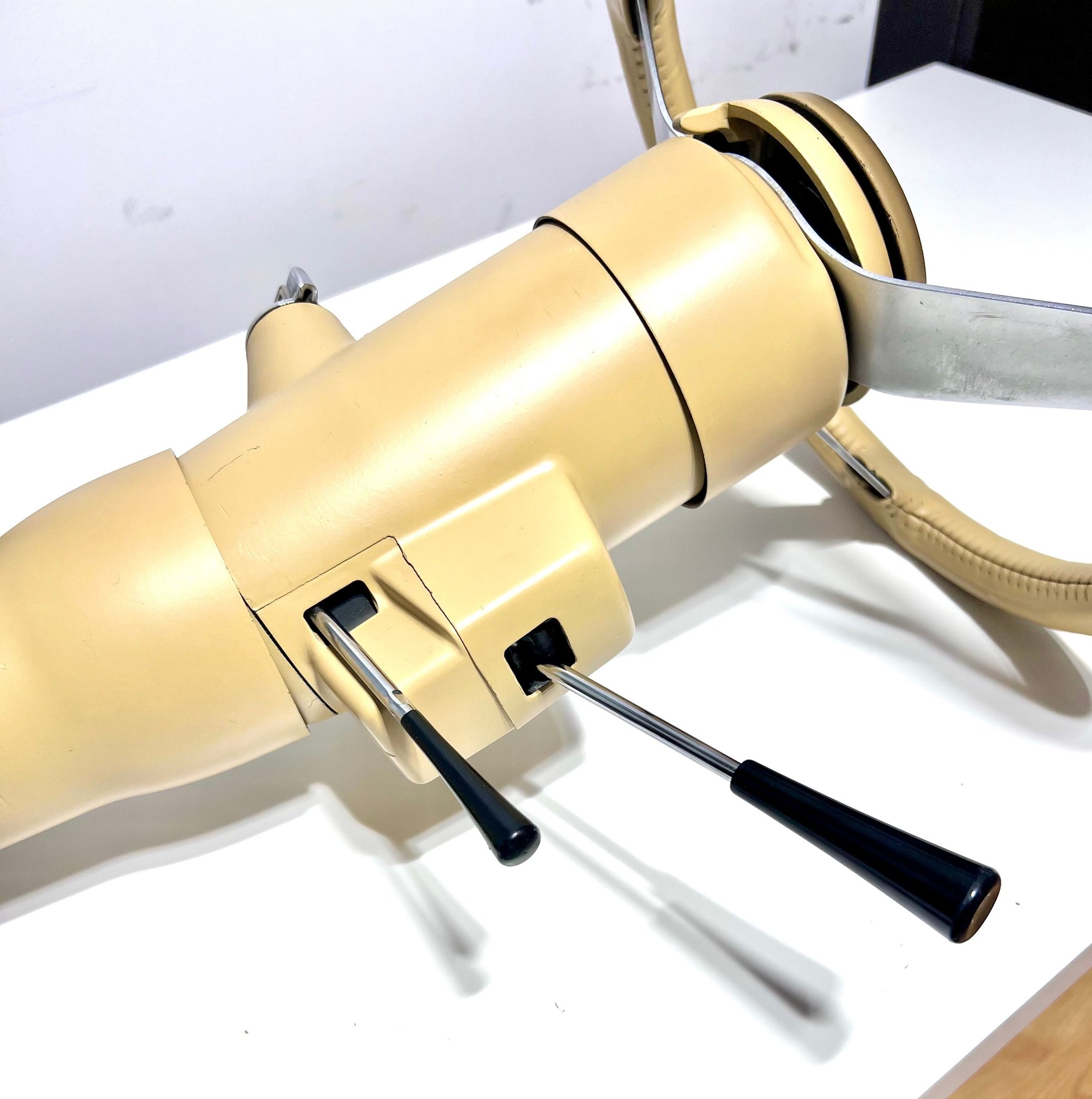

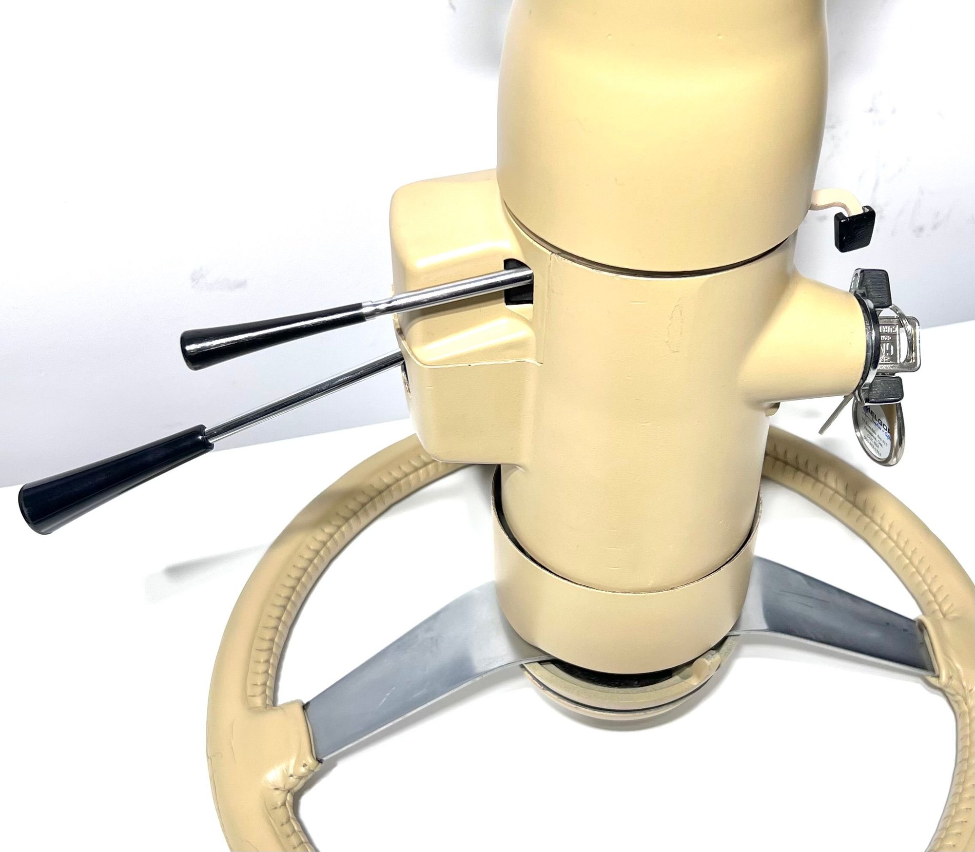

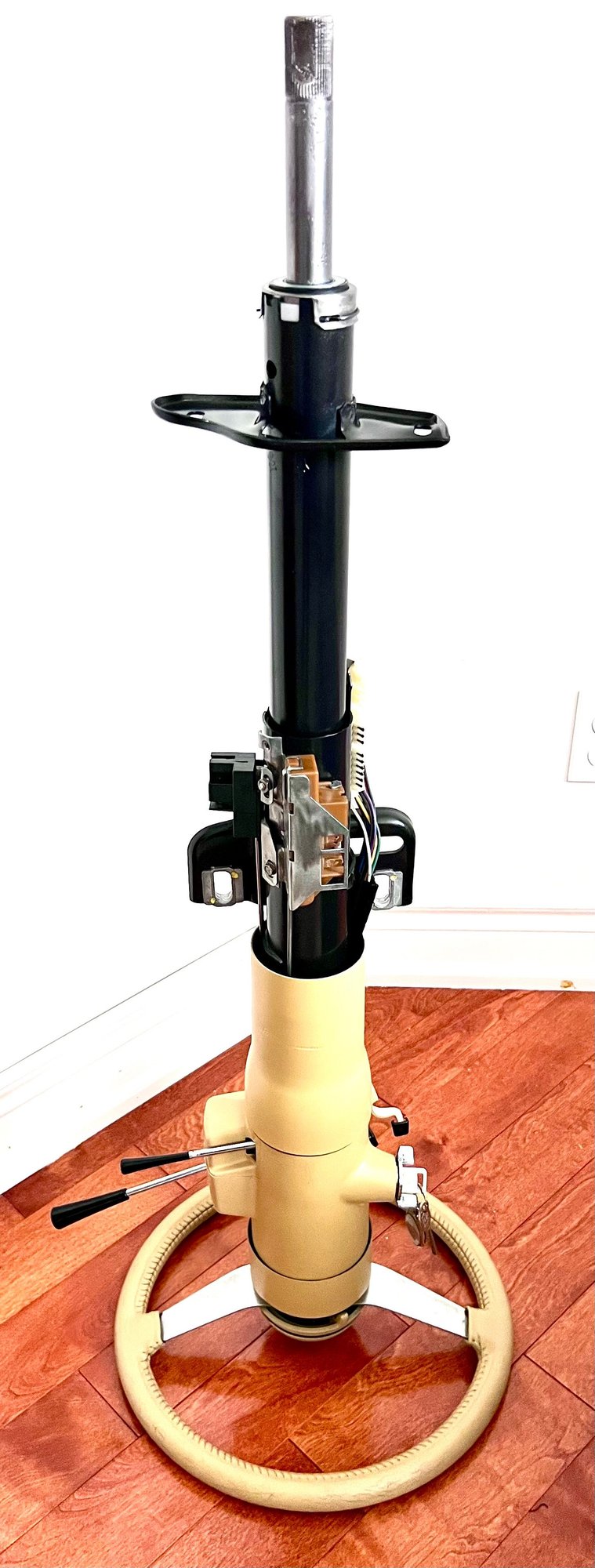

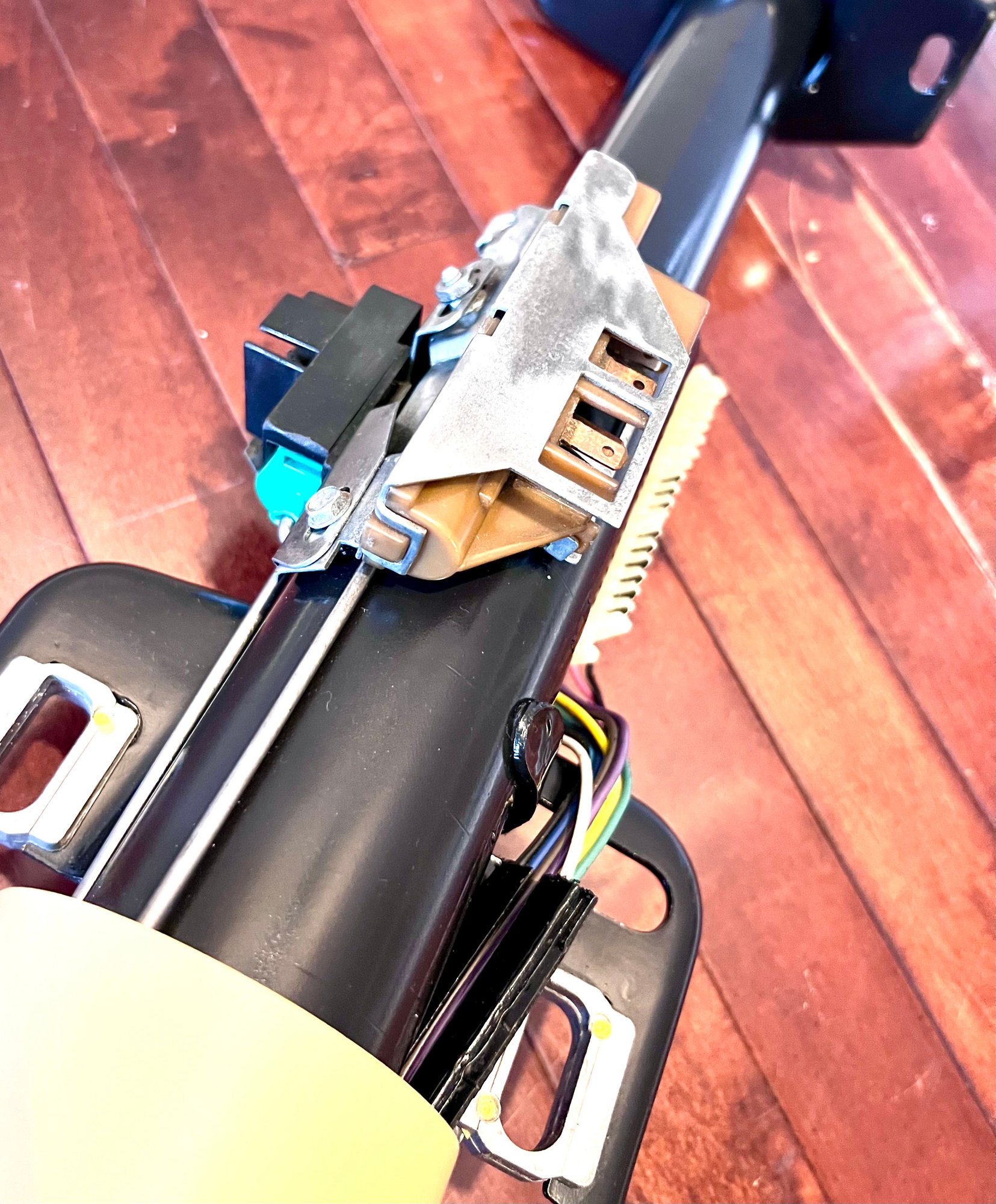

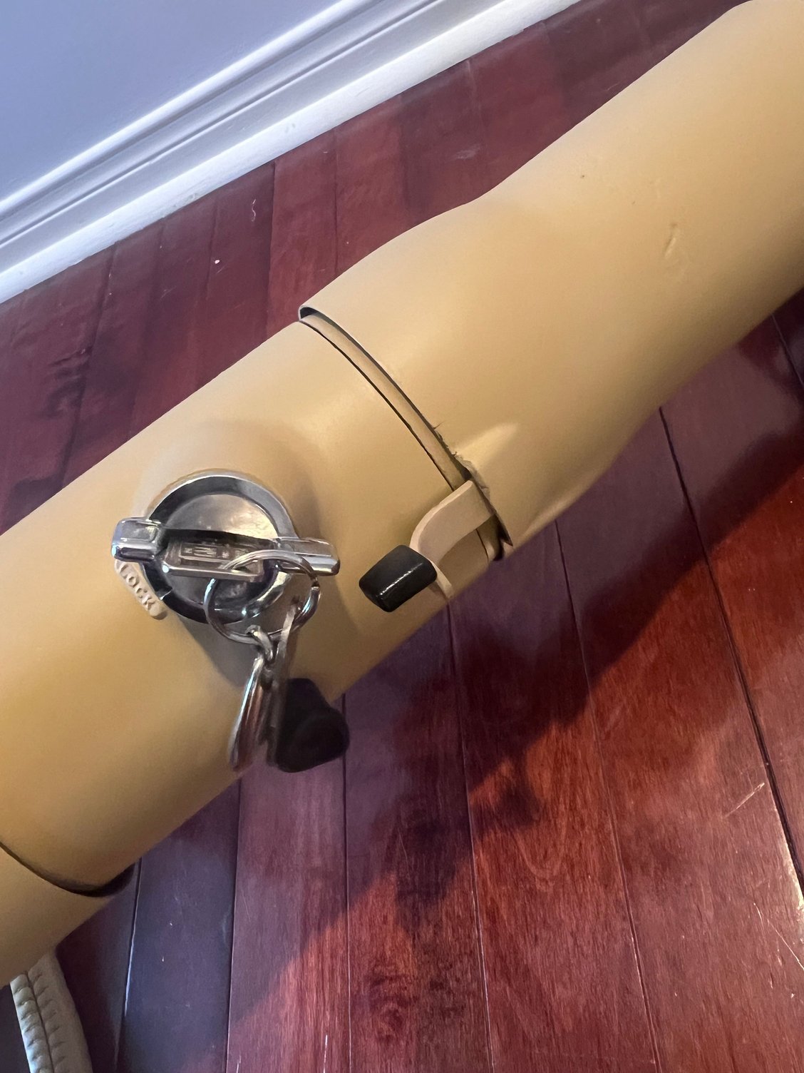

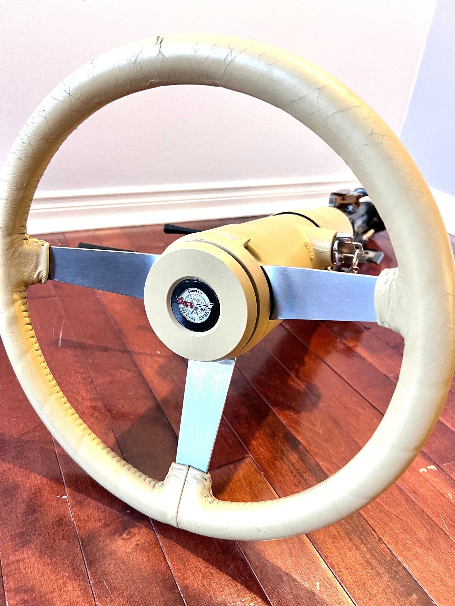

Done. Restored not Replaced except for the broken components. Still some patina on the wheel.
Blacks - Cerakote E Series
Metal - Clear Cerakote Air Dry
Doeskin - CA Doeskin Dye from Top Flight
Duplicator - Dye Primer / Contact Adhesion
Lots of blasting, Wire Wheel, and re greasing. Set up with Jim Shea Papers

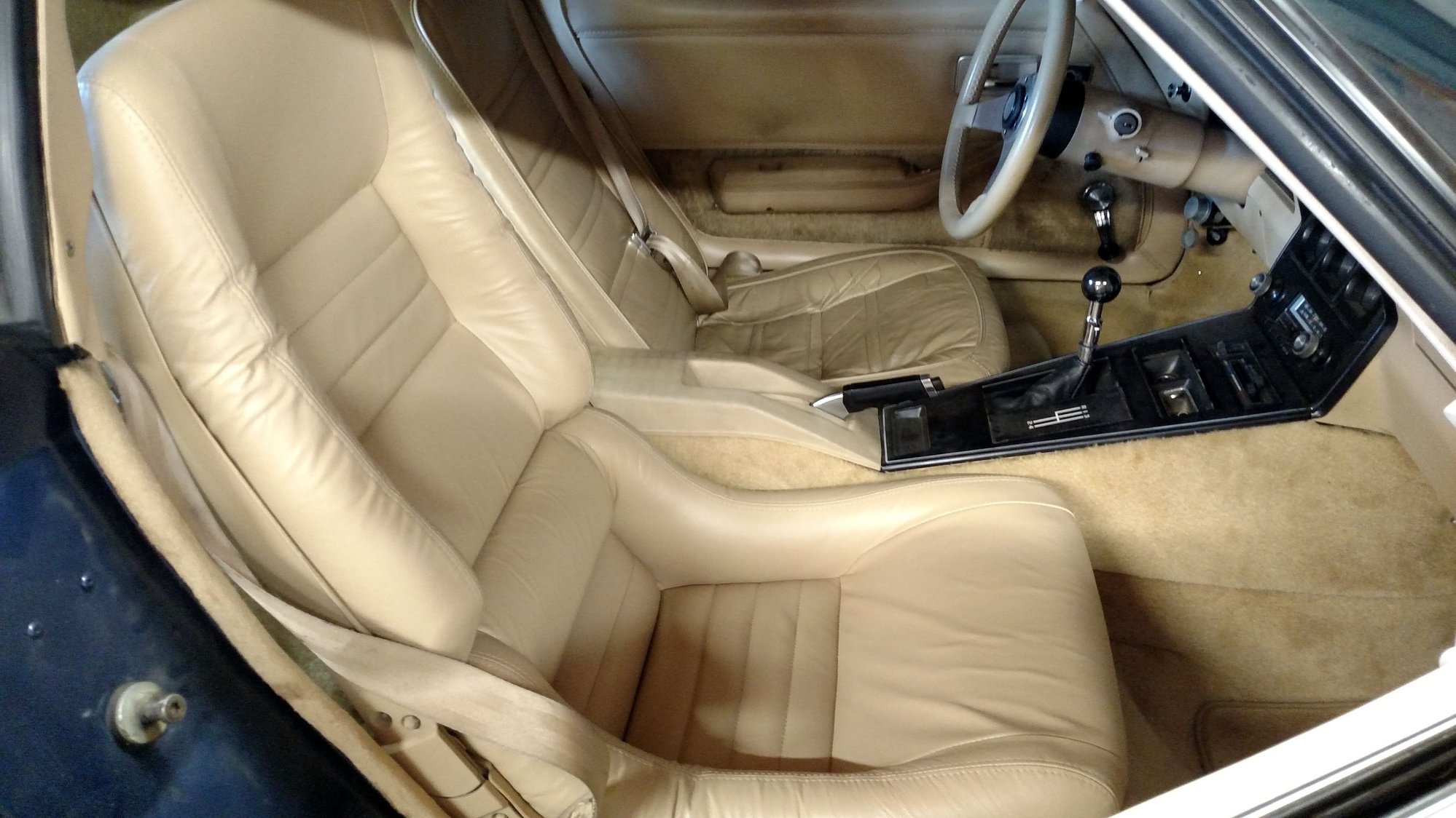

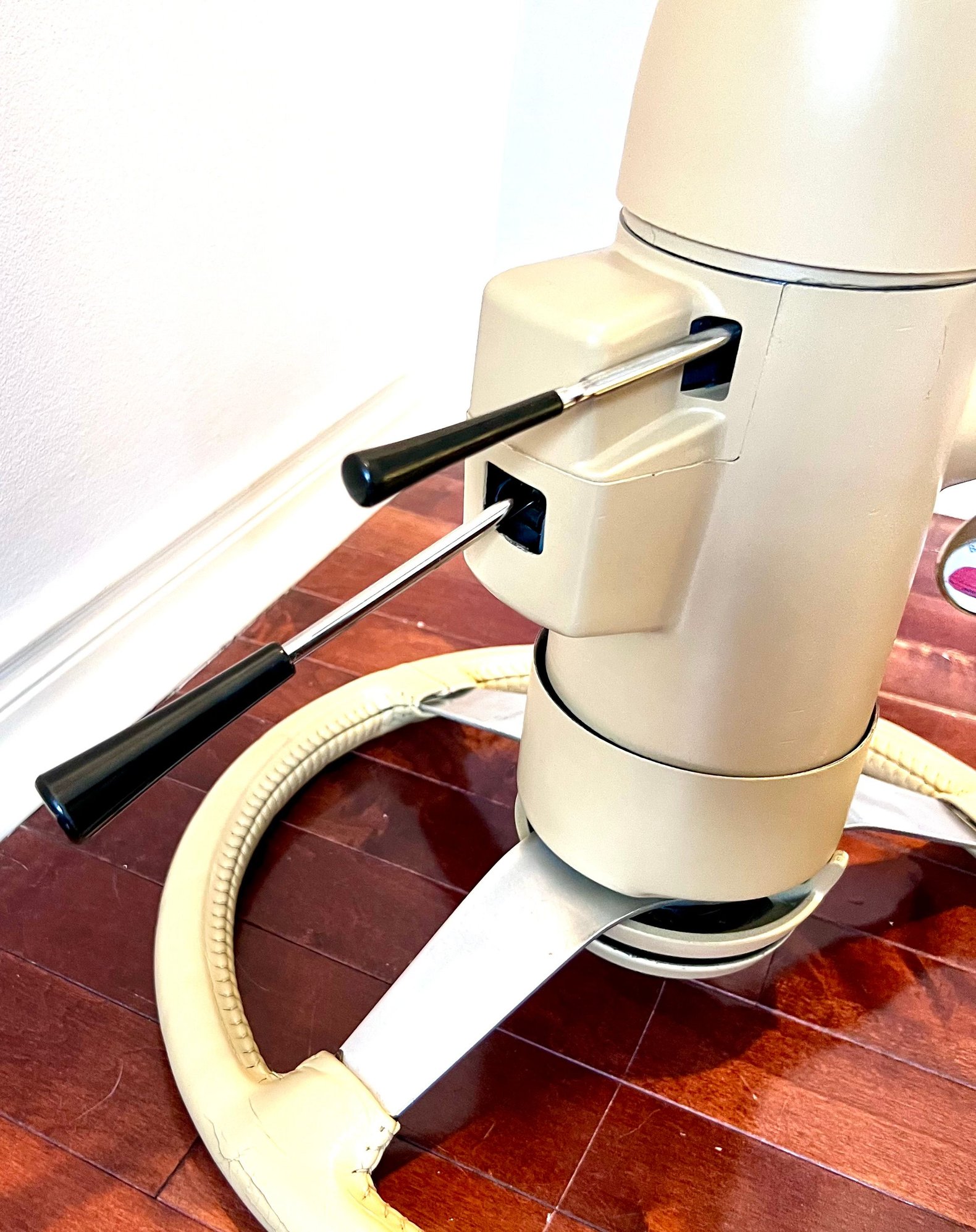

My 78 OEM Steering column in picture below when I was switching the OEM 78 Seats to 1980 seats that I restored with new cushions after securing the 80 seat frames for little money.
