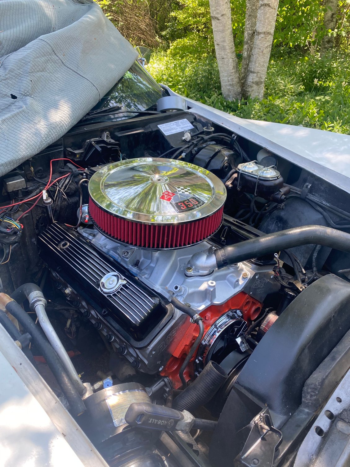

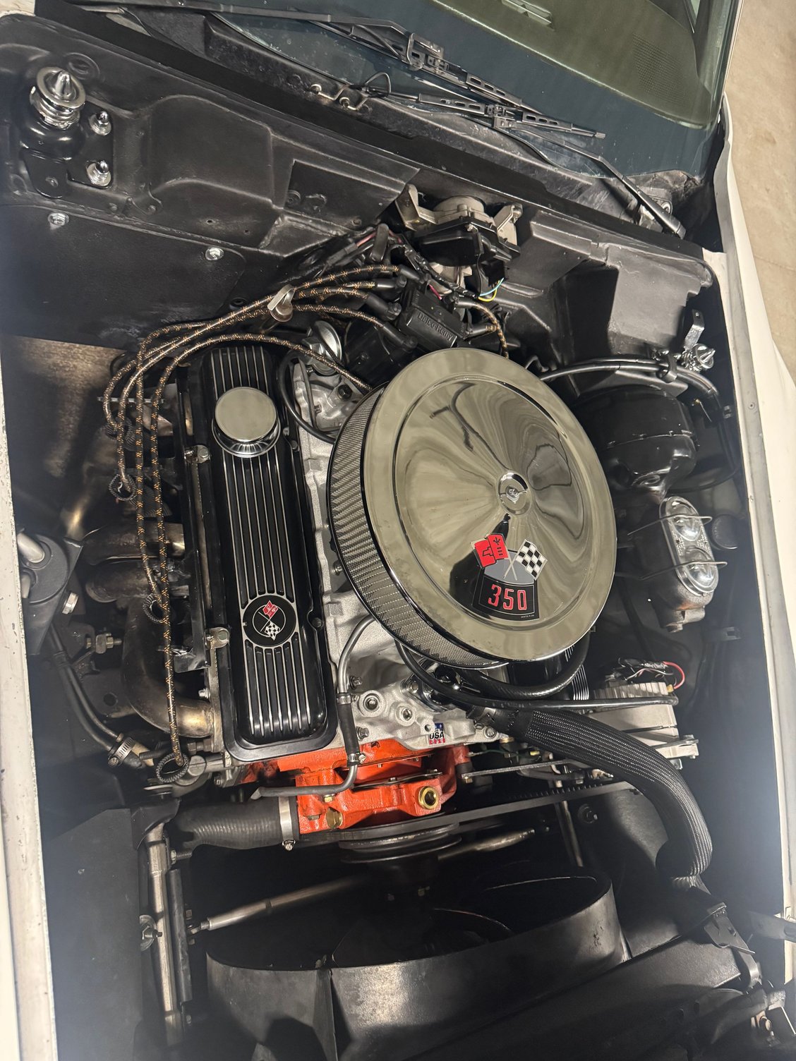

Nice looking engine. What type of headers did you use? How was the fitment? Do you have straight or angle plug heads? Finally, How is the performance improvement over stock engine? Have a GREAT day! Pappy
PS>. my vette is a 1973 L-82 4spd, 3:55 rear, edelbrock 2101 intake, 1406 600 cfm carb, and electronic ignition.
Old Mar 16, 2026 | 08:45 AM
Piersonpie's Avatar
Piersonpie
Joined: Apr 2021
Posts: 2,751
Likes: 2,193
From: Minnesota
Thanks, here’s how it looks now.
I have Doug’s stainless steel headers and side pipes. The heads are straight plug and have no fitment issues. The first picture has a 2101 intake, but the second is a 2601 air gap. Works well with the factory 800 CFM Quadrajet.
Despite starting with an L48 and still having a 3.08 rear end I’m very satisfied with the performance, a huge difference over stock. Although it’s a bit of a stopgap while I’m building a whole new powertrain from scratch.
