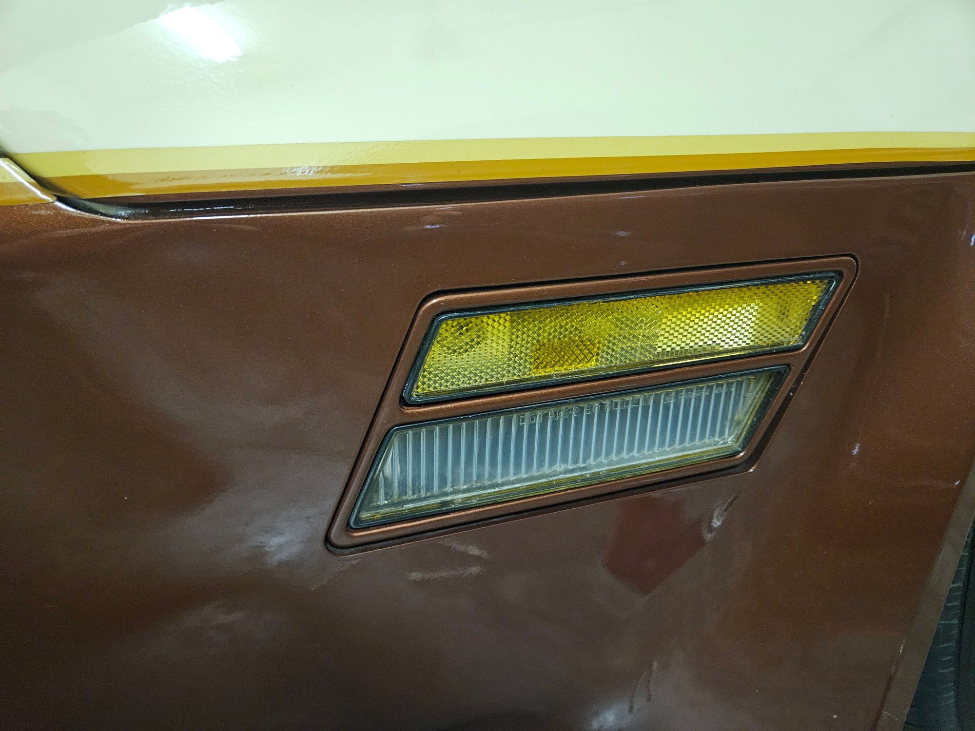

Greetings everyone! The white cornering lights below the amber turn signal flashers have stopped working on both sides on my C3. They worked fine up until about a week ago. I pulled the bulbs and they look fine, but just as an extra check I installed other bulbs that I know work and they did not come on when the turn signals were activated. All signal flashers on the front and rear work fine when activated with the hazard switch, however when using the turn signal stalk, they do come on but flash rapidly. That tells me the current is higher causing the rapid flashing because the car thinks those cornering light bulbs are burned out, but they are not. If the fuse was blown I would expect none of the turn signals to work, so I don't believe that is the issue. Is there another relay or part that regulates the cornering lights with the turn signals? I am thinking maybe the flasher unit or the flasher in the fuse box, but is it possible for either of those to malfunction to where the flashers work and the cornering lights do not come on? Thank you in advance for any guidance and suggestions.

Thanks for the 1980 wiring diagram, that is big help. The corner marker lights and the 1157 directional/parking lamps and wiring are pretty much the same as my 73 and probably most (if not all) C3's. Those cornering lights is where we part. Anyway, the cornering lights have their own circuit. The driver side feed is orange and the pass side feed is black/white wire. There is no other relay or other component for the cornering lights function, they are fed 12V directly from the directional switch. Now the cornering lamp switch in the steering column has its own 12V feed from the headlight switch via a brown wire. You can probably get to that connector along the steering column but I dont know 1980 C3's so someone more familiar with this car can tell you where to find that connector. One thing I cant tell from the diagram is if that brown wire feeds 12V to the cornering circuit when the headlight switch is on, off or both. I would start there, at that connector. Look for the brown, orange, black/white wires. The diagram is not clear on the switch function but I suspect the cornering lights come on only when the light switch is on. Knowing that would be helpful in going to the next steps.

The brown wire provides power to the cornering lamp switch, so the cornering circuit will only work when the parking lights (at least) are on. The cornering lamp switch is part of the turn signal switch in the steering column. A good first step would be to test for power in the harmonica connector. The cornering circuit shares the black ground with the front harness, and gets power from the black/white wire (Starboard) and orange wire (Port). Check those at the harmonica.
Since this suddenly changed, it is likely that your cornering lamp switch has failed, or it isn't getting power from the brown wire.
