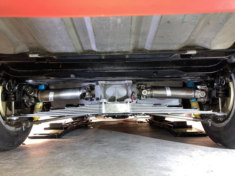

Wonder why it says this in description?
  • Ideal for all C2 and C3 cars under 400 hp
  • Recommend QA-1 non adjustable shocks to compliment spring and ride quality
op, i have no experience with plastic spring to compare.
u can go steel and do an L82 spring. Much lighter than standard spring. I went bilsteins . Next time i would try qa shocks. Also bilstein mexico made now. Thread here on spring. If you do any spirited driving i would lean stiffer. Also the length is shorter on bllsteins rear on mine so travel more limited. No clue if thats good or bad. My car rides great
good luck and let all know how you made out!
https://www.corvetteforum.com/forums...af-spring.html

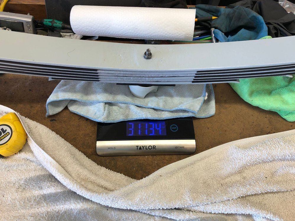

just more options if you want to stay steel. The L82 spring is much lighter than the non L82 spring, ~30 pounds.
I weighted my gymkhana Sport 7 leaf spring when I took it off in 1985......50lbs....it was still very heavy versus the composite.
6 leaf originally..7 replacement
That spring is certainly much lighter than my OEM 78 Gymkhana spring 7 leaf steel spring and looks much different in terms of the metal leafs. Is that spring ^^^^^^^^^ an OEM Gymkhana Sport rear spring originally on the car, for sure, from the factory? The base suspension cars had a 9 leaf GM steel spring from the factory.
I did find this comment searching weights for the C3 steel rear springs:
Technical Note: While the 7-leaf "Sport" spring has fewer leaves, they are significantly thicker and made of a higher-grade heat-treated steel to achieve the higher spring rate. This extra thickness per leaf results in a total weight that is nearly identical to the 9-leaf standard spring."

i went with this spring..
https://www.moog-suspension-parts.com/moog-5762 474# rate. not too harsh IMO. a bargain below 100 bucks
threads below if helpful.
https://www.corvetteforum.com/forums...-for-79-a.html
all front end. make sure hole lines up top. much easier to install with shorter spring.
https://www.corvetteforum.com/forums...rs-method.html
