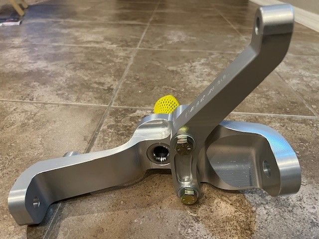

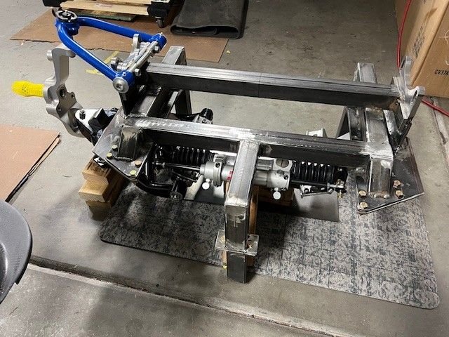

I picked up a pair of Van Steel's C-3 spindles and hubs. They are of superb quality. I am using them for a new front suspension I am building for my 1960 Corvette race car.
Van Steel billet upright/spindle
Suspension in fixture replicating frame dimensions
