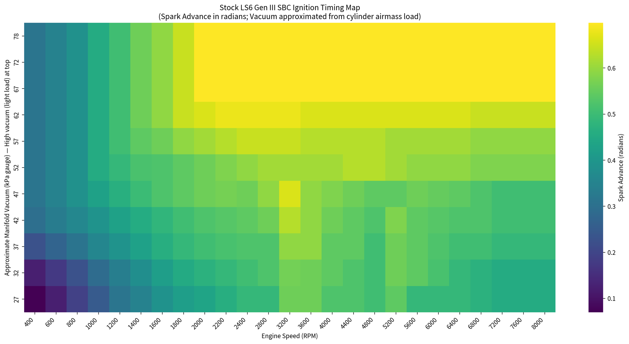

If you aren't using kPa and radians, you're doing timing wrong.
To high rpm miss
