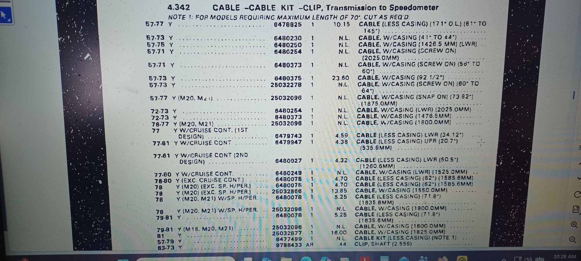

I'm looking to replace my speedo cable on my 200-4R trans.Does anyone have a part # because I know they come in different lengths.I found that out when I originally bought one,to long. Unfortunately I didnt keep the part# of the one that fit. Thanks

They dont list the length of the cable only mdl of GM vehicle and models have different lengths.Corvette is not one of those thats why I need a part#

Old Mar 26, 2026 | 11:39 AM

PIONEER also has LOTSA cables
a few hundred pages of just speedo & tach cables
https://pioneerautoinc.com/pioneer-a...es_catalog.pdf
same cat also has Corvette auto trans Shift Cables.
*** there's nearly two full pages of CORVETTE speedo cables AND Length is shown for each one.
