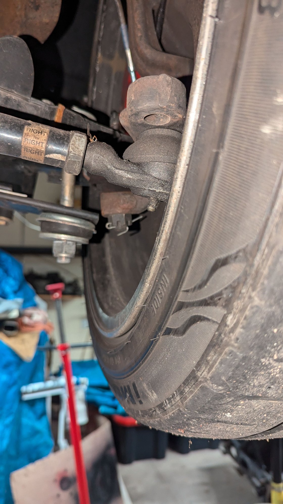

Just info. With that wide of a wheel the front steering arm and tie rod end will be inside the wheel hoop and the same for the rear spring bolt. Clearance issues. JP

Not 19s but I currently run 18x10.5s on my stock body 82 with 275/40 tires all around. -11mm (-.43") offset, which is 135mm (5.32") back space.
The rears you'll just have to relocate the parking brake cable bracket on the trailing arm.
The fronts work but rub at full lock in various places. I also had to trim the inside of the fender lip so the tire could clear when tucked. Both of these have more to do with tire width and diameter than rim width. I could probably alleviate 99% of these fit problems by going to a shorter 275/35 even with the 10.5 wide rims.
