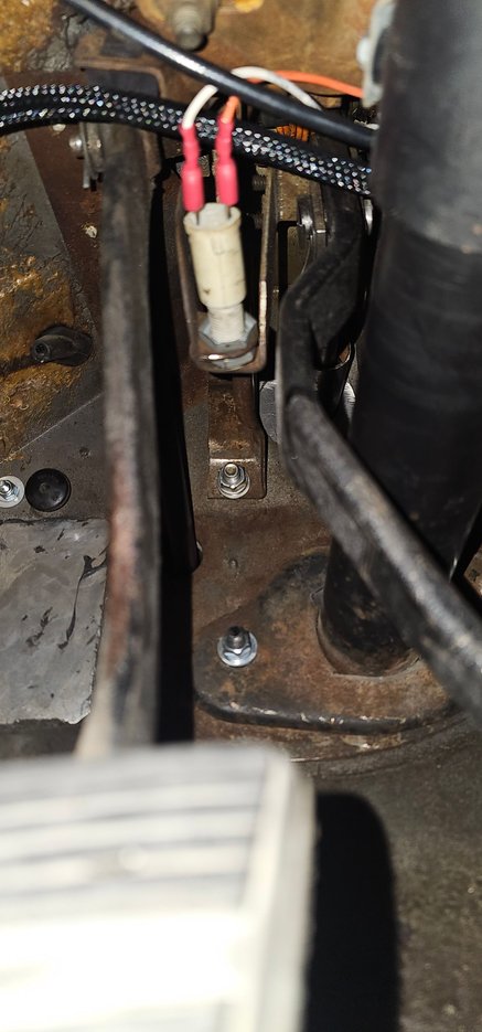

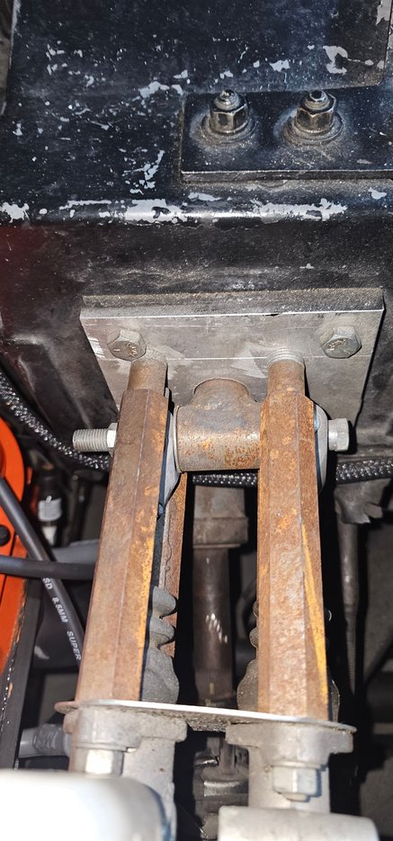

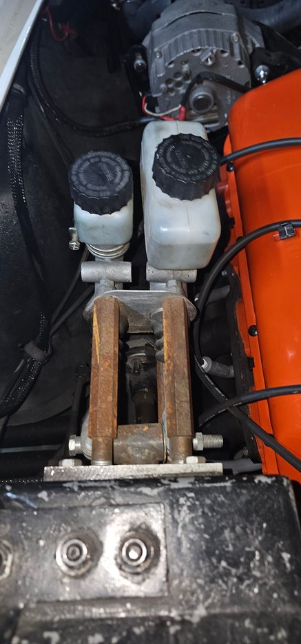

Been a long time since I've been on this forum, but I'm back. I have now a 1974 coupe that is an Historic Road Racing car, built to resemble what a 1974 Corvette might have looked like if it were run by an amateur like me . My question is regarding the J50/J56 braking options. The category of road racing the car is built for (called Group S here in Australia) only permits factory fitted braking componentry, meaning I need to use the stock brake calipers and disc size. We are permitted to use drilled/slotted rotors, and also to put tandem master cylinders on. The previous owner installed the pictured tandem master cylinder, and removed the booster, but the braking performance is woeful at best; I couldn't lock the wheels if I tried.
Given the car is a historic racing car and supposed to be a representation of cars of the period, and I am enthusiastic about keeping things as period as possible, I want to change the car so that it has all the components of a car fitted with the J56 option. I have done some research on here and found a lot of useful information about the J56 option, specifically the calipers with the dual pin pad locking system, as well as a different proportioning valve arrangement, but cannot really find a definitive list of what would be fitted? I will most likely going to buy the parts needed to make the current calipers suitable for J56 pads (machine off the standard retaining boss and drill the pin holes, and replace the pistons with titanium), and am happy to run parts available on models earlier, such as a 1969 L88.
I also am seeking advice on whether or not everyone thnks I should fit the J50 power brake option back to the car. Does anyone have any advice on what would have been most likely in period, most specifically what an L88 would have campaigned at LeMans or Daytona? Would they have run power brakes?
Thanks in advance.

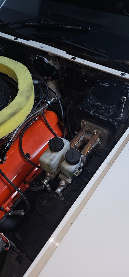

Are the dual master cylinders sized correctly for the system?
From what I've read on this forum the factory manual brakes are sufficient on these cars, if your calipers and rotors are stock but the master cylinder(s) aren't I would look into that as well.

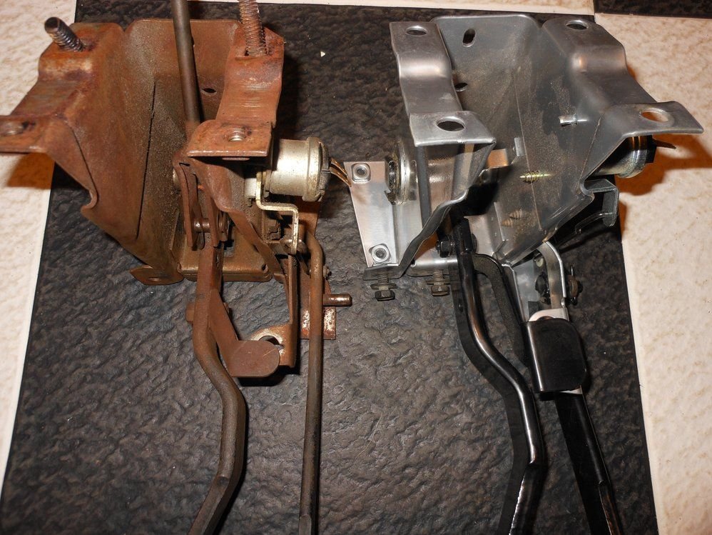

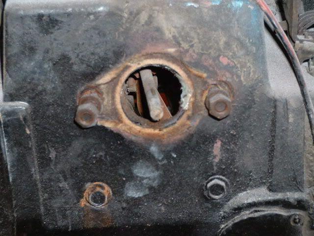

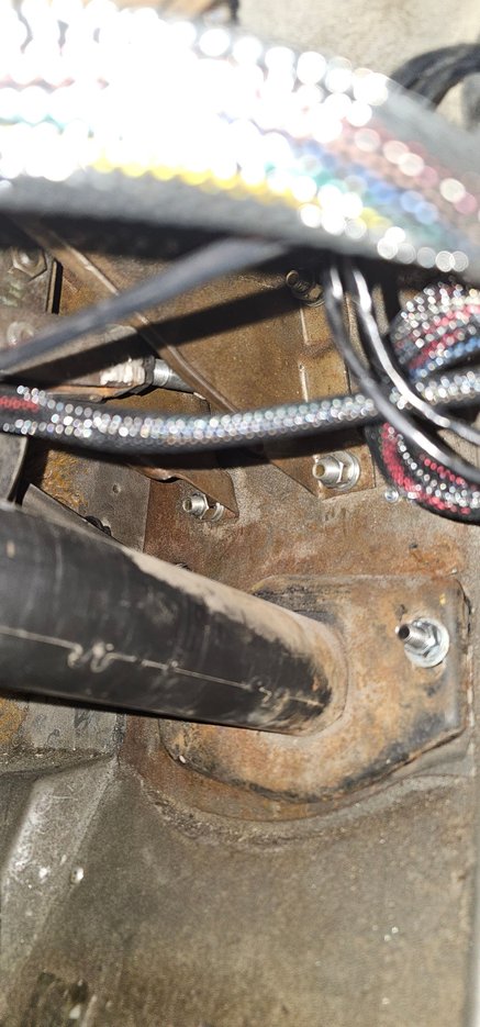

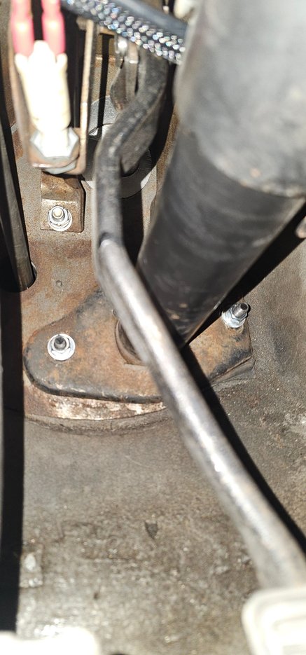

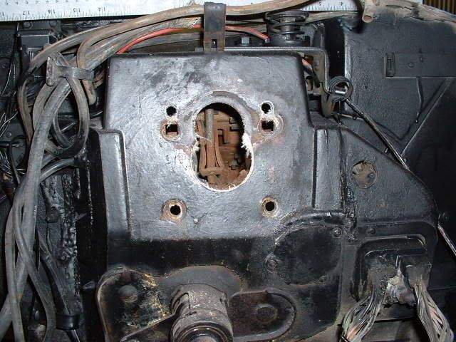

Something I remembered reading in one of the build threads here regarding converting a power brake car to a manual brake car.
The factory manual brake cars have a different horizontal center line for the master cylinder, I believe it's raised, to give more leverage from the pedal.

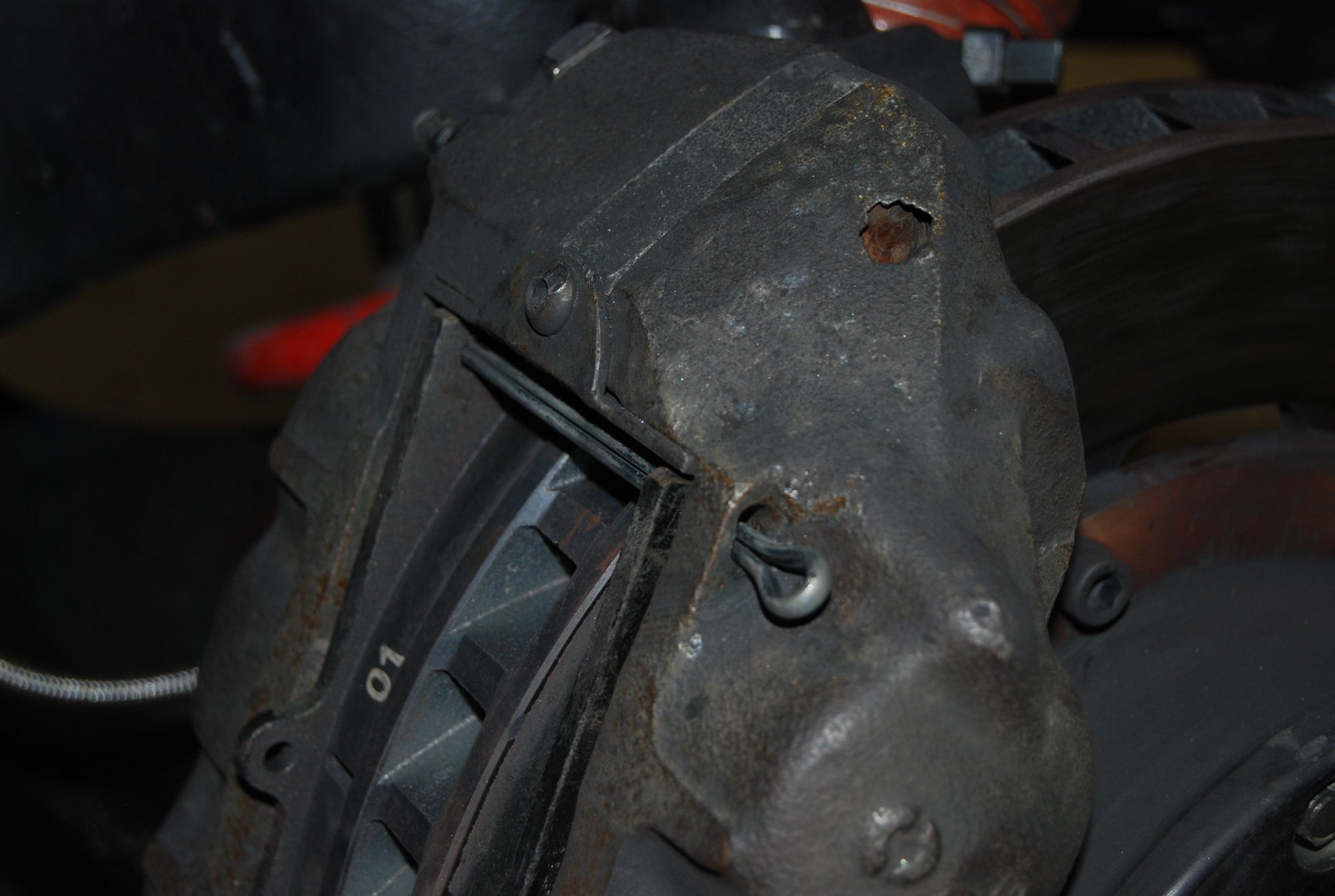

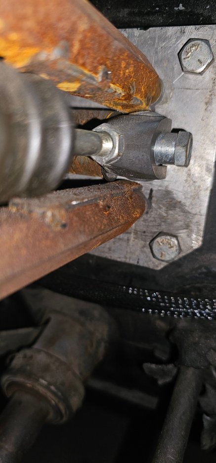

Here’s a good picture of the reinforcing brackets (disregard the caliper). Lonestar Caliper sells both an aluminum version and the original cast ones. Be aware that there are “small hole” versions and “large hole” versions and there are some dubious repops available as well.
The backing plates of the original J-56 pads were made from Inconel. These can be distinguished from steel repops as the Inconel ones are non-magnetic. Porterfield Brake will reline them with several pad material options.
Regarding the pistons, my understanding is the J56 factory pistons are aluminum with a phenolic insulator. There are differences between the 1st design calipers and the later ones.

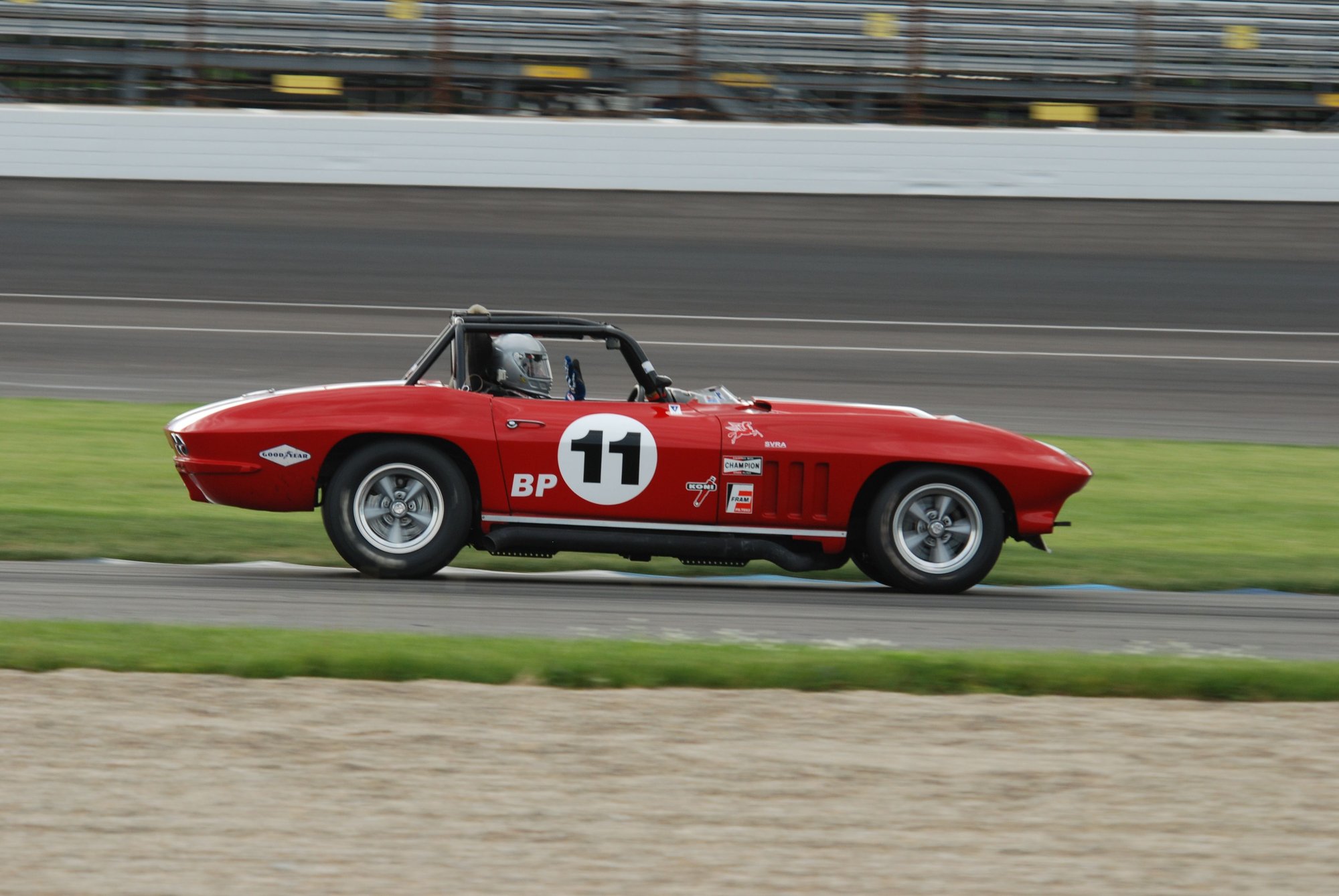

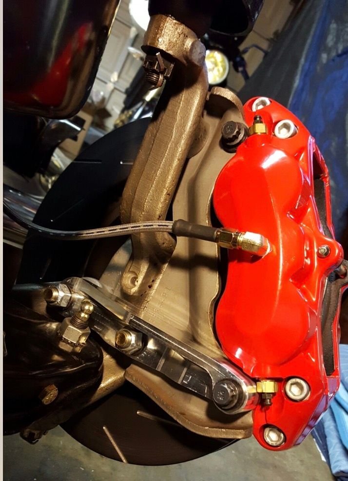

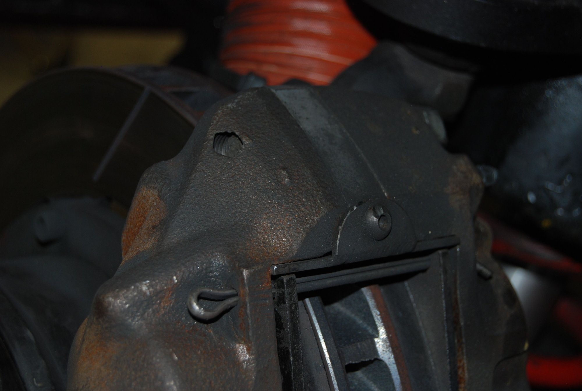

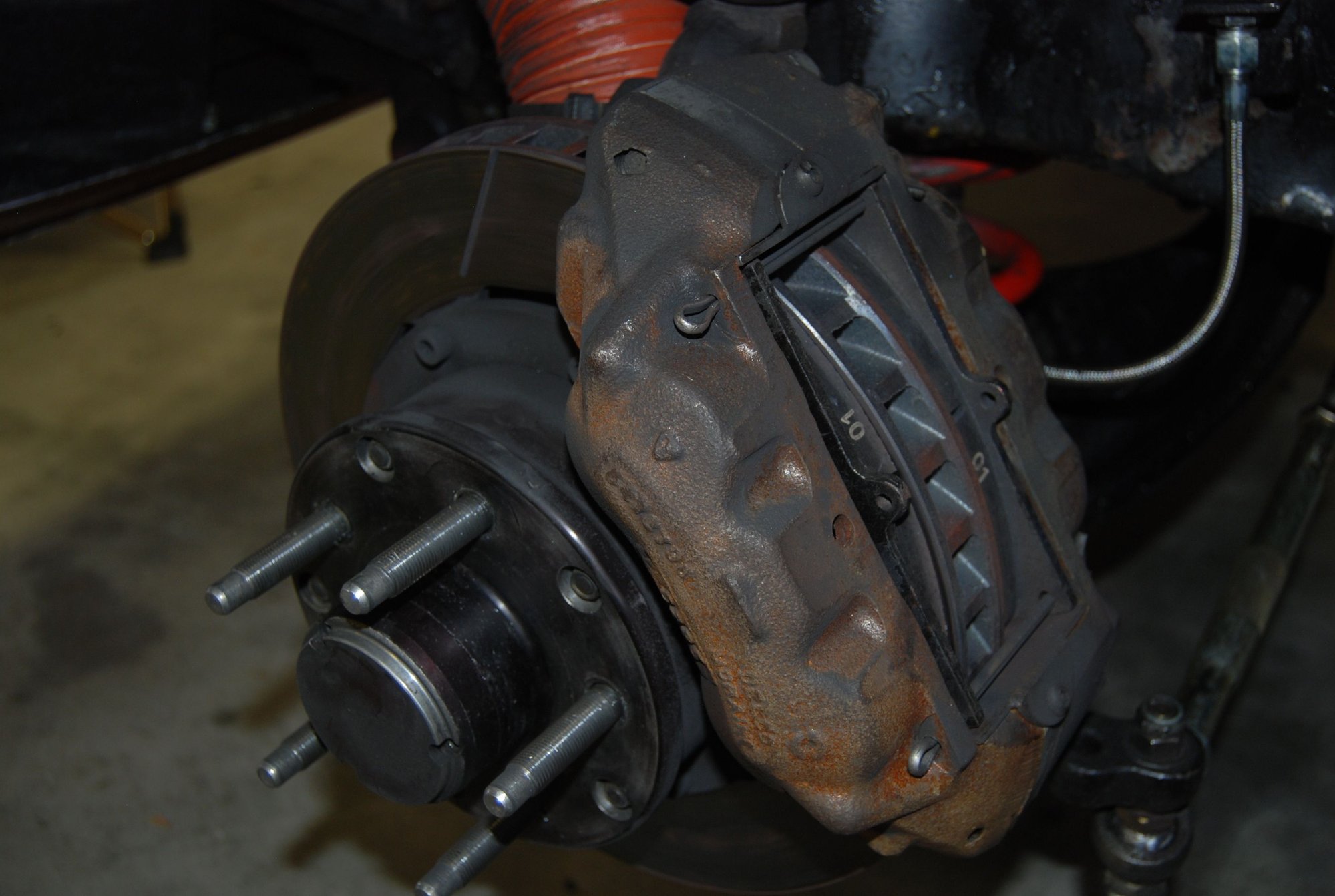

Below is one of the Corvette vintage racers I crew on. In the US, most vintage organizations are based around the SCCA (Sports Car Club of America) GCR (General Competition Rules) from certain eras or periods. Most 60's and early 70's Corvettes, Camaros, Mustangs, Jags, Shelby's, etc have to conform to the 1972 SCCA GCR, and one stipulation is that we have to run stock cast iron calipers. Rotors and cooling ducts are free. We run stock Delco calipers with a spacer installed between the haves of the front calipers to improve cooling and to allow for more pad. We've also modified the stock mounting brackets to relocate the calipers to the trailing side (rear) of the rotor. This transfers some weight more toward the center of the car, but also makes it easier to direct cooling air from the hoses to the center of the rotor. We are also using the J56 bracket stiffeners. Under the rules the master cylinder isn't specified, but we run a stock Delco dual reservoir master cylinder without a booster while some others we race with are using racing master cylinders. Our rear calipers are stock without the spacers or cooling ducts and we've gotten away from drilled rotors, we're using slotted rotors at all four corners now. We found that drilled rotors can develop heat cracks around the drilled holes. The brake set up on the red 65 below has been sufficient to repeatedly stop the car from over 140 on the long main straight at Watkins Glen and from over 165 on the banking at Daytona Speedway.
J56 calipers are mainly stock Delco calipers with the top bosses milled off and the two pin mounting holes drilled in the calipers. The two pins help keep the pads from moving around, but the main advantage to the J56 calipers were the insulated pistons. Besides the calipers, J56 also included a proportioning valve and the bracket stiffeners. While the standard master cylinder used on 67 Corvettes had a 1" cylinder bore the 67 J56 cars came with a 1 1/8" bore, the same as 68 up power brake Corvettes.
Here in the US, the SVRA (Sportscar Vintage Racing Association) is largest vintage organization. Corvettes built after 1972 race in SVRA Group 10, which allows for a lot more in the way of modifications. Brakes are free in Group 10, but Group 10 is a tough glass to race a full frame Corvette in because it includes tube frame/fiberglass body silhouette racers (80's Trans Am & IMSA GTO Camaros, Mustangs, Merkurs, etc) NASCAR stock cars (and trucks through the early 2000's0, Porsche 930, 924 GTR, 944 Turbo, and so on, FIA Group 4 & 5 cars and others. Fortunately some of the smaller and regional vintage organizations do allow Corvettes, Camaros etc through about 1979 to compete as long as they comply with the rules in the 1972 SCCA GCR.
Here are a couple pictures of our relocated front calipers and the spacers we use in them.

I think you're right. I know I sold a couple sets of those on here back when I could get them. The aluminum ones wouldn't pass for OEM, but they worked just as well as the real ones and cost less. Original ones are running anywhere from $800-$1800 a pair these days.
I guess I should have mentioned above that there are two different sets of J56 stiffening brackets, 65-68 and 69-75. The 65-68's are casting numbers 3882783 (LH) & 3882784 (RH), and casting numbers 3948879 (LH) & 3948880 (RH) are 69-75's. The difference between the two sets is mainly the size holes, if my fading memory is working properly two of the three holes are smaller on the earlier brackets? The 65-68's are a little harder to find too.
I also just noticed that I mistakenly said 70 up power brake master cylinders were 1 1/8" bore, but it's actually 68 up, and I've corrected it.

@69ttop502 I followed the standard orientation for the steering knuckle to spindle. Bolt heads on the wheel side. Longer bolts of course.

I don't think they are sized correctly, to be honest. Something that seems to affect a lot of historic racers over here in Australia is the 'monkey see, monkey do' attitude. There are also a lot of modifications made 'because everyone said I should'. Given the state of the car when I bought it (half the spark plugs were loose for starters), most likely the previous owner just bought a set of master cylinders and then had them fitted, with no regard to bore size etc.

THe power to non power brake conversion is something I did on my car. The pedal boxes were slightly different and I opted to switch pedal boxes to the manual box but it is not required. The brake pedal has two different holes in it for mounting the pushrod with the higher hole being for manual brakes so you should have that. Just need a manual brake stoplight switch arm and a pushrod. The pic below shows the difference in the firewall mounting and pedal boxes. Manual pedal box on the left in first picture. You can kind of see that it has welded nuts on the bottom mounts. The bottom holes in both pedal boxes are in the same location. The firewall reinforcement is the same, just might need to fill in some fiberglass as the manual master doesn't quite cover where the hole was enlarged for power.

The stiffeners I'm familiar with have come from two US sources. The cast iron ones I was told were a stock pile of original 69-75 GM castings found at either GM or the foundry that cast them for GM. These were supposedly new original castings that had never been drilled. These were acquired and were being drilled as needed. I can't provide any proof to you that this story is true, but it is the story I was told 10-15 years ago when the cast ones turned up. The aluminum ones were being machined by someone here in the US, but I understand he's stopped making them. At least I know I haven't been able to get any for a few years now.
If my quickly fading memory is correct, Jim's been using Hawk pads on the red Corvette above, and all his other Corvette and Camaro race cars too. Next time I talk to him (which is somewhat regularly) I'll ask what pads he's using and their part number(s) and post them here or PM them to you.
The red 65 above of is using pistons that were developed by a gentleman from Massachusetts (US) with input from Lonestar Caliper, at least that's what I know were previously being used in it. I live about 3 hours from Jim, the owner/builder/driver of the car and usually only work on it at race tracks, but to my knowledge we're still using those pistons. You could email Ken at Lonestar (he's Lonestar's owner) and ask him about the pistons. Tell him you were looking for information about the caliper pistons developed by the man in Massachusetts and used by Jim Glass in his race car. Ken should also have some of the stiffening brackets too, I'm sure he at least has the cast iron ones. His email is ken@lonestarcaliper.com
Great photos mate, thanks a bunch. Is there any way to know exactly where to drill the holes for master mounting, or does it sort of become apparent when apart, and the rod in the correct hole? Further to this, I am assuming the holes are one above the other, so which would be for the manual brakes? Also, Leigh mentions moving the clutch pivot bolt as well? Can you confirm this?
Originally Posted by 69L88
I’m not aware of anyone selling new J56 pads (there is one company selling something as advertised but they are clearly not something I would buy as the pads are riveted and the source is most likely from a certain country on the western side of the Pacific).
The backing plates come up from time to time on this forum (and eBay) but caution is advised as the true Inconel material plates are rare. Porterfield Racing Brakes in California will reline them (I just had mine done).
I think my best bet is finding a set of backing plates and having Porterfield Racing Brakes put some new lining on them.
Here if the old rule books didn't allow a modification back them, we're not allowed to make it now. We're not even allowed to use Wilwood's D8-4 Corvette replacement calipers because they're aluminum, not cast iron (there is one race organization here that allows the Wilwood's, and other organizations will usually make a one time exception if an entrant with Wilwood"s isn't a regular participant).
There are a some exceptions allowed for brake upgrades in some of the production car classes. 53-64 Corvettes are allowed to replace the original drum brakes with 65-82 Corvette disc brakes, but this is allowed more as a safety upgrade.
That is what GM did, they didn't have a unique or special caliper casting for the hand full of J56 calipers they sold. The casting numbers for J56 and standard calipers are the same.
On Corvettes with non J56 the brake lines came from the master down to a brass distribution block that sent brake fluid to the front and rear brakes. This brass block also contained the switch for the "Brake" warning light on the dash. People often confuse the brass distribution block used on 67 up Corvettes calling it a proportioning valve, but it is strictly a distribution block and housing for the warning light switch. Early J56 cars had an actual proportioning valve installed in the brake lines between the master cylinder and distribution block, directly under the master cylinder.
All 67 Corvettes except those with J56, and all 68-76 Corvettes with manual unassisted brakes used a dual reservoir master cylinder with a 1" bore. 68-76 Corvettes with power brakes and 67's with J56 used a dual reservoir master with a 1 1/8" bore (77-82 Corvettes came standard with power brakes and 1 1/8" bore master).
You may also want to reach out to Jim Glass, the owner of the red 65 racer above. He can probably tell you more about the pistons in his calipers and I think he may have some of the cast iron caliper stiffeners he'll sell. You can tell Jim you were talking with me, Glenn Brown, his email is jimglasscorvette@gmail.com . Here's a link to his website so you can get a look his shop, the red 65, and some of the other race cars he has and ones he previously had. https://www.jimglasscorvette.com/
