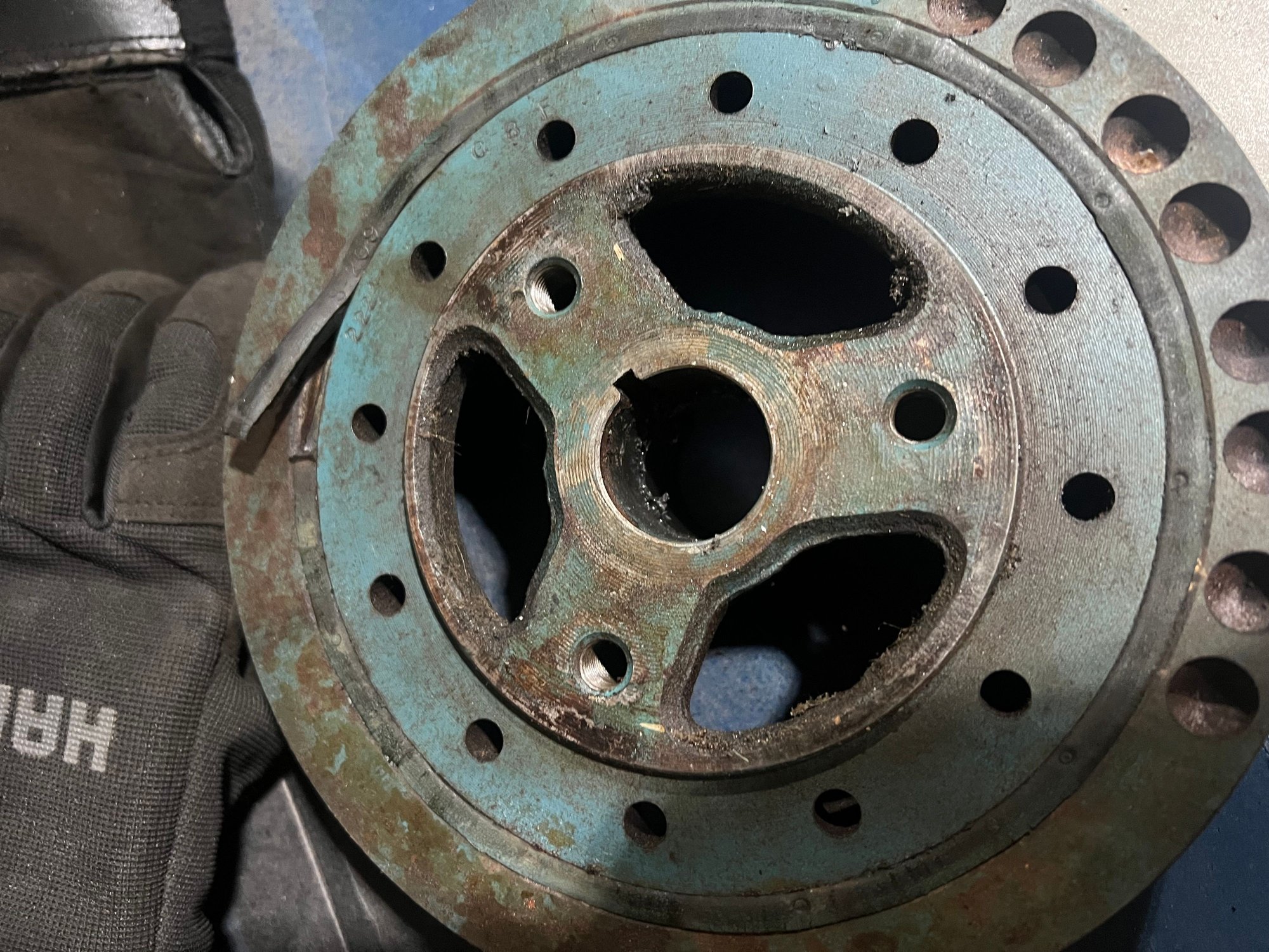

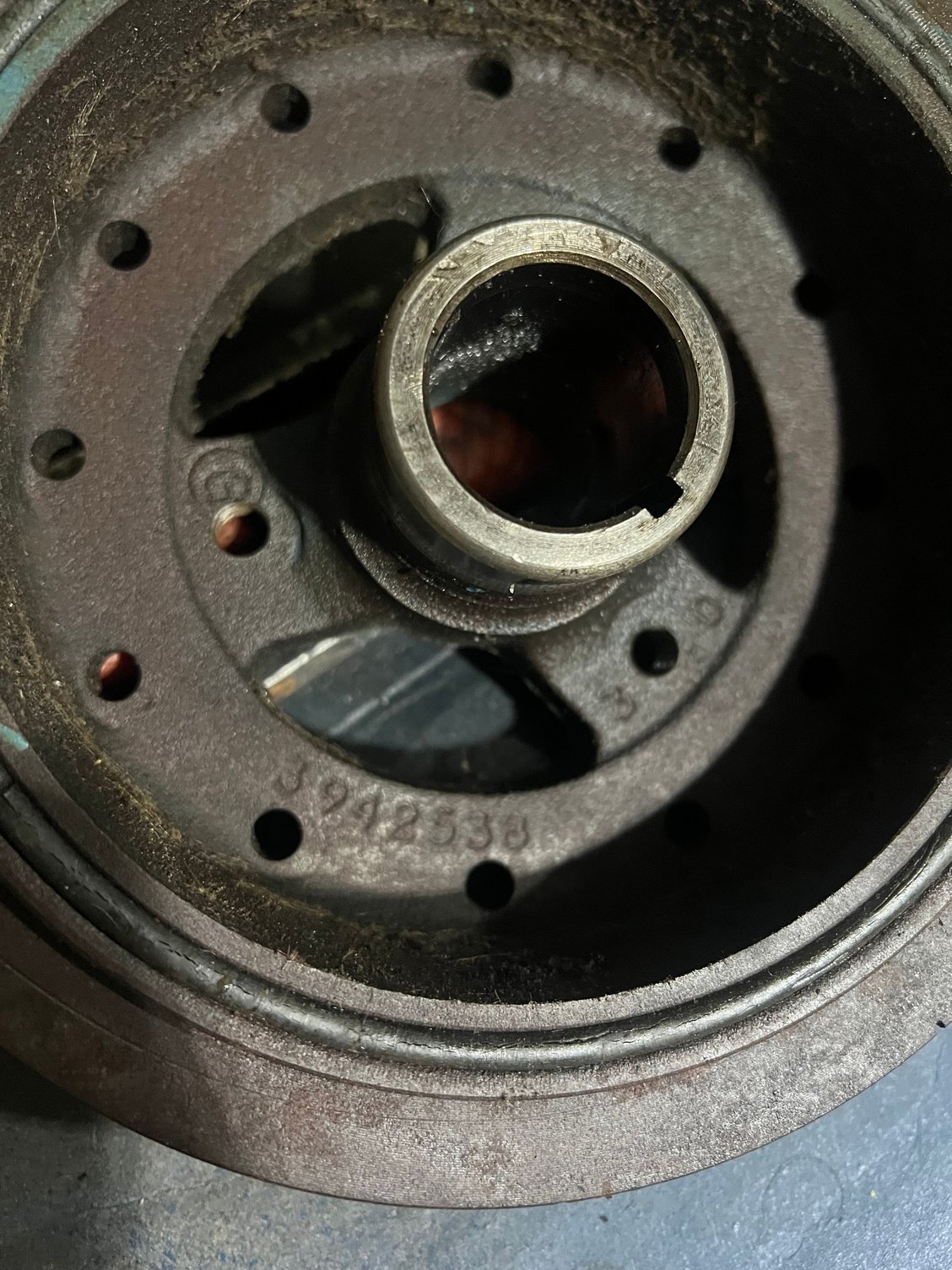

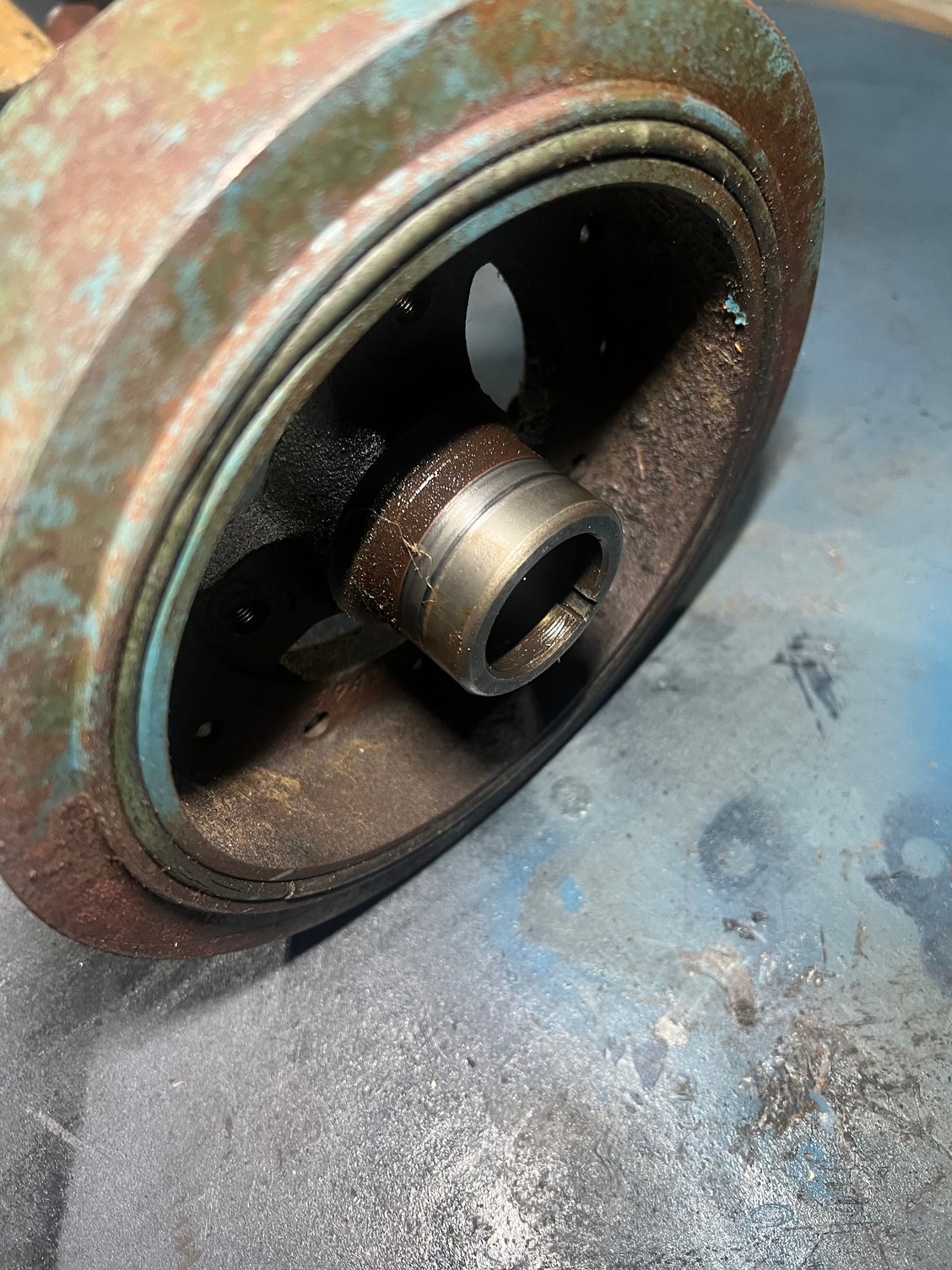

So the rubber ring is separating on the harmonic balancer from my '78 L82. It's 8" diameter and 1 5/8" thick. Do you guys get yours rebuilt? There's damper doctor and damper dudes both out in CA that can rebuild. Zip sells a new one for $74, but that seems low and makes me question quality. https://www.zip-corvette.com/69-80-350-harmonic-balancer.html
Not looking to go crazy here, but want something that will last. Thanks
