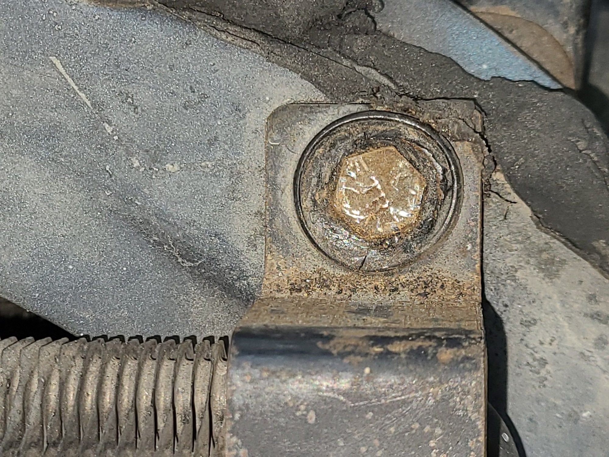

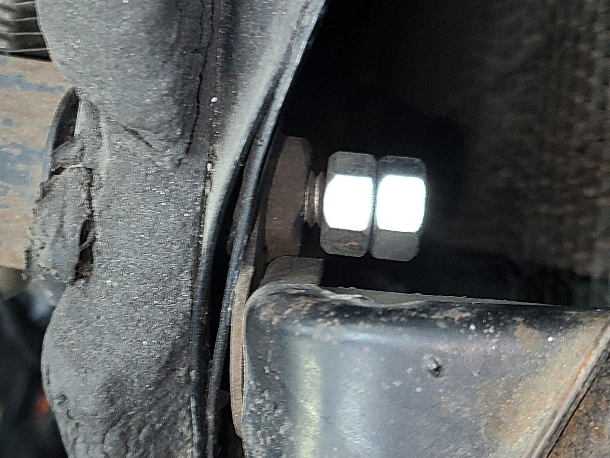

Just and update on my radiator blues... this bolt was flush and could not get anything to bite on it.
Lucky for me it was a bit long so I double nutted it and was able to turn it out just enough to get needle nose pliers on the head of the bolt and rock the bracket back and forth to unscrew the bolt.
