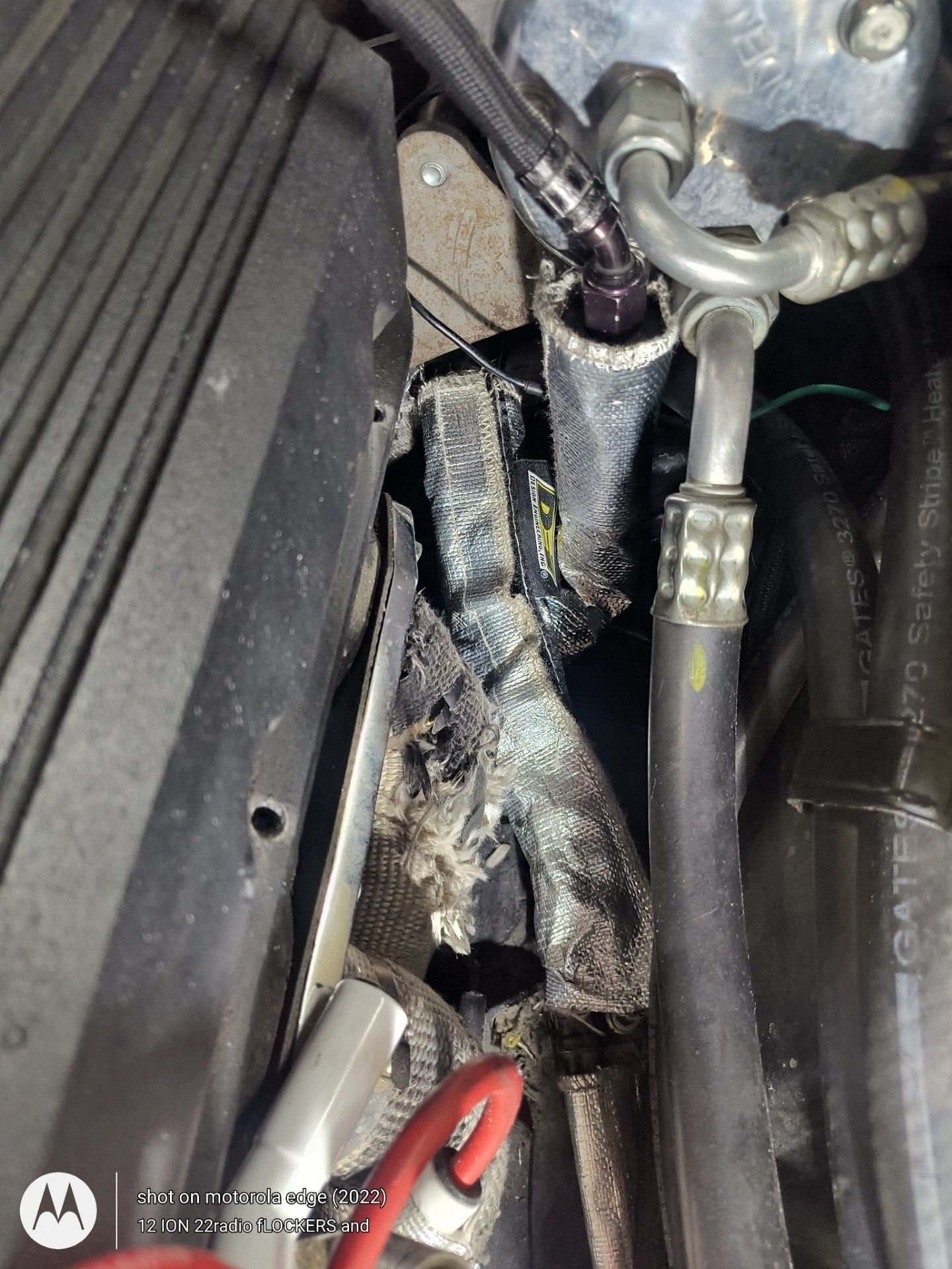

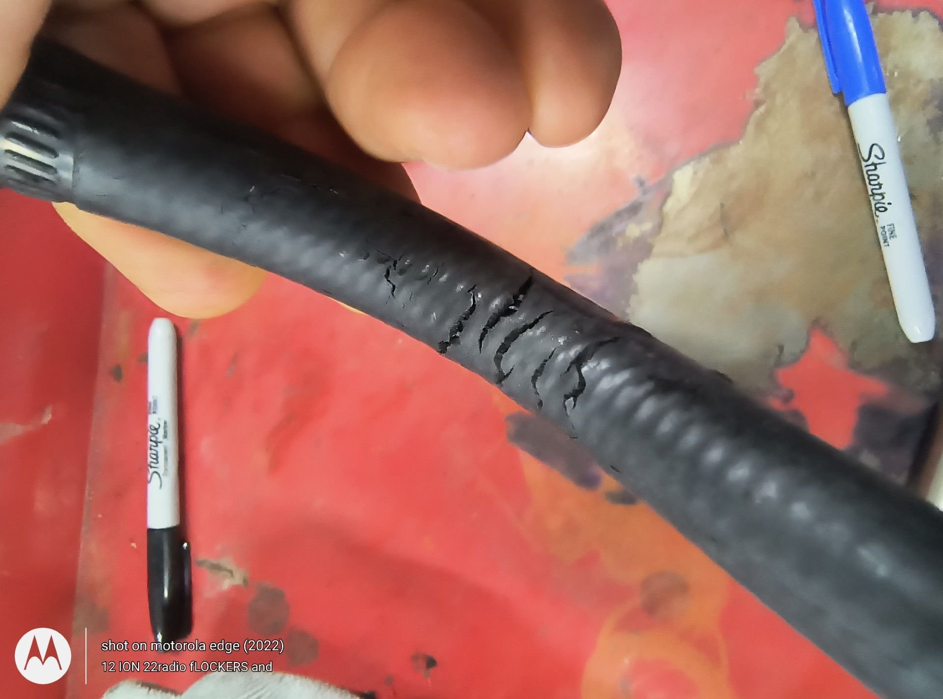

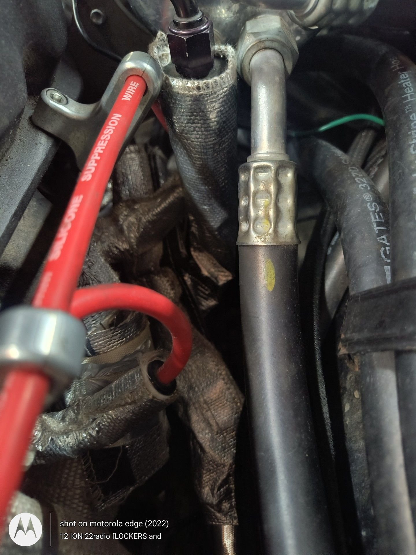

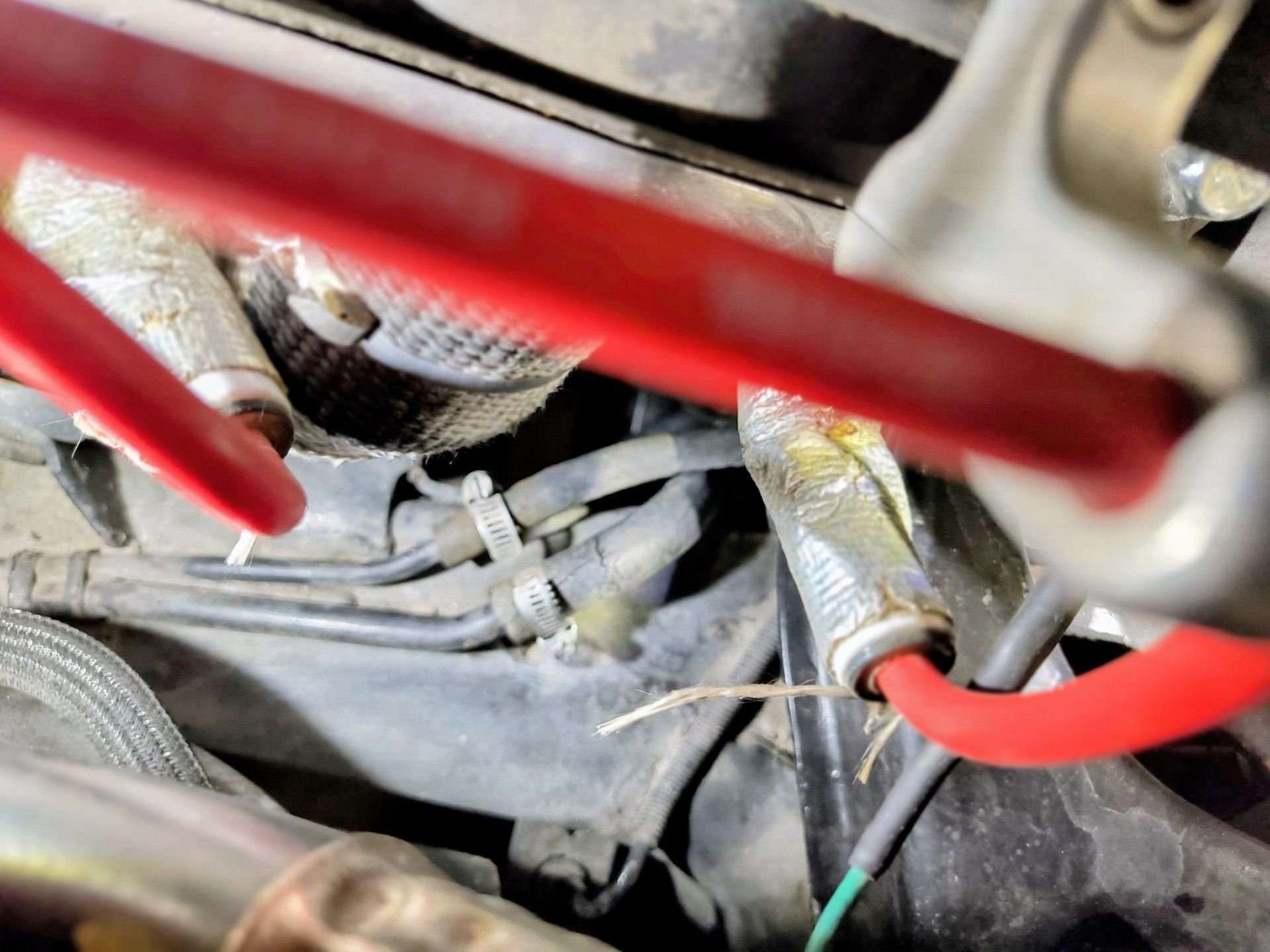

Ok guys to close out this thread, I am happy to report that my dropping fuel pressure issue has been resolved thanks to all the great replies. I replaced the rear fuel lines and filter at the tank. They did look to be in pretty good shape. However the molded fuel line on the suction side of the pump was cracked and deteriorated. I had no evidence of gas leaking from the line. But, when I squeezed the fuel line with a hose remover pliers gas oozed out This fuel line is only 5 years-old; I am sure motor heat is the cause for the quick deterioration, see the photos. I replaced that hose with an added heat shield sleeve. I replaced the fuel pump with a Cater OEM style with a Vapor return. I added heat shield sleeves over the metal fuel lines that run along the frame inches from the headers and a heat shield sleeve over the pressure side fuel line and filter going to the carb.
My least favorite thing is working around dripping gas. So I chose to address the three potential causes, fuel lines, heat and a failing fuel pump, all at the same time; It could have been a combination of the three, who knows, but I only had to yank the fuel lines off once and the problem is solved.
Thanks for all the replies
Unprotected fuel lines inches from the headers

Cracked molded fuel line

Heat shield sleeves on fuel lines

Looks like you definitely needed to replace the fuel line. one thing after seeing your pictures and rereading your first post about your car still running when showing no fuel pressure. you have a liquid filled fuel pressure gauge mounted in the engine compartment. I have heard that those are not a good idea because when they heat up they can tend to show no fuel pressure - something to do with the liquid inside. a new fuel pump doesn't hurt but now I wonder if it was just your gauge.

pspicci the molded fuel line was cracked throughout and very deteriorated so that had to be replaced and while I was down there it was just two bolts and $50 to replace the pump. I know I swapped out an old cheap one for a new cheap one. I researched that pump you mentioned in your post; $275, but that looks like a great option. I just scored a Quickjack lift that made life a lot easier but dealing with flowing gas is one of my least favorite things.
I am happy to see that I have already incorporated Leigh1322's engine cooling recommendations except running the Vac Adv to full manifold vac. On that note, my Street Avenger has a smaller Full Man Vac port next to the larger PCV port. I am guessing that that smaller port is what I would connect my Vac Adv to. However, when I checked the vacuum the smaller port read 5" and the PCV read 14" I will recheck that to make sure I got that right. What would be another way to tap into full Man Vac? Plumb with the PCV or tap in another way.
