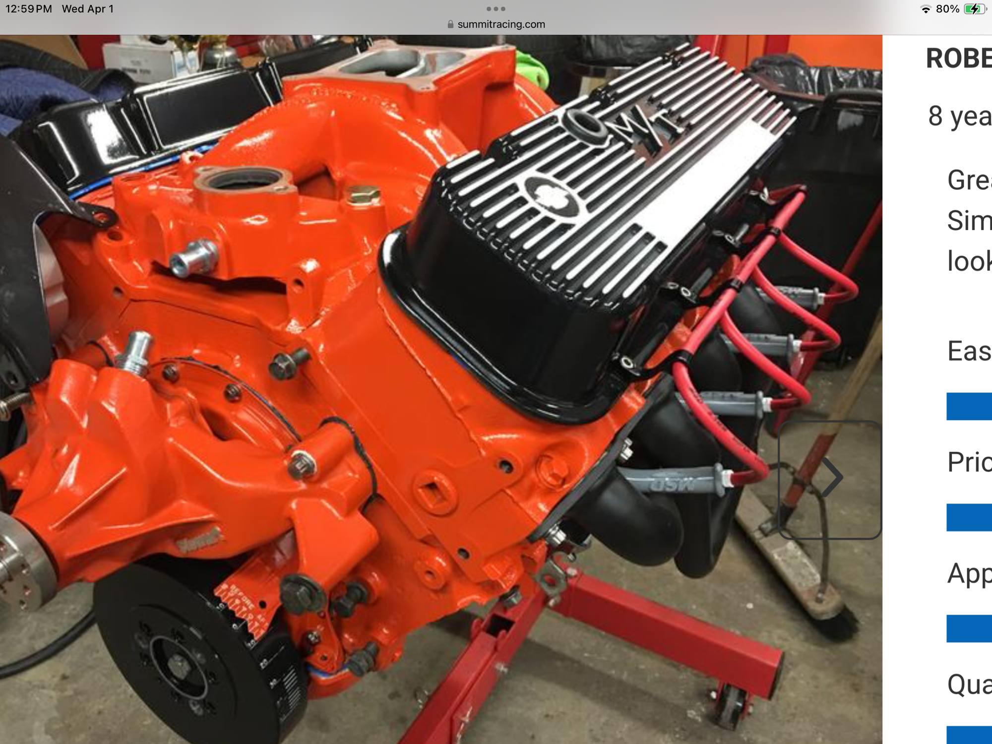

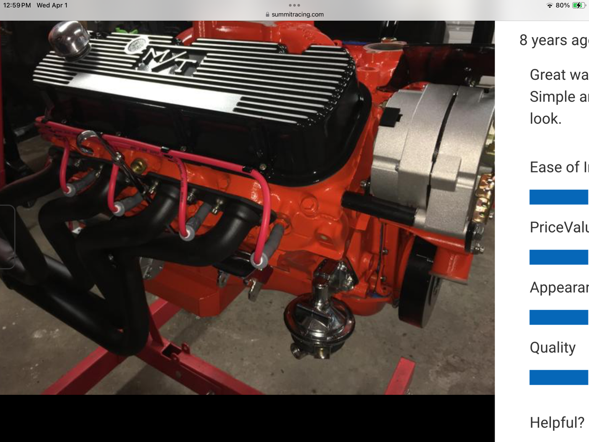

I’ll be installing the new MSD plug wires and Billet Specialties wire looms over the next couple of days.
I purchased a set of the plug wire boot protectors (insulators) to protect the wires and boots from the header heat.
I’ve never used them in any other build and I’ve never melted a single boot or wire.
I have about 1/2” to 3/4” spacing between the boots and the primary header tubes on all cylinders and I’m wondering if they are really necessary, or are they just a new marketing tool for us to spend money on.
I do think they are really ugly and would rather not run them.
This is not my engine but it does show the wire looms I’m installing and the spacing I have between the header primary tubes and the plug wire boots.

So this morning I called MSD and asked what they recommend and this was their response.
If you are running an engine that puts out an extreme amount of horsepower (1000+) that runs extremely hot, under race type conditions with race fuel or nitrous, then they suggest running the protectors.
If you have plug wires or boots that are either touching or are extremely close to the header tubes then install the protector.
If you have over 1/4” clearance between the header tube and the wire or boot, not running extreme horsepower or fuel additives on a street driven car, then they see no reason to install the protectors.
They concluded that every engine and situation is different and they said to run the engine under my normal driving conditions and if I see any issues then add the protectors.
So for now I’ll leave them on the shelf and see what the future holds.
Thanks guys!

Thanks everyone.
I had my headers ceramic coated inside and outside for better heat reduction.
The plug wires are the MSD multi angle type so that once installed they can be bent to provide additional clearance.
I am using the Billet Specialties wire looms in the pictures in post #1 (not my engine) to help keep the wires in place.
