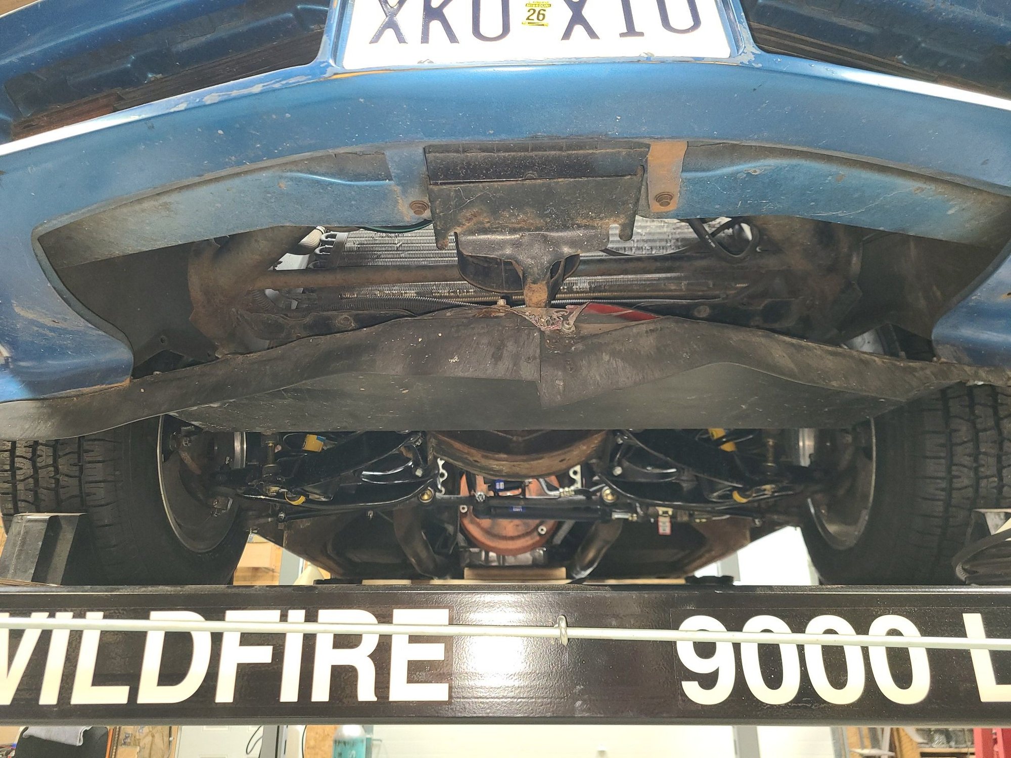

Default 82 Pan Under the Front
What is this pan supposed to bolt up to? It was held on with Bubba Wire...

Wow. You'll likely be overheating on the highway with that.
The center valance panel should bolt to your radiator support surround.
Here's the best diagram I could find.
https://keenparts.com/shop/fiberglas...lance-panel-2/
ACI also makes this part, though Zip (and others), don't seem to have a good diagram.
Do you have an AIM for your car?
https://www.zip-corvette.com/80-82-c...iberglass.html

The fan shroud is not in place in those photos...

I looked in my 82 factory assembly manual and it's not clear what's missing. It shows 4 bolts coming up from the bottom and bolting into something. I'll have to look again today if it's supposed to bolt to the bottom of the radiator frame.

I'm thinking a PO made or modified that piece, and you just need a proper, complete "Air Baffle", or lower center valance, or whatever you want to call it.
My 80 AIM shows the same image as in the link to keenparts.com above. I don't have my 82 AIM handy, perhaps it has 4 bolts instead of 2, but the valance is the same part, 80-82, and it bolts to the radiator support.

My 82 assembly manual shows the exact same drawing, the notes are a bit different but the drawing is the same.

This is the view from the front. It might be that Bubba cut the sides off but I don't see any place on the radiator support to bolt it to... just a couple of what looks like drain holes.

Not the best photos, but the outside bolts seem to match what's in the diagram above. I have 4 bolts, which is not in the 80 or 82 AIM, but matches what you saw somewhere?. This is a replacement fiberglass valance panel, made to OEM spec.

I just went out and looked at mine and now I see the two bolt holes in the front of the radiator support that the Center Valance Panel bolts to. I have one on order from Zip and it should be here today. I bought the rubber skirt quite a while ago but in the back of my head I knew something was wrong under there so didn't try to install them.
