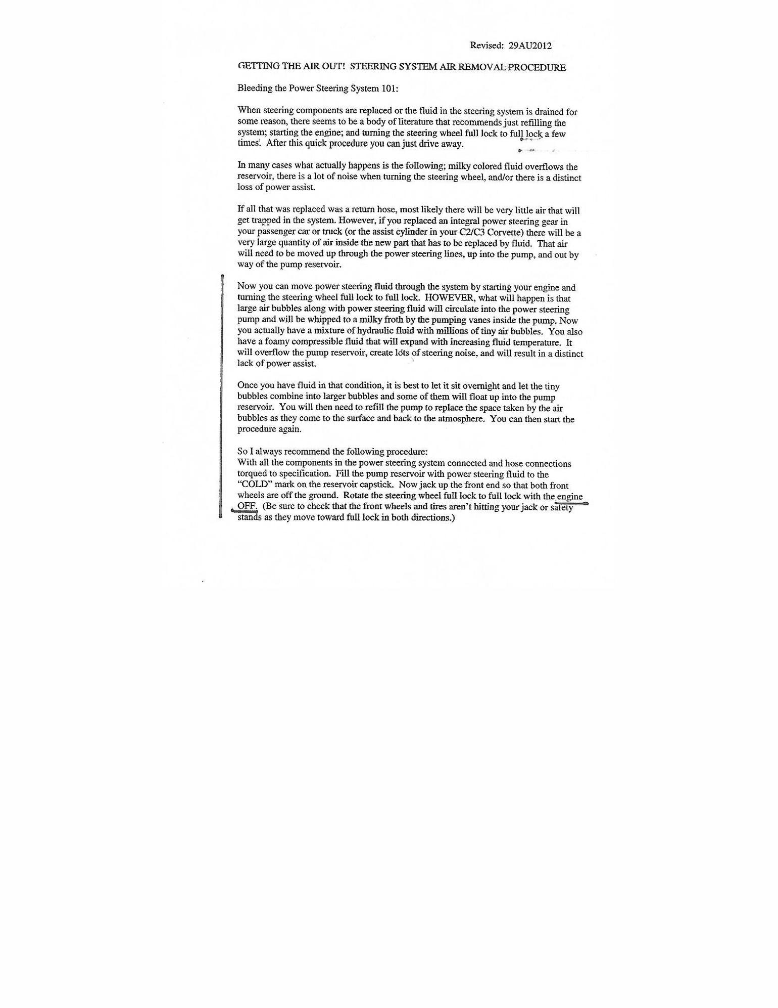

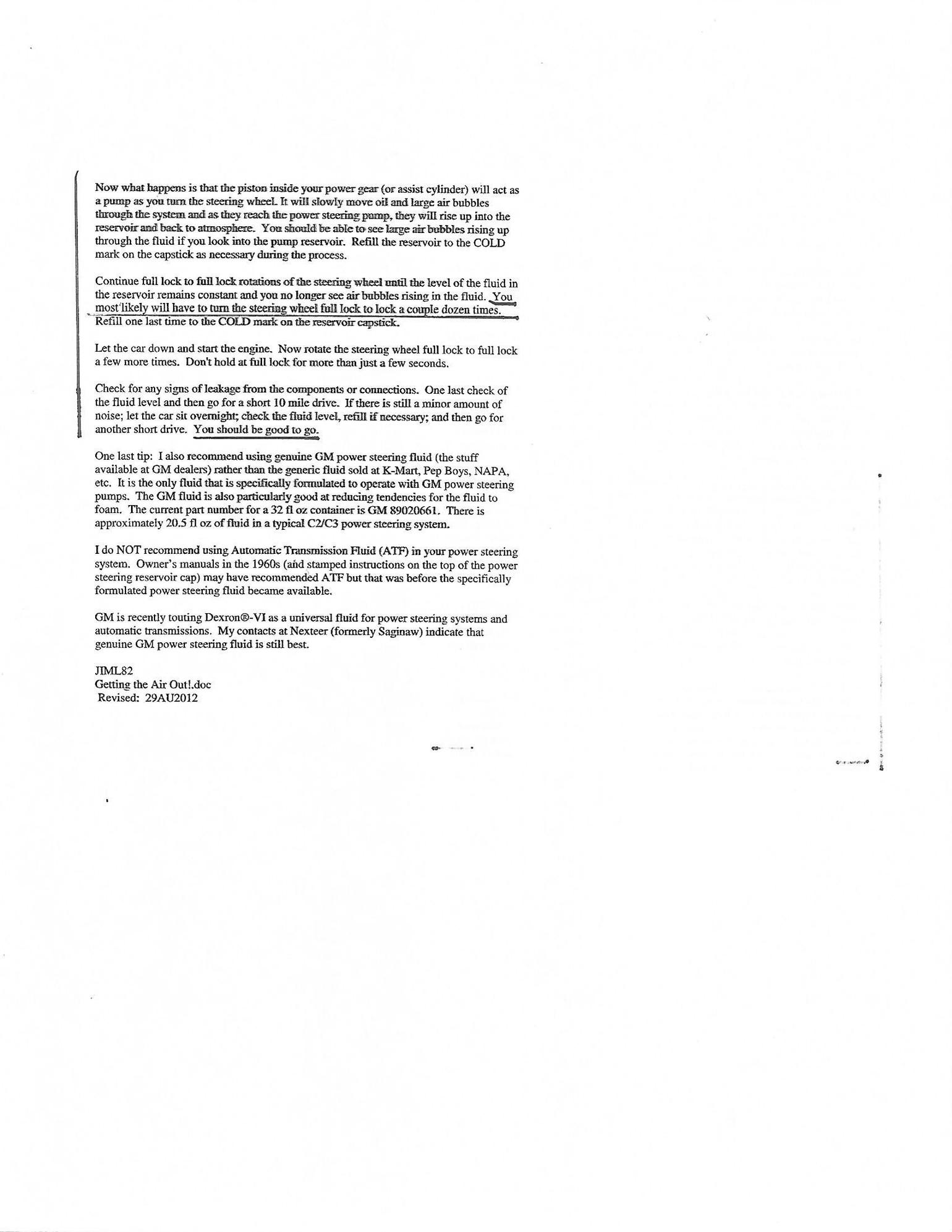

Old Apr 10, 2026 | 09:43 PM
Peterbuilt's Avatar
Peterbuilt
Joined: Aug 2006
Posts: 7,427
Likes: 1,560
From: mount holly NC
Default Try bleeding with the engine off.
Old Apr 10, 2026 | 11:42 PM
Kevin LD's Avatar
Kevin LD
Joined: Feb 2025
Posts: 171
Likes: 24
From: Superior WI
Peterbuilt,

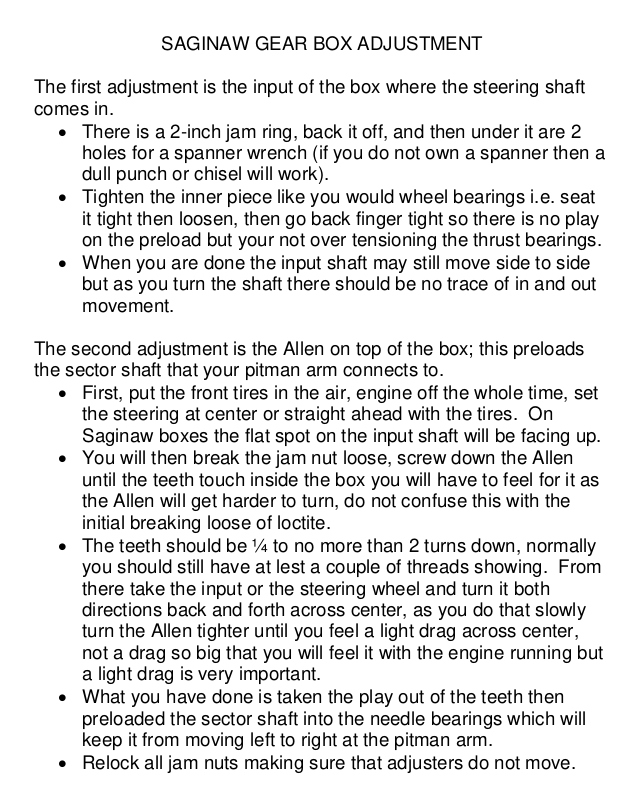

Thanks for the written instructions. I followed them to a tee and the jerking is gone, so there must have been air trapped in the system somewhere. There is still a lot of play in the steering. My rag joint is good, my tie rods are tight so I tried to adjust the steering box. I got the top one to adjust easily but I can't adjust the horizontal big bolt. I unscrewed the lock nut and had a really big wrench on the adjustment nut but it wouldn't move at all. I shot it with WD40 and will try again tomorrow. In the mean time does anyone have other suggestions for me?

Attempting to correct the steering box by making a lash adjustment is more than likely going to cause gear wear if done incorrectly. The large lock ring holds the preload in place and that is not something you correctly do on the car.
If the box is original than you probably have worn out bearings, possibly gear etching, and old acidic grease. If the box has ever been worked on then all bets are off until if can be inspected by a knowledgeable person. Many boxes have worn gears, many places don't have gears, just the common rebuild kits. Those kits use one size fits all bushings and they no longer come with a cover bushing.
You don't need a new box or a Jeep box, but you probably need yours built correctly to have no play in the driving position. Tightening the lash screw alone typically won't do it. I lost track of how many of these boxes I build that had gears bottomed out and wrecked.

You can rebuild and adjust the steering gear box "out of the car".
Edit: delete incorrect instructions.
JT
JT - unfortunately, that is not the correct method to adjust a vette Saginaw box. They don't have pin hole adjusters, there is no definitive adjustment to either preload or lash. The vette boxes do not have hex lash bolts.
