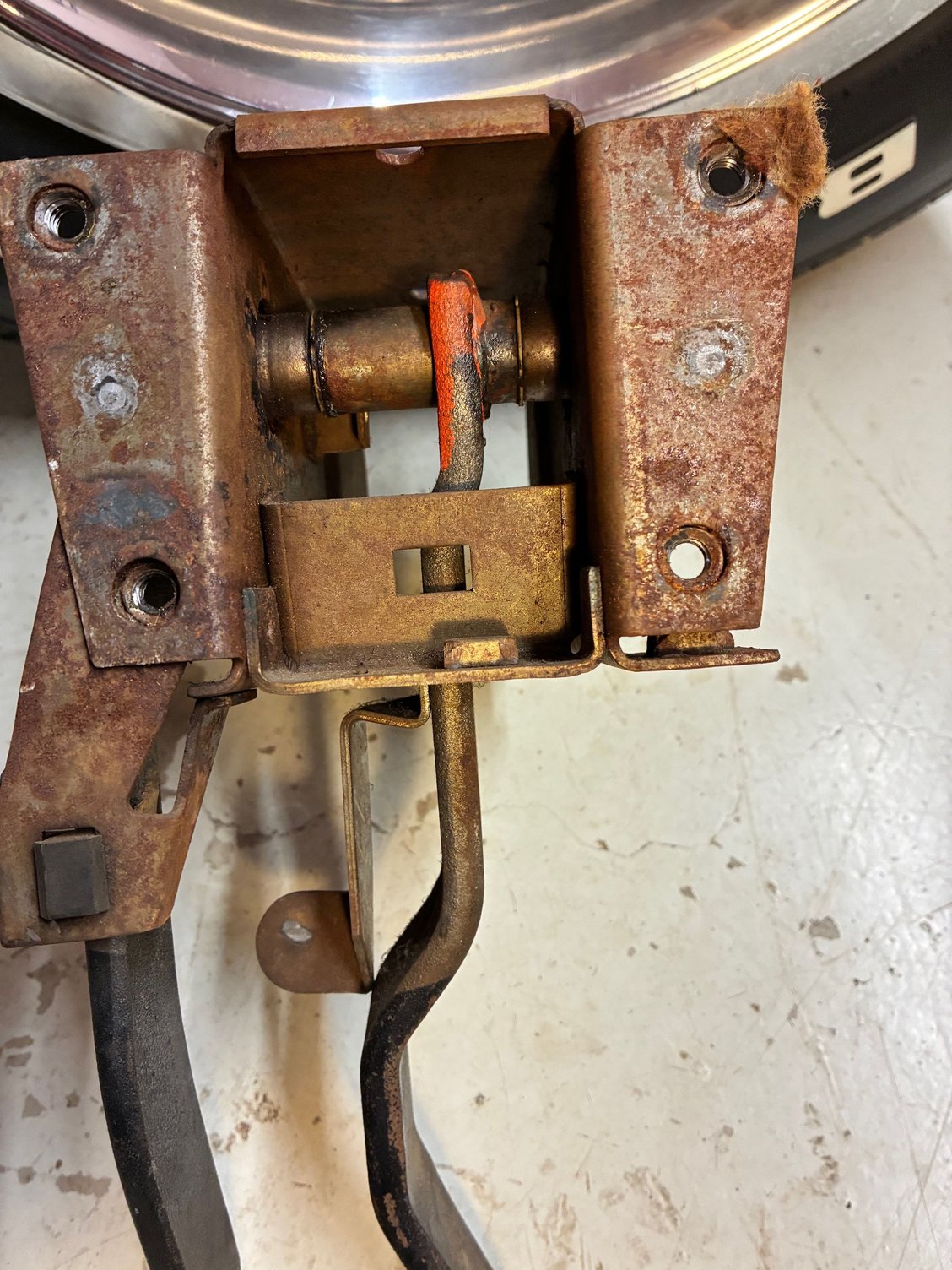

I'm having to replace the vacuum can on my '69 BB manual trans Vette. So one thing leads to another, I decided to replace the power break booster at the same time as I have noticed a change in RPM when I depress the break peddle. I also noticed quite a bit of ware on the cultch rod and attaching peg on the cultch peddle arm, so I decide to replace them as well. When I get the peddle assembly out,
I notice no spring on the cross shaft. Shouldn't there be a spring on that shaft?

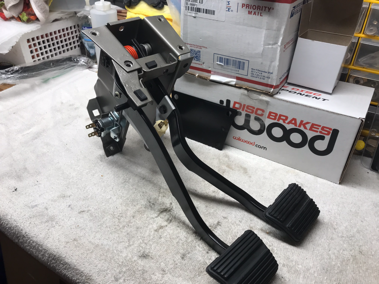

Not the perfect picture, but that big red spring should be in there.

That's what I thought, Thanks
