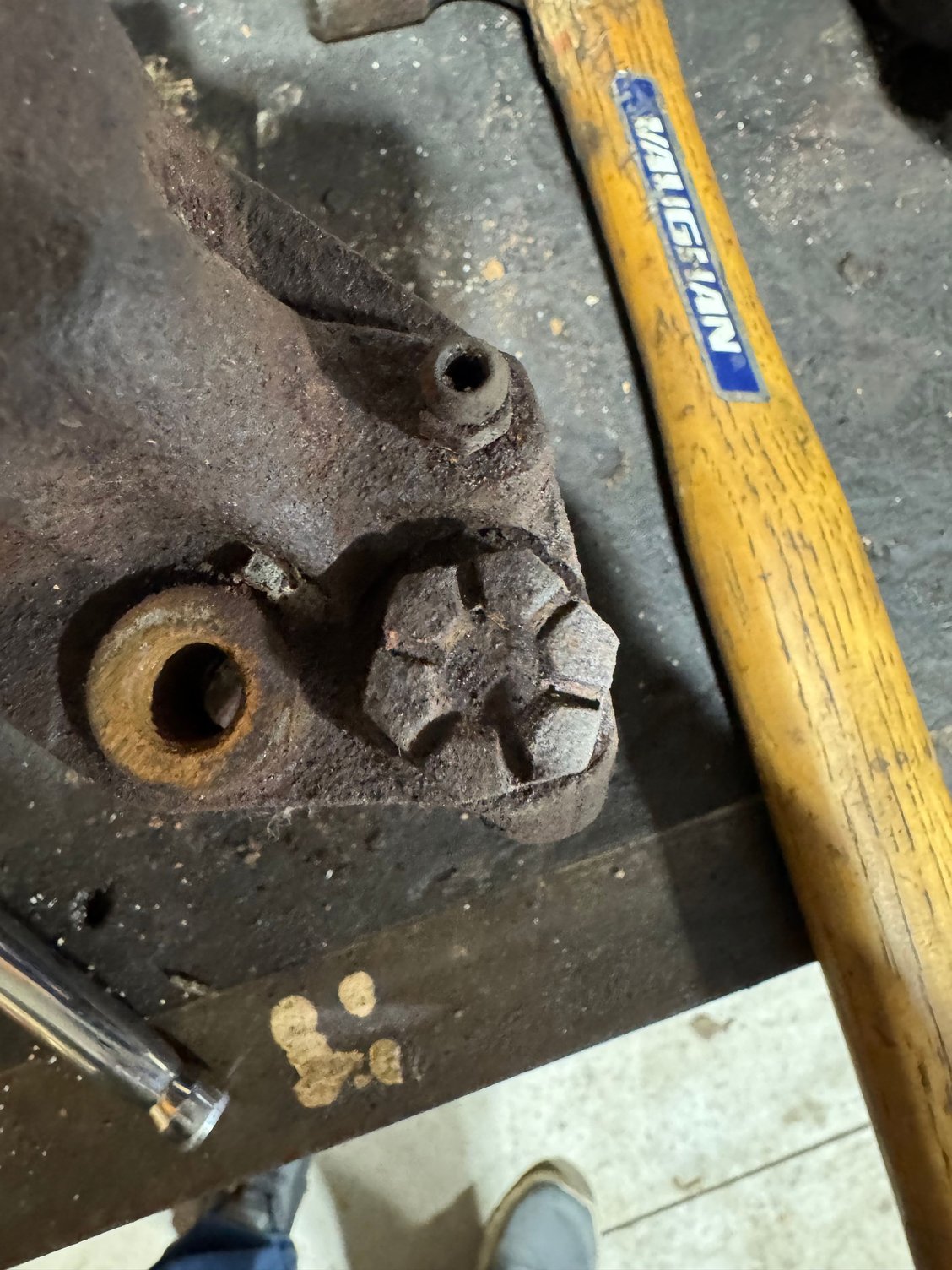

Rebuilding my brake system and one of my calipers looks like it has a castle bolt on it. I know we have castle nuts on the tie rods and other components, but I have never seen or heard of a bolt like this.

I believe the head pattern of 6 lines means it's grade 8 and not truly a castellated fastener. An old Paragon bolt catalog shows a similar bolt head (below) as a 3/8"-24tpi x 1" but yours appears to be the caliper bolt to secure the two halves so it's got to be longer than 1".

Rejoice. It is the original.

Thanks! It had me and a few friend stumped.
Trying to remove it, it definitely feels like it has been there for 50 years!

Before I had impact guns, I would mount the caliper back on the car and use a six point socket with a breaker bar for leverage. Spray it liberally with Kroil or Liquid Wrench for a few days. Good luck. Jerry
