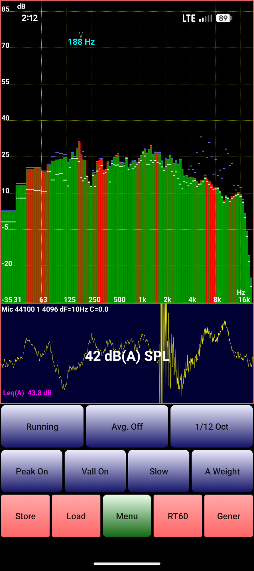

What are you using to measure sound level?
A decibel meter that only gives you one number is of limited value.
I use a free app download for my Android phone called audiotool.
It uses the phone speaker.
It can measure db in different ranges, gives a frequency graph, and can generate tones as well.
Those features are very useful.
But since it uses the phone speaker, it may not be all that well calibrated, and your and my readings could differ.
But it does not really matter if your and my peaks match, it is the peaks that truly matter.

Car parked engine off
Car parked engine off. All the peaks are at about the same level, so you can not hear just one. It sounds like white noise, almost invisible to your ears.
