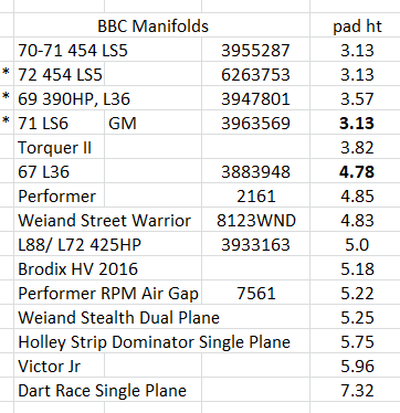

Nice try Sunflower but Google A.I. let you down this time.
The 3 starred intakes are the ones that fit. A stock BB hood.
And you can use a 1/2" carb insulator spacer on those (strongly suggested) and maybe have 1/4" left over.
Several BB guys run these and confirm fit.
I have measured both intakes and a couple cars.
Even the torquer is cramped. BTDT. Unless you want to run a 2" air filter on a BB?
The Google AI non-sense is just that, non-sense. In this case.
The C3 has three different hood heights, and I am sure "it" is not taking that into account.
It's not "that" smart...yet... but it's getting better!
The 163 L88 intake is 5.0" tall and requires the L88 hood, and it's air cleaner.
It is not even close to fitting a BB hood.
And both the Eddys are that tall.
The 2161 is about 1 inch too tall for a BB hood. But not an L88 hood.

Does the 3963569 have oval ports? Thanks for this very valuable information.

Hello ieigh1322 are you sure the 71 LS6 Intake with casting #3963569 is an oval port intake? I can only find it in rectangular port at Jegs, Summit, OER etc.

No worries Sunflower!
Sometimes AI is great, sometimes not. It is hard to tell which is which.
I was also wrong, C3 have had 4 or 5 different hoods on them, with at least 3 different hood bulge heights, that I know of.

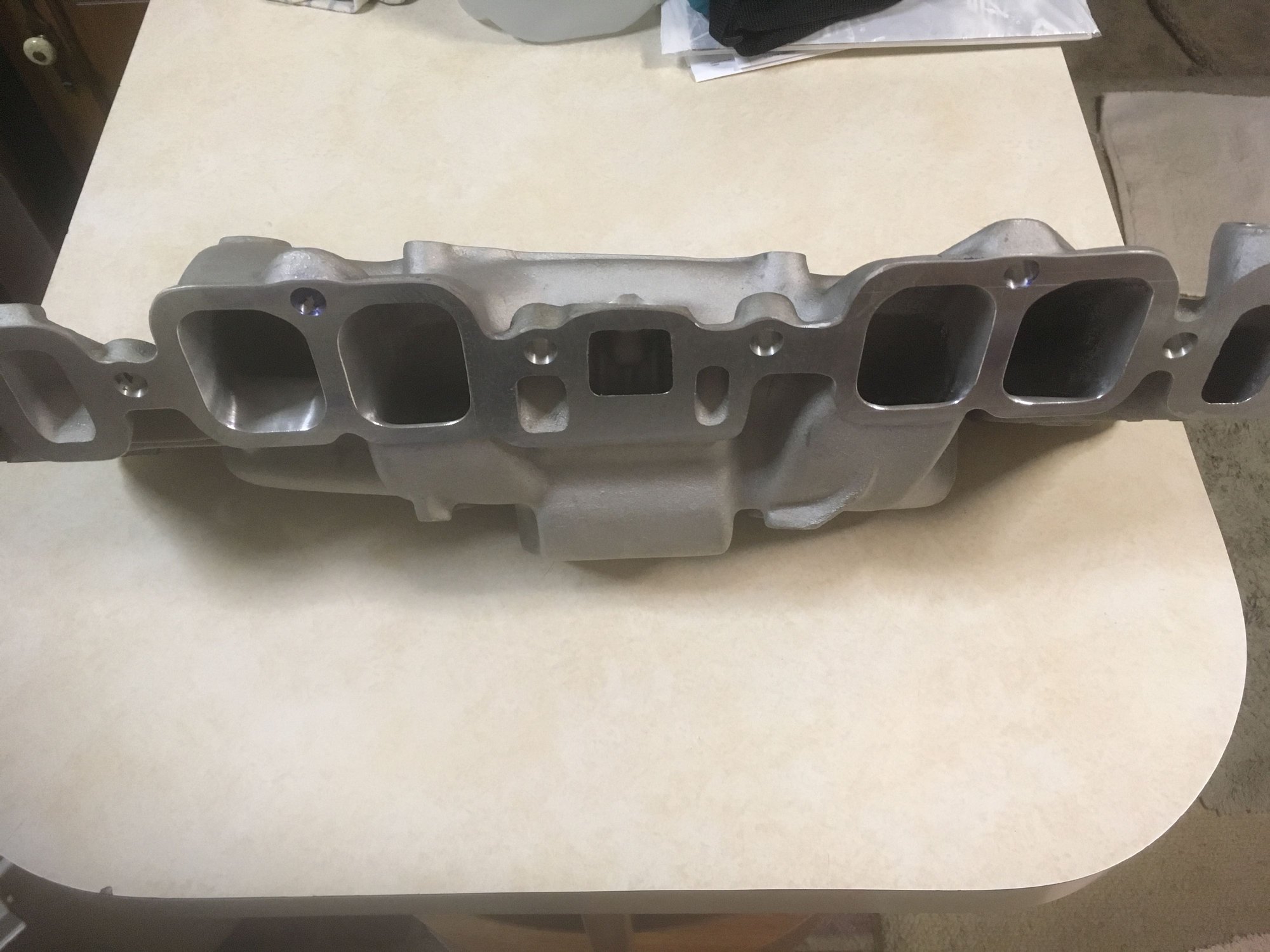

Little red; the 569 is definately a R-port intake. But if you want to run a Holley with that BB hood, it fits great, better than anything else. The port mismatch does not cause anyone any issues, many folks run this with oval heads. The ports are generously large, that may have something to do with it.
DDawson runs it on his Blueprint ~550HP 502 and has no issue. It just seems to be the best fit and function overall. But do not try to run a Qjet on it, with an adapter, the adapters just don't work well.
The Torquer has very small ports, and chokes off a BB around 5000, plus it is just tall enough to sometimes need a restrictive short 2" air filter. That seems to vary by car.
A used GM aluminum 801 is your best Qjet intake. They are out there. It came on 68 & 69 390HP 427s.
I have seen a dozen other BBs, trying to squeeze one of the aftermarket intakes in there, and they all seem to have very small & restrictive air cleaners on top.
Sideways view of how flat the 569 is.... but it was designed to fit.....thats how squeezed in a BB is in a C3.
Sideways view of how flat the 569 is.... but it was designed to fit.....that's how squeezed in a BB is in a C3.
