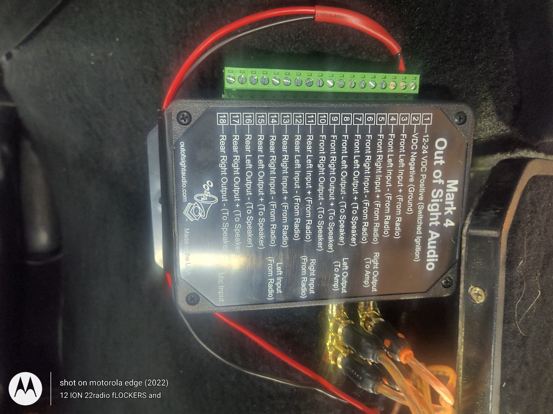

I just wanted to post a recommendation for a stereo option, especially if you want to maintain you C3 dash or put it back to the original look. Since we are using the Cell Ph for EVERTHING. I just installed a Bluetooth device, a lil bigger than a Cell Ph, that was really easy to install and "pair" with my Cell Ph.

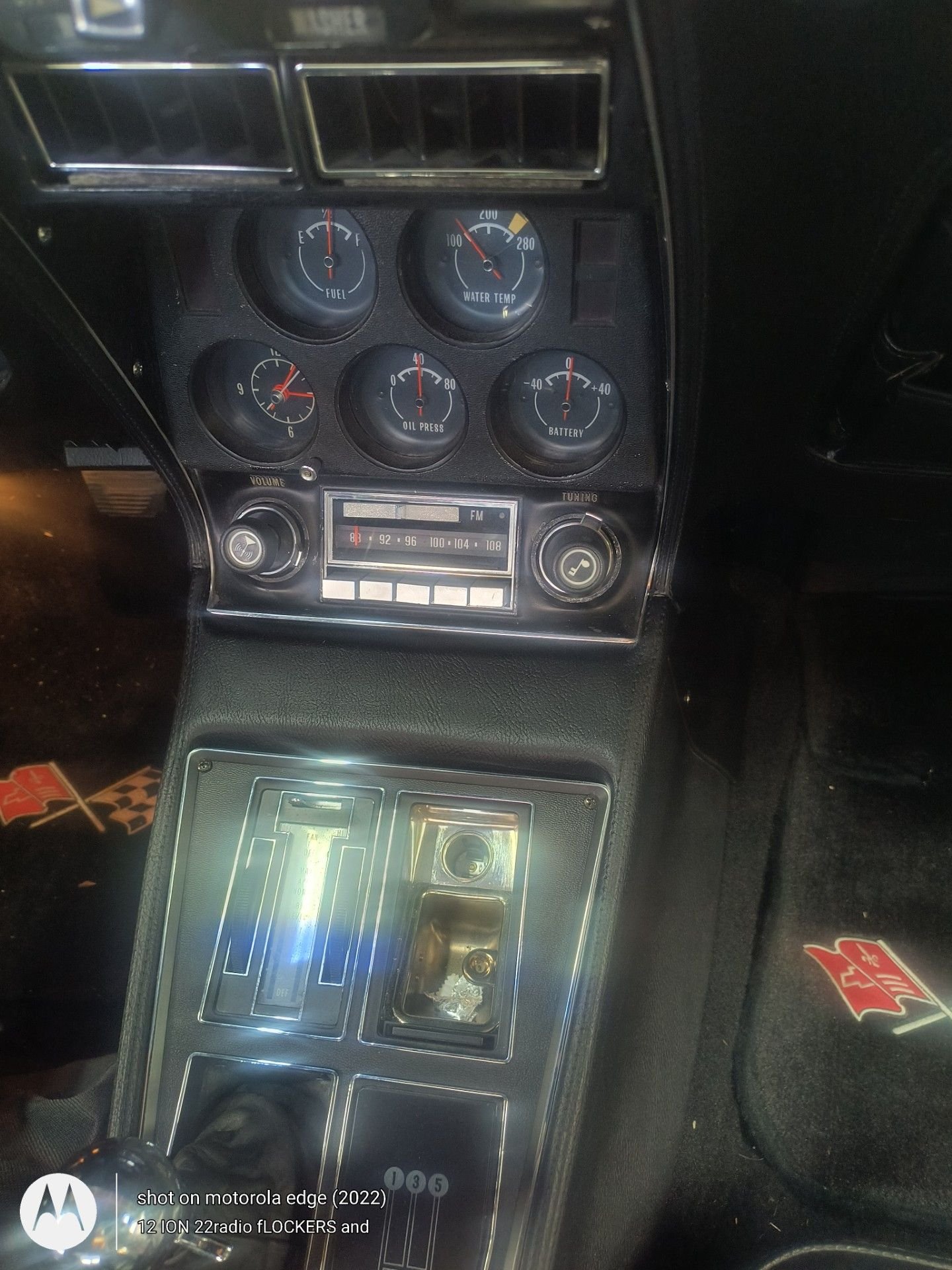

About 20 years ago I installed my audio system in the passenger side rear compartment; 400-watt pwr amp, Sirus radio and head unit with a wired LED remote control used in boats to control everything. In my dash I had previously installed a Custom Audio C3 Corvette look alike radio. It looked great but the controls malfunctioned. I kept it there with the radio light connected so the dash looked original. The actual audio system was entirely concealed in the rear compartment.
My marine control unit quite working after 20 years of faithful service. I cleared everything out except the pwr amp and installed this 'Out Of Sight Audio" Bluetooth device. I got the Mark 4 model, $400. It has RC audio out jacks for a pwr amp or you can wire the speakers directly to the device. No head unit or aux music source required. All audio and audio adjustments are controlled on the Cell Ph via Bluetooth.
It really cleaned things up and you don't have to mess with the dash. And
Custom Audio look alike just for looks. I do have the original radio

Bluetooth device super easy to hook up

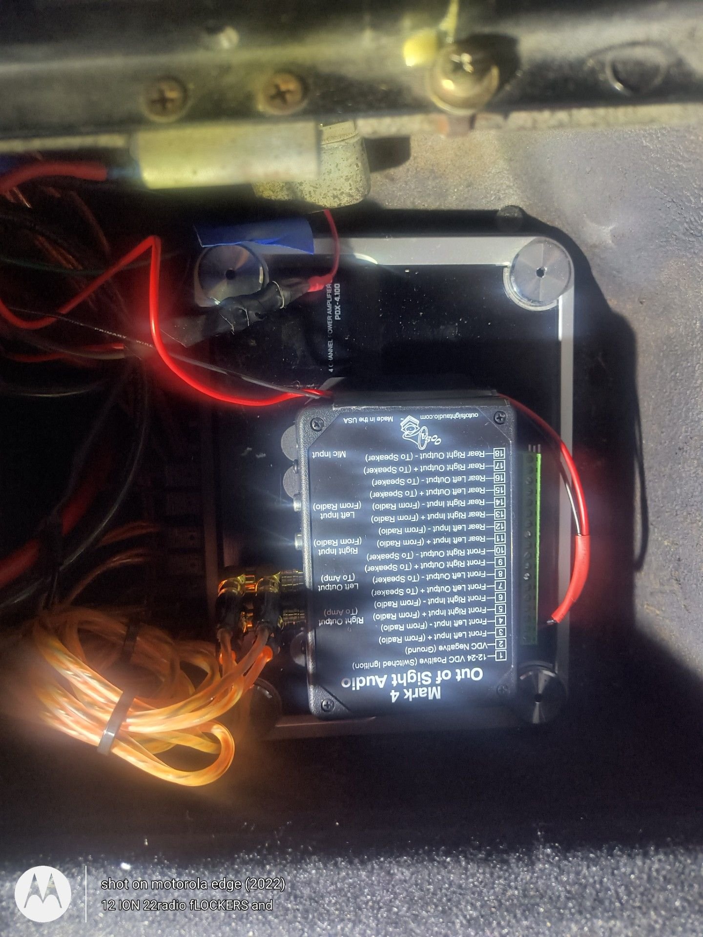

Bluetooth device mounted to the top of the pwr amp in that rear compartment

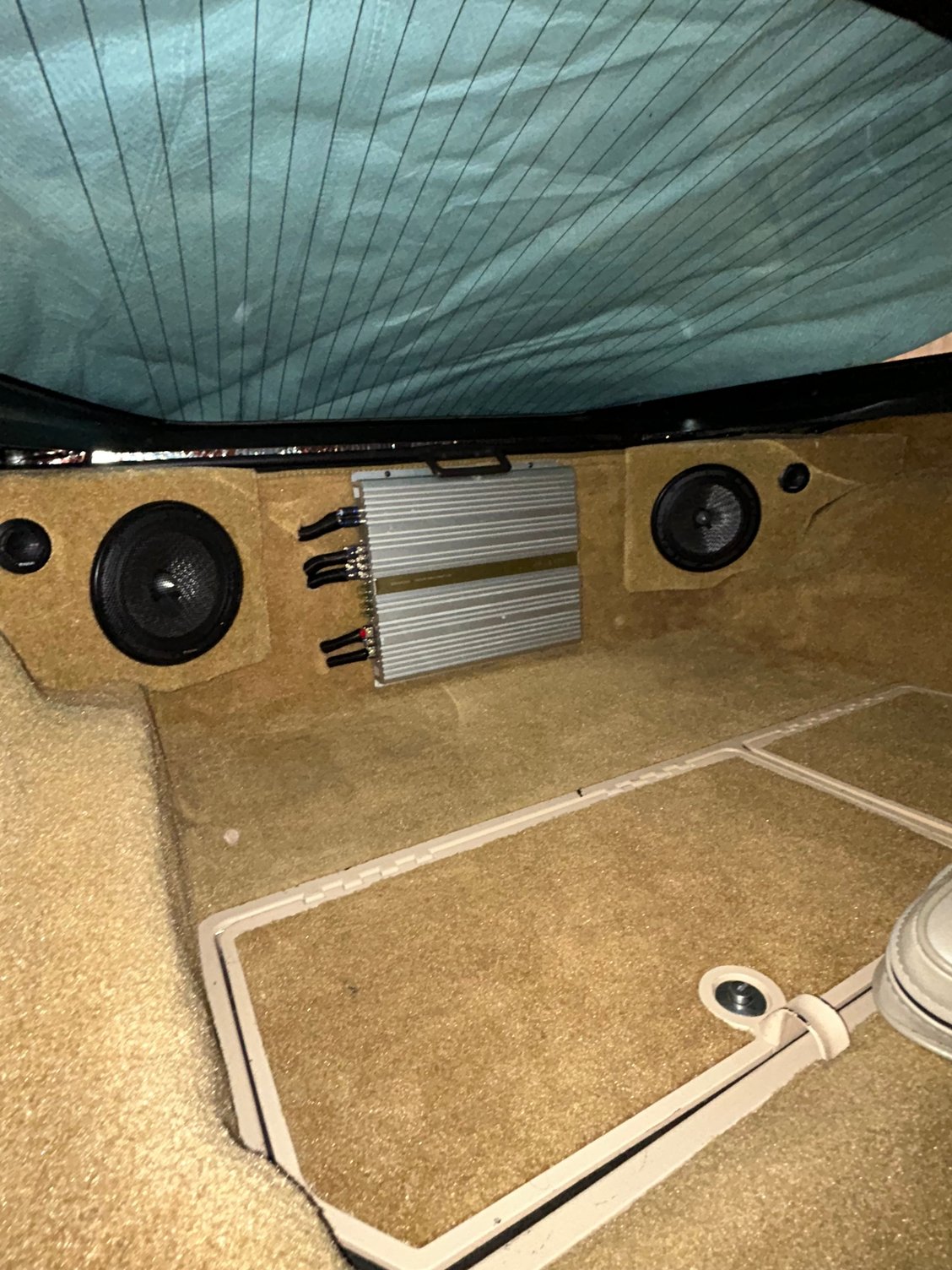

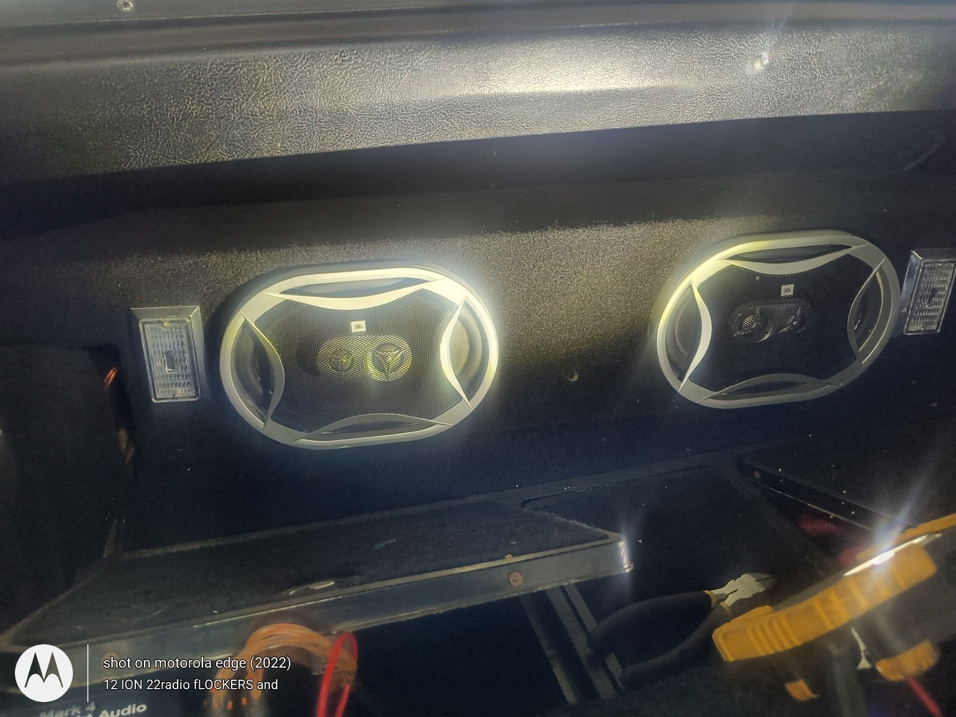

My 6X9's also 20 years old. still rocking. I mounted two interior lights.
no, that 400-watt amp has been jamming in that rear compartment for over 20 years and never over heated.

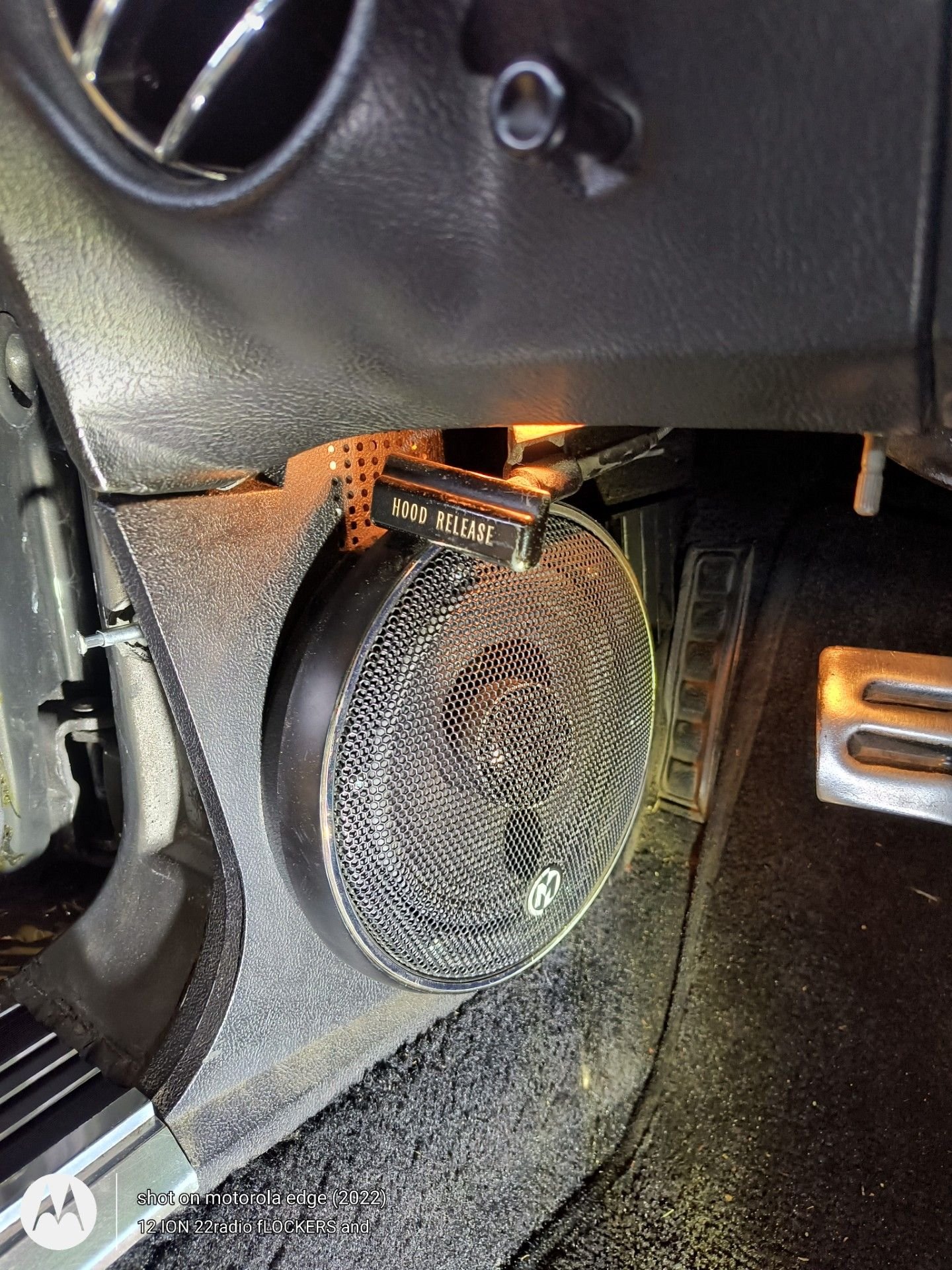

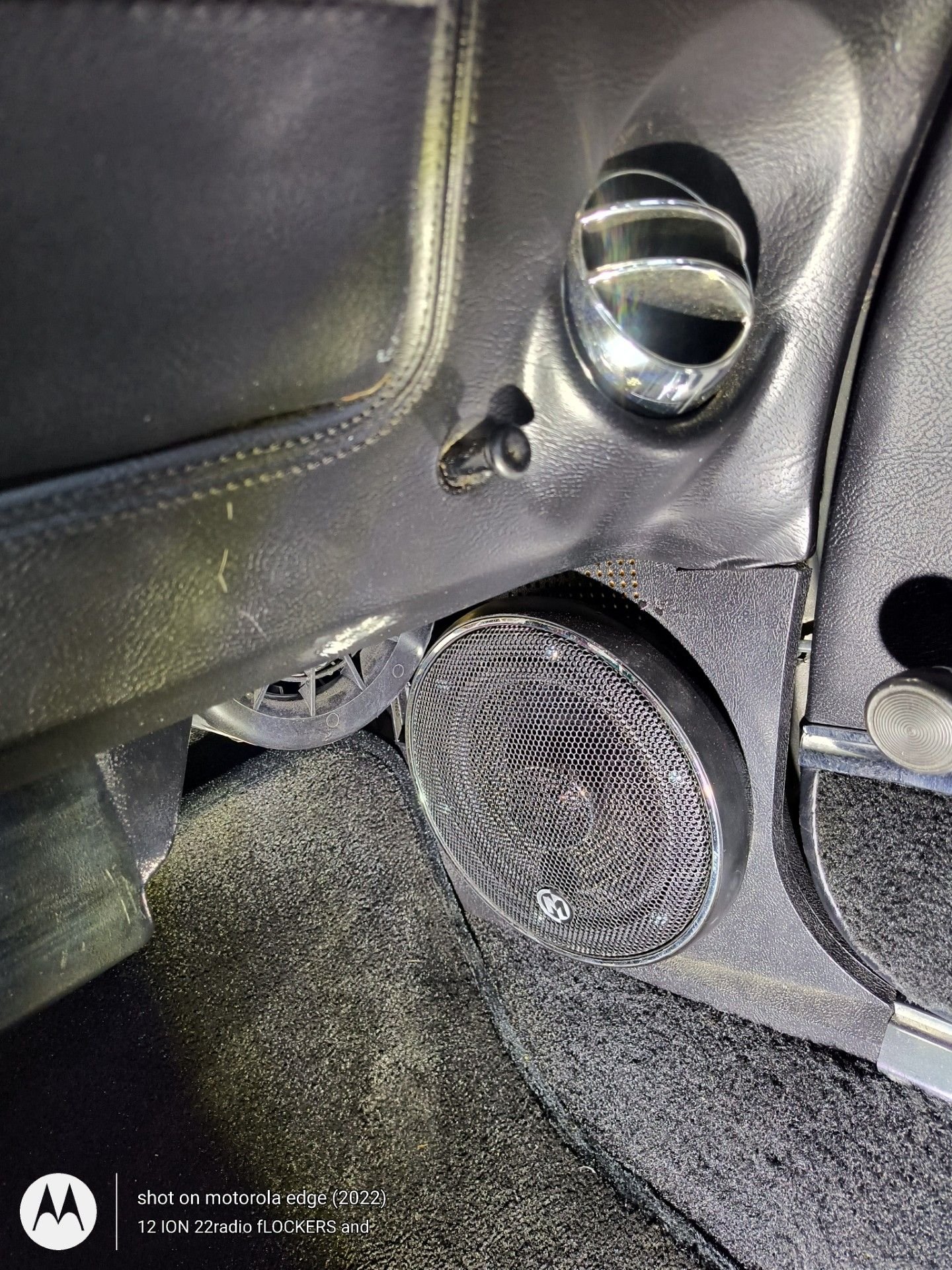

If you find yourself wanting to rock out a lil more here's some additions I made along with a 400 watt digital amp. sounds great even over my sidepipes
8
8" speakers mounted in the kick panels
6 X9's in the back
6 X9's in the back

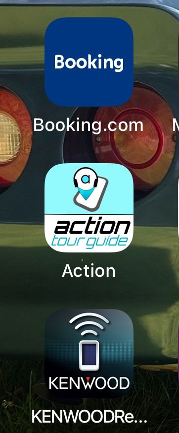

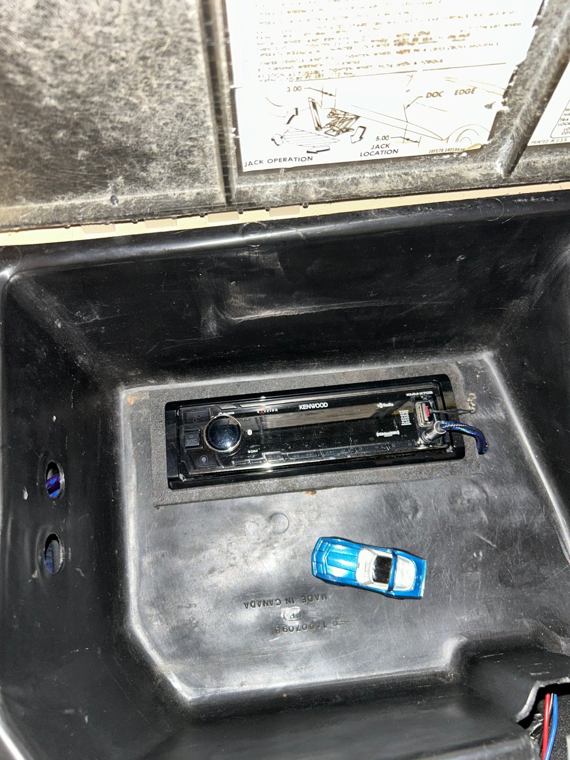

this is what i did.
kenwood BT media player 6 channel rca output and is short than a cd player. kenwood has a app so you can control the head unit with your phone.

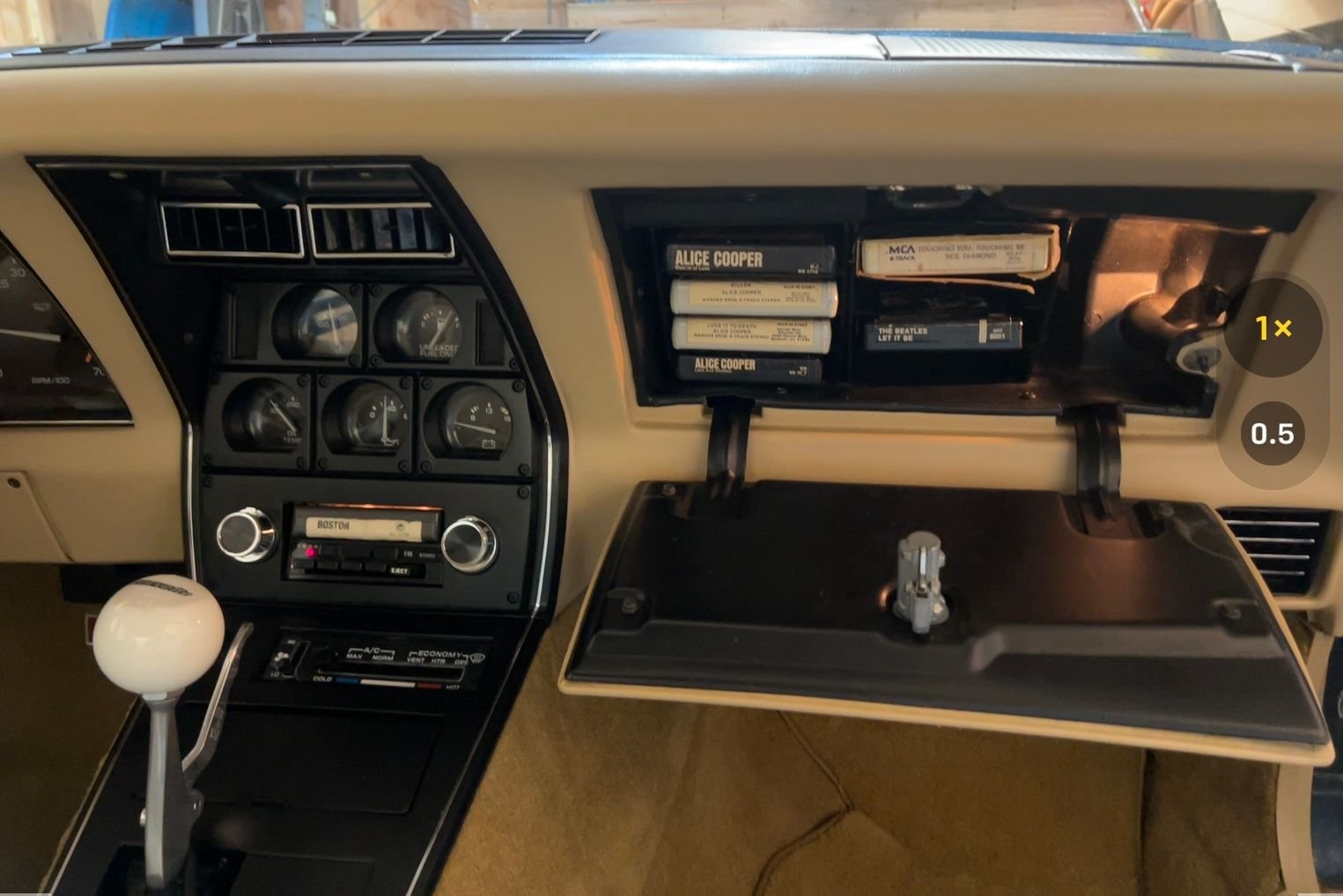

i put in the rear storage compartment and wired my 8-track in to the aux port so i can play everything through it.

OK, so it wasn't a typing error - you really have an 8-track THAT WORKS. Very clean job on the rear speakers and amp!
its not stock but looks it and works great. found a NOS clarion 8-track still in box from 1977 on ebay. just had to put a new belt on it.
