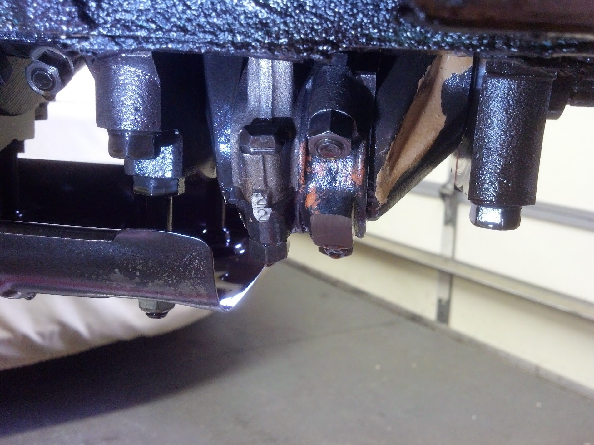

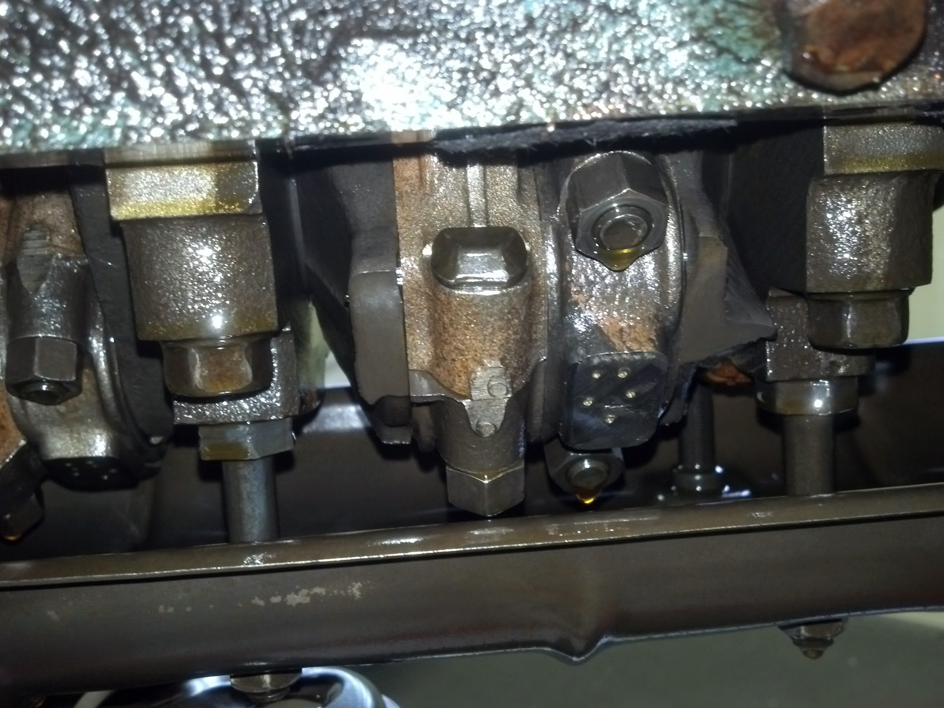

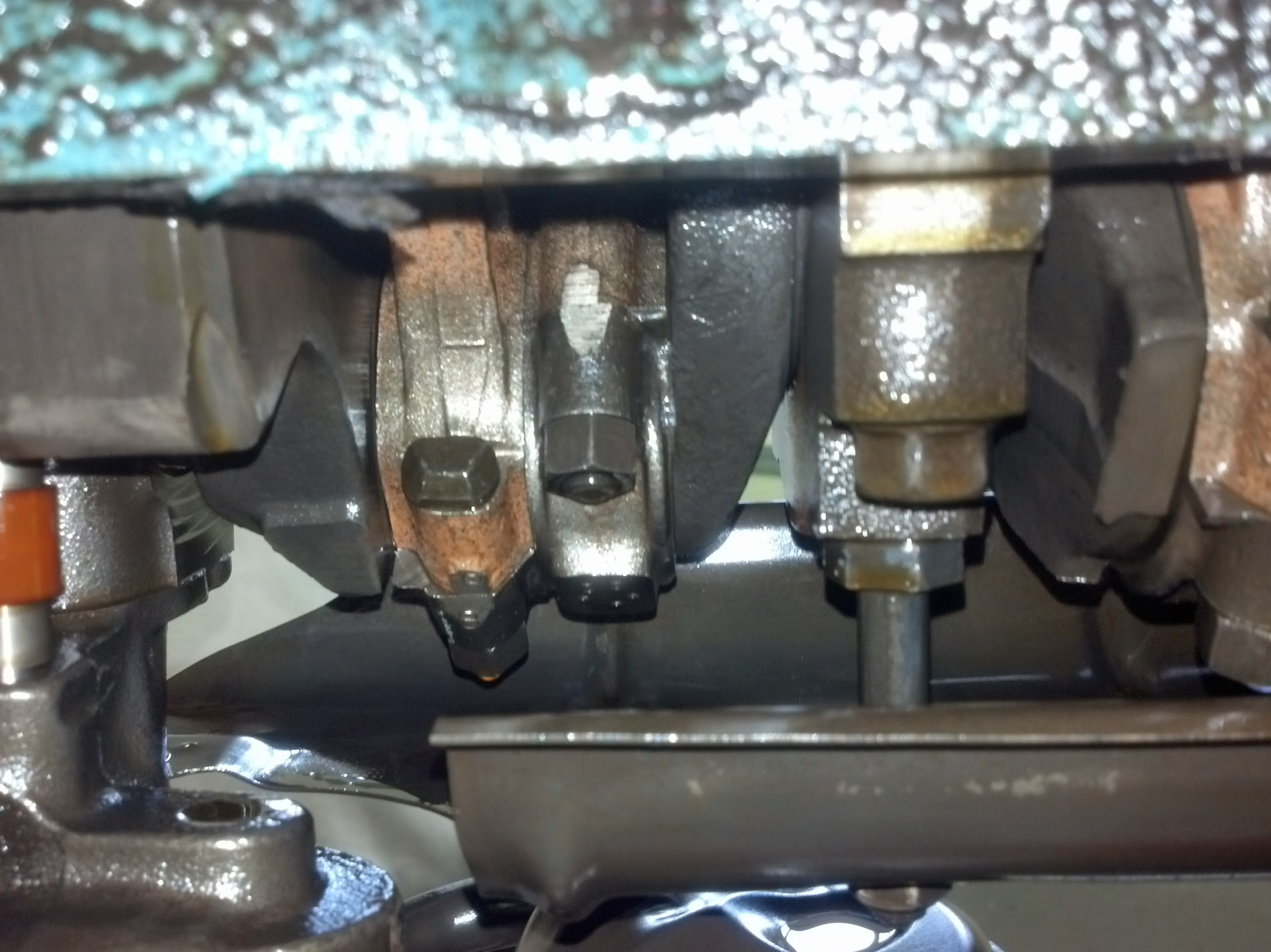

When I pulled my 78 L-82 OEM engine in 2014 for the rebuild, I have these photos of my L-82 rods.
I suspected the engine had been apart sometime before I bought the car with 35,000 miles on it in 1983, either for a warranty issue or a component failure, which was confirmed by the machine shop. Someone definitely had been in the engine before 1983 but the consensus was that marked rods indicate a disassembly of the rotating components.
To 1978 L82 rods
