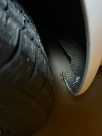

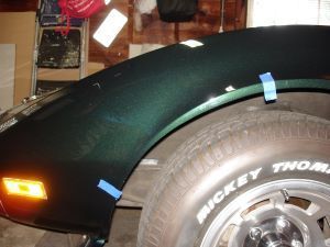

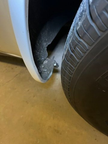

Old Apr 30, 2026 | 08:48 PM
drwet's Avatar
drwet
Joined: Dec 2009
Posts: 3,229
Likes: 656
From: Thunder Bay
Excellent advice on the PPE for the fiberglass dust. I have to admit I am not good at protecting myself.
Here are my wheel wells. Sorry about the poor quality photos.
