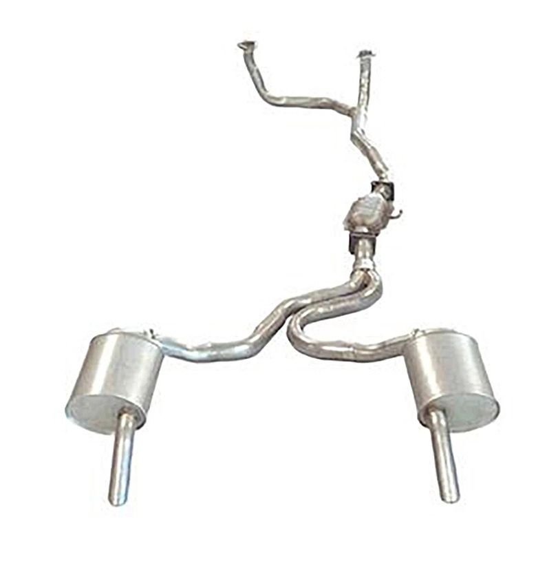

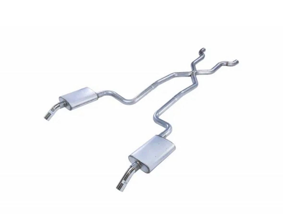

A dual exhaust has an individual pipe for each bank of cylinders rather than both banks going into a single pipe. They flow significantly better, can support much more horsepower, and sound pretty good too.
Single
Dual
Sometimes dual exhausts will have a crossover “X pipe” for acoustic reasons and evening out the flow. The crossover is adequately sized though to prevent being a restriction.
Dual with X pipe
Since you’re looking at replacing both the catalytic converter and the mufflers I would go a small step further and replace the whole single exhaust with a dual system. The only real drawback is the cost, but the ones sold here are fairly reasonable on price and are made with high quality materials. I would get the L82 2”-2 1/2” kit and depending on your transmission the automatic or 4 speed (manual) kit.
When you’re under the car working on it that’s a good time to check everything over. Look for any rusty spots that might be concerning, or if the engine, transmission, brakes, or differential is leaking any fluid. Any 47 year old car will have surface rust in a few spots, but as long as there’s nothing with holes in it or extreme pitting you should be alright. Post some pictures!

Does the state you live in do emissions testing? If not you don’t need a catalytic converter.
Personally I wouldn’t bother with the X pipe unless you’re experiencing an annoying drone at certain RPMs while driving.
