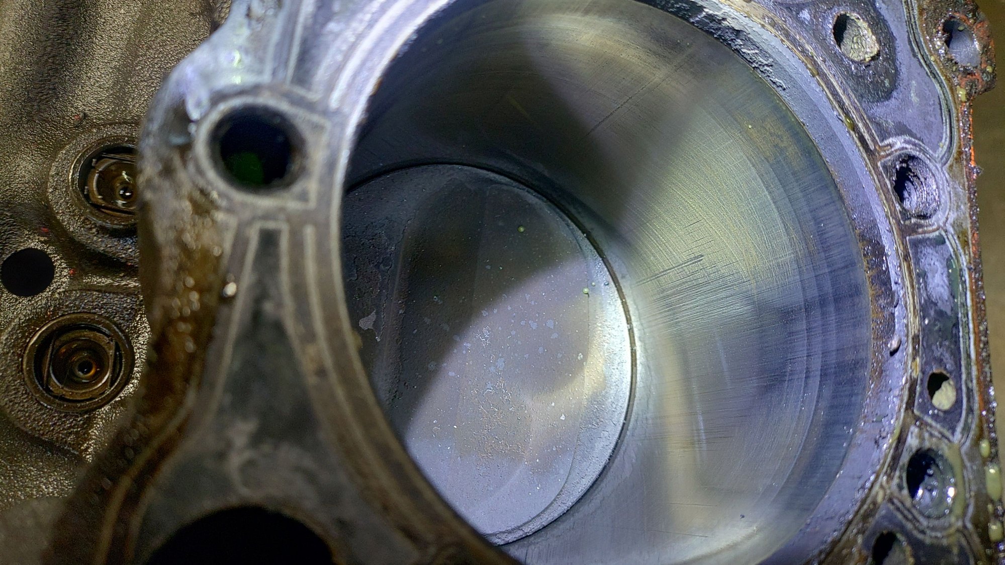

Rebuilding a L46 engine that has remained 100% stock sans intake / carb.
Bought as a driver with few drivabilty issue and finally found that the No.1 Intake Cam lobe is wiped. Car actually had decent get up and go for 7.25 cylinders working.
Looking for solid, complete advice on what I can do to keep as original as possible, but make something can be driven for 2-4 hour road trips. I do have 93 in my area as well as excess to few gallons of 100LL.
I would like to stay Flat Tappet if possible due to costs.
I've rebuilt flatheads and one stock 5.7 (TBI motor) before so not new to engine rebuilding but new to Hi- Performance Rebuilding.
I have done alot of research and searching but often there are missing info, or engine is not kept original at all or just replaced.
Thank You guys!

Assuming you want to save the block stamping numbers, the .015" thick steel shim head gasket is a must have IMO. They need a coat of copper coat head gasket spray before installation. This will establish a good tight quench that helps prevent detonation.
if the bores can be saved, you will be able to save a LOT on an overhaul. Beg your machinist to measure it carefully for you. Some guys want to rebore EVERYTHING that comes into the shop. A hard stone hone job will show you where the bores are as far as being able to reuse them. Let's hope you can save them.
Don't upgrade the valve springs. Don't use "Z/28" springs. Use base engine springs. Your cam and lifters will thank you.
That's all I got off the top of my head.

I am hoping a hone job would work as well. The car itself has 62,000 miles on it and I am confident I am first into the motor.
