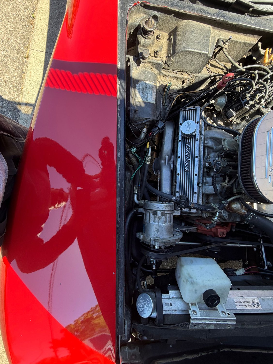

When I rebuilt my 73 I replaced everything under the hood.
i bought a kit from https://nostalgicac.com/products
back then they offered a kit for C3 corvettes. It had a parallel flow condenser, a Sanden 508 V-belt double groove compressor and brackets, and a hose kit. The hose kit had several fittings and hoses that you cut to fit and crimp together. I did end up ordering some different fittings to complete my install. On addition I bought the evaporator and accumulator made for a 1978-82 to replace the VIR system.
i charged the system with R134 and been happy ever since. I do have to add a can of Freon once in a while in the spring after a long winter nap
I removed the stock recovery bottle so I had more room to work inside the fender well. Someday I may make some new hoses so I can reinstall the factory bottle

I have the C4 fan, but I believe I threw out everything except the POS condenser.
Not sure what else I have?
There was a Co that ran their car up the mtn w/trick AC products.
I remember they had some good stuff.
I'm 72 w/bad back!
Leaning over the engine is very hard on me.
The compressor looks like a good start!
