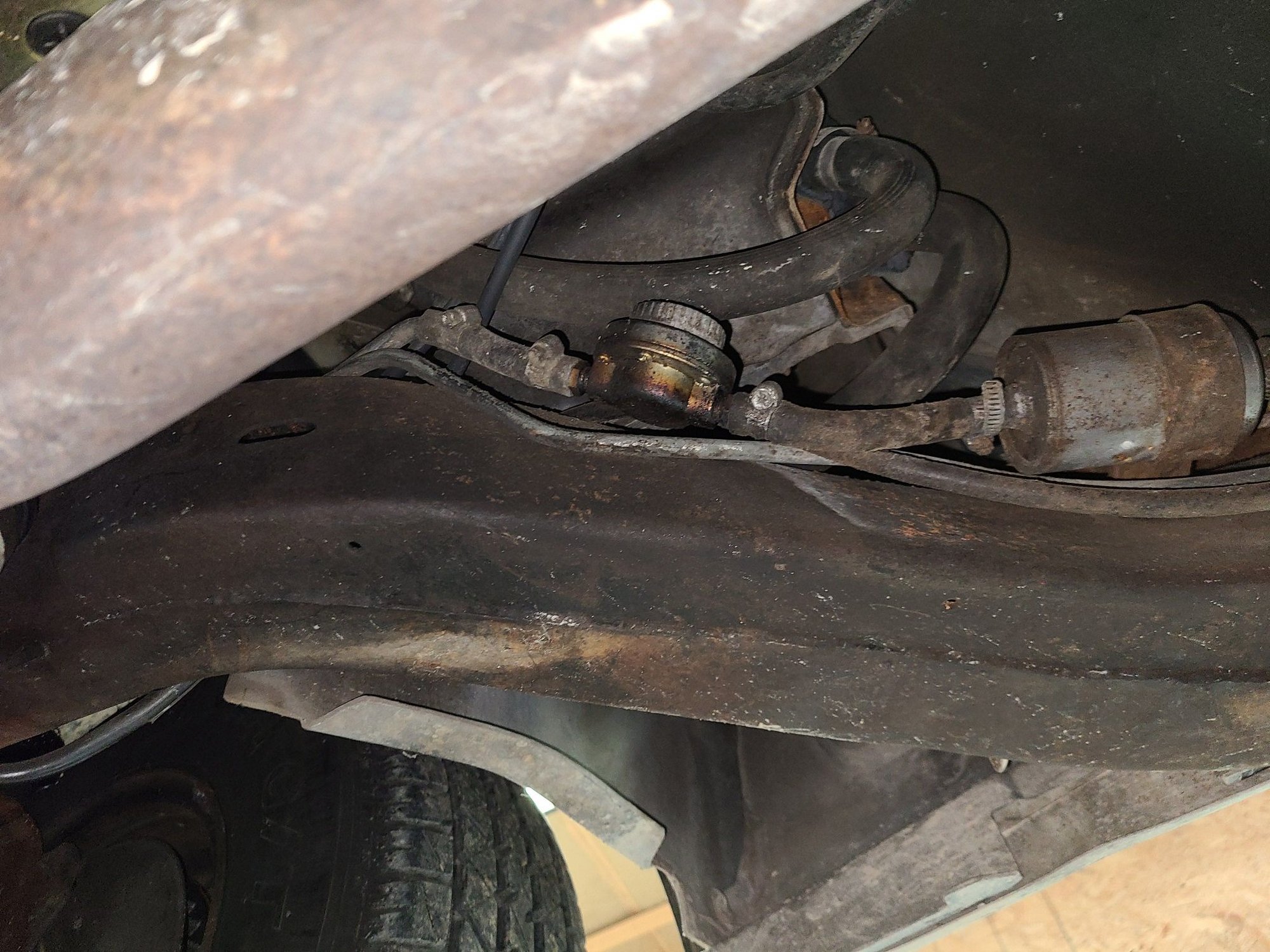

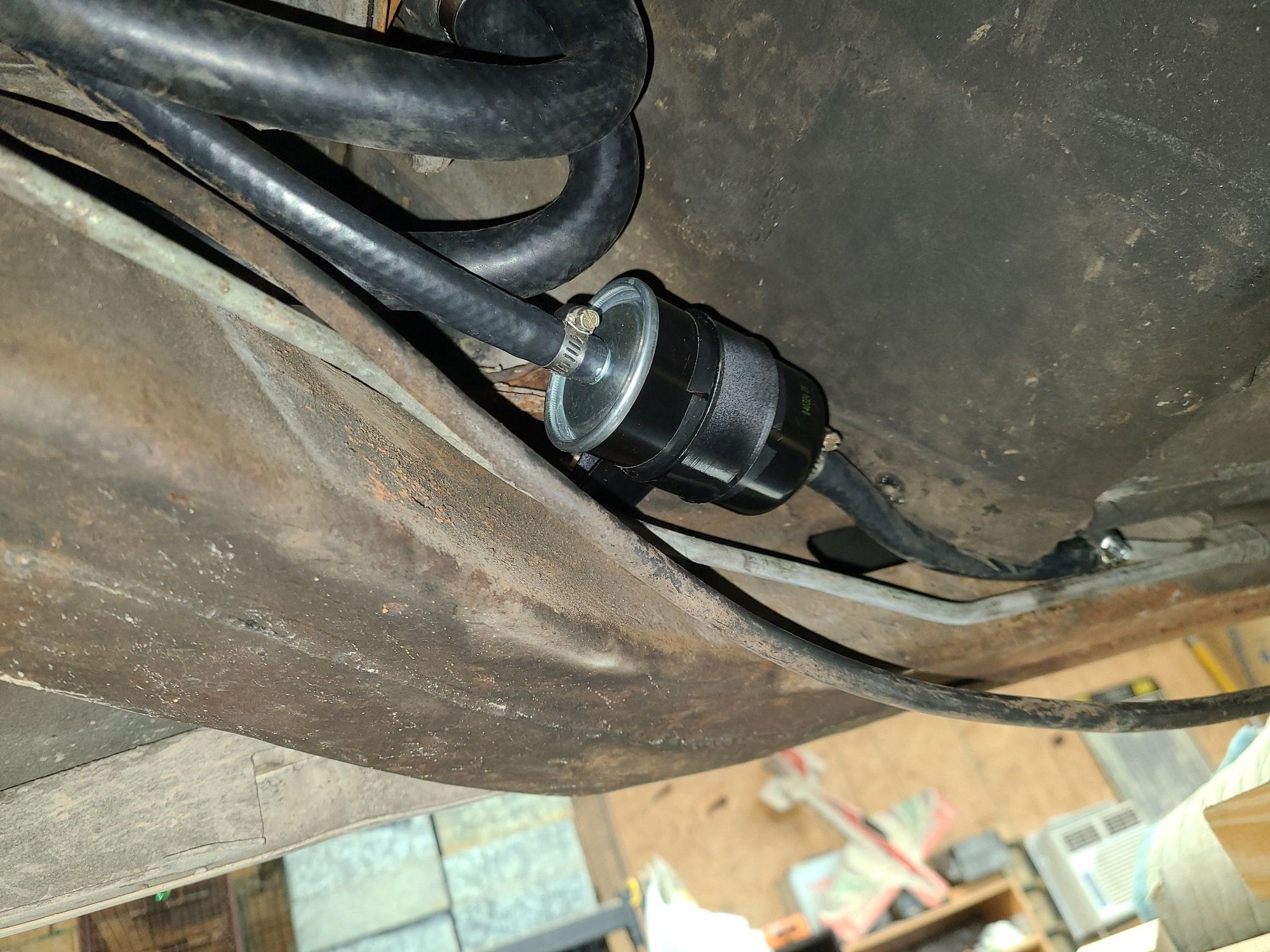

You might want to change the fuel filter and while that's out flush from the tank to the fuel filter. In case you don't know it's located behind the right front wheel on the frame.
New fuel filter installed.
