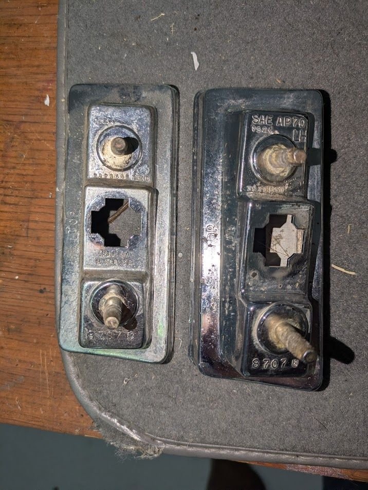

A while back my left rear side marker lens fell off - the rubbery yellowish glue must have dried out. I now have a used replacement assembly and it's lens seems snug and tight. But I checked the other side markers and Yep - the right rear is also very lose and about to fall off. So I need to glue at least that one (heck maybe I should pry them all off and re-glue!)
I was going to re-glue with some clear silicone household caulk...? Unless anyone has a better suggestion...
Thanks,
PS the pic below shows the previous one (now missing lens) and the new-used - some slightly differences in casting details (no "SAE AP70"). Is one of them a repro vs an original?

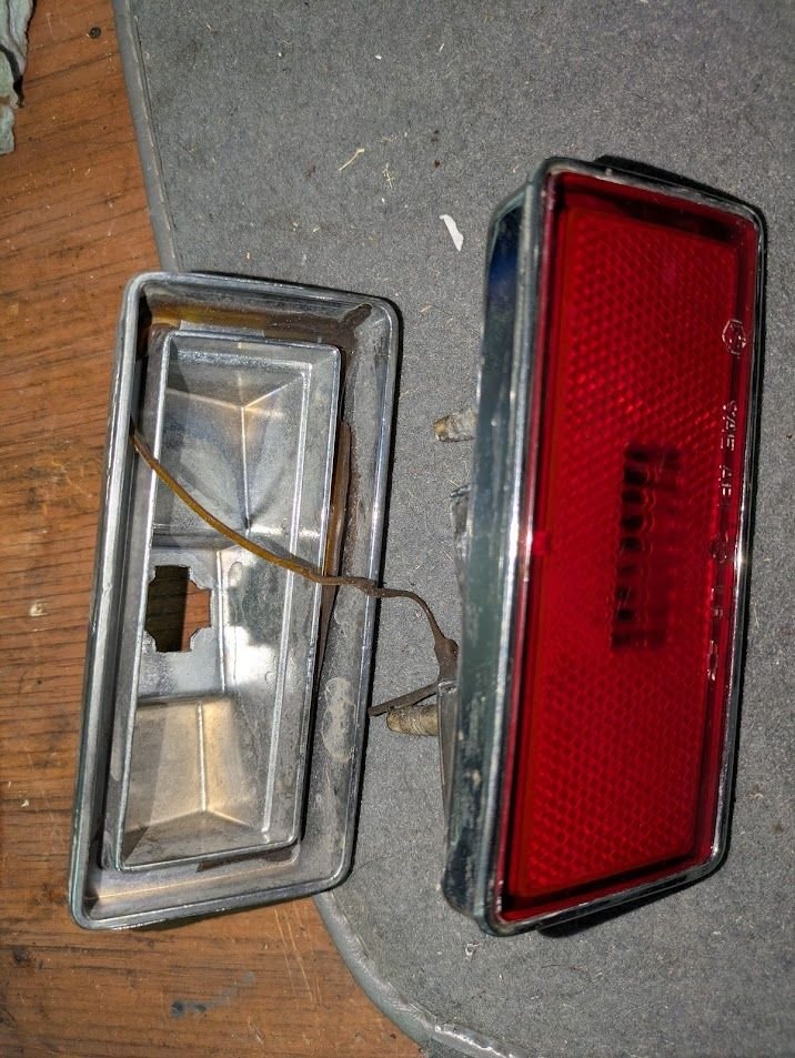

One odd thing I noticed was they have a metal blocking plate inside the plastic lens with a small rectangular cutout - evidently the light is supposed to only shine thru that smaller cutout then reflect on the red plastic.
