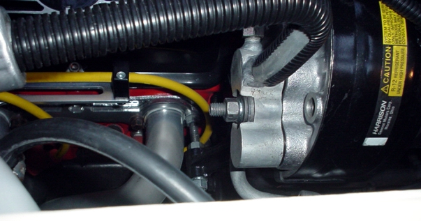

i have those headers and love them...
they fit like a glove and i even have steeroids...

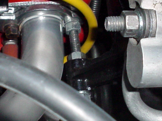

as far as the a/c bracket goes...i kept hearing about a special bracket, but after looking at it and studying it over i did this...
it works awesome...looks good and it didnt cost me anything!
i had a piece of stainless 3/8 threaded rod lying around (dosnt have to be stainless)
this is easy to remove if need be also!

Thanks to all who have answered. I appreciate the help.
Signguy,
That was one of my plans for the A/C bracket, the other was to also use a piece of pipe or a steel spacer in between the nuts to add a little extra support.
