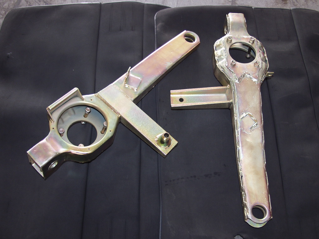

You can use koni coil overs but not on the rear shock mount, that is by far not strong enough. The way to do it is something like this:
What kind of shocks do you have? 8112 or 8212?? If they are SPA1 specced shocks I wouldn't use them on the street (valved for drag racing) because they will get very hot then and may possibly fail.

Where did you find the trailing arms?
I have a set of 8212's I used to run on a ProStreet '70 Opel GT, w/a Blown SBC, 9" ford rear, and wheelie bars. I loved the Koni's for being able to adjust them for softer ride, or bump them for the track as needed. I never had a problem with them heating up on me. I'd have to get new springs for a stiffer rate I'm sure. My Opel was only about 2800 lbs.

The trailing arms are stock with those vertical bars added
