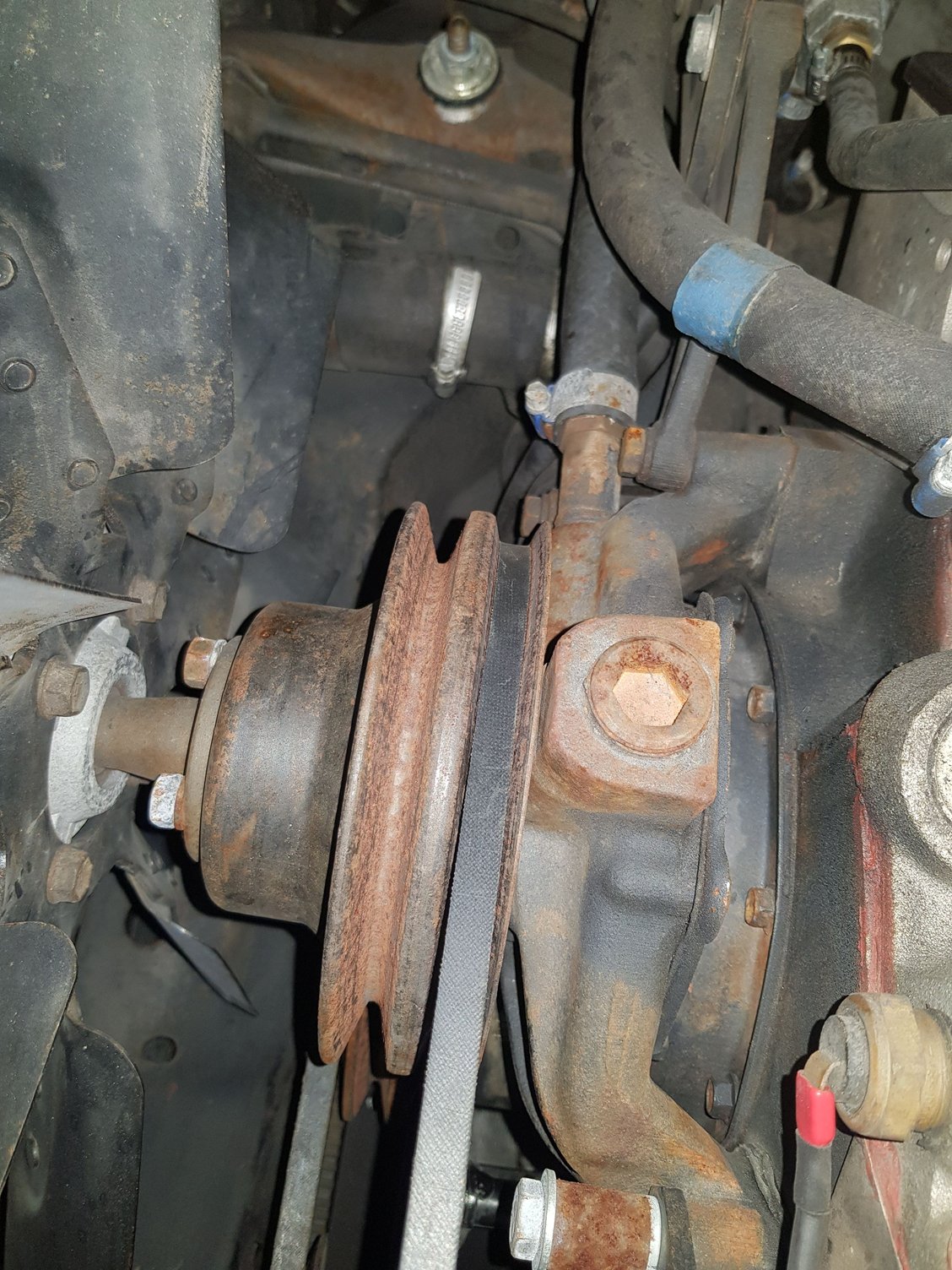

Old thread, but, my belt keeps slipping.
The alternator and belt is new and the belt seems to sit too deep into the waterpump pulley? The car is new to me so I dont have the old alternator/pulley...
Should I get another alt. pulley with wider groove and wider belt? My current belt is 10 mm or 3/8".

If the belt is too thin, it may ride on the bottom of the pulley and not get full contact on the sides. If it's too wide, it may ride above the top of the pulley and not get full contact on the sides.
You generally want the top of the belt to be just below the outside edge of the pulley.
Belts do come in different widths. There is a method to the numbering of the belts, where you can order a same length belt in different widths.
Some of the corvettes with air conditioning used deeper pulleys because chevy was afraid of throwing the belts at high rpm.
OP, does your belt slip?
Try cleaning all the rust, gunk off of your pulleys. Wipe down your belt contact surfaces with acetone, laquer thinner, etc. Also, I've found that different brand belts are harder/softer/grip better. Try another brand.
The photo's above seem to show a deep pulley at the water pump and a standard pulley at the alternator.

The pitch of the V varies with it being old INCH/American or Metric a metric belt rides lo in an old pulley, and the converse is of course also true....a more common metric belt will wear heavily on the upper edge of the V and cause a concave surface on the back of the belt, along with frayed edges.....

Its a AC car, is there a deeper alt pulley avalible? What is the standard belt width?

Deep groove alt pulleys:
Here is reference I found for Z-28s..... See post #22:
https://www.corvetteforum.com/forums...post1595076650
Which leads us here where we can find the uses:
http://gmpartswiki.com/getpage?pageid=88980
Which identifies 1970831 for Sp hi-perf applications (superseded by 3844100).....which then leads us to:
https://www.ebay.com/itm/NOS1970831-...YAAOxy9tpR-8Ir
So, yep, looks like deep-groove stuff, I had original ref info because of my 68 L-79. Hope this helps, but it really looks to me like your belt is well seated in your pulley at the present time. I recommend getting a quality brand-name belt before you go off chasing pulleys.... I didn't believe it when the parts guy told me-- until I got one and the I immediately quit having squealing problems.

Put a wider width belt of the same length on. I use a 1/2" wide alt belt. I just went down to the local parts store with my older, narrower belt and they sized one up.
