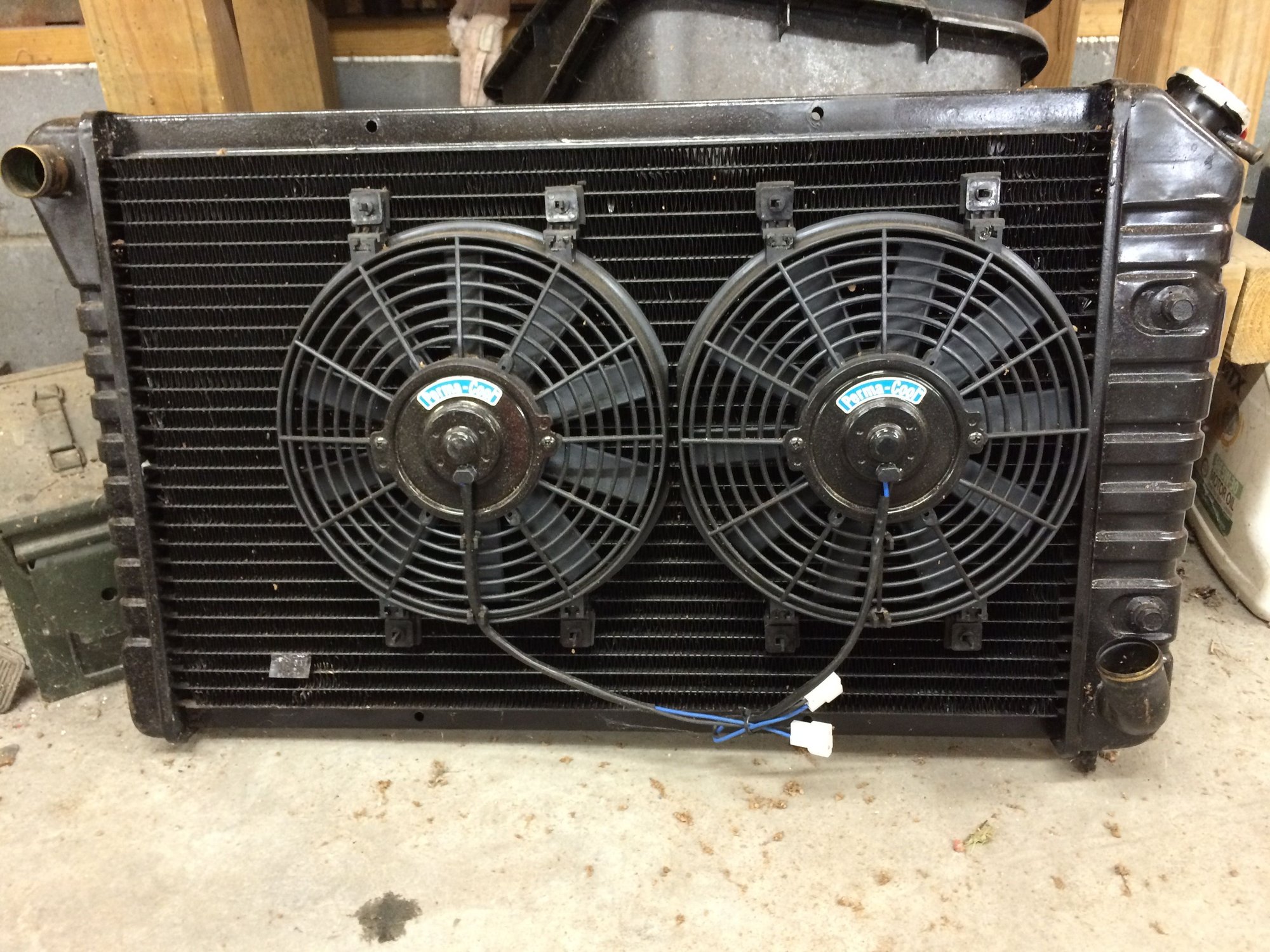

This is my Permacool setup on the stock 79 radiator. They are both 10 inch fans and as you can see they are mounted as far to the right as I could get them. This avoids that LH upper control arm and when it's installed the fans set pretty much dead center of the car.

Rebel...you might want to reconsider the zip tie through the core idea it is asking for problems,
