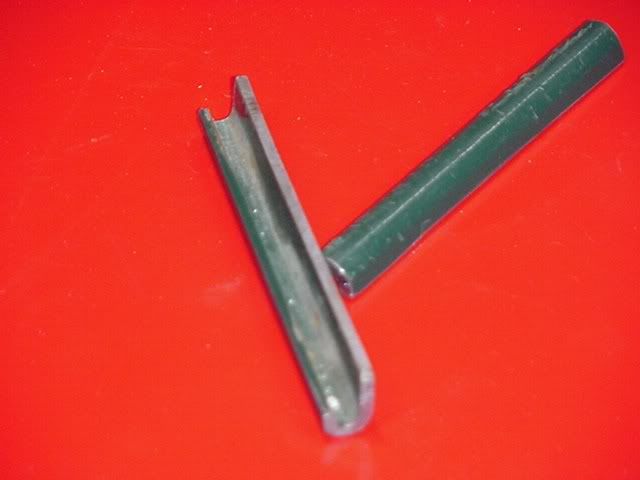

My car is the same way. I've seen others, though, where the frame is visible below the plastic rocker panel edge. I am also really paranoid about the jack pad slipping and *somehow* clipping a brake or fuel line, so I made these saddles out of some small c-channel to go between the frame and the jack pad. This way the saddle engages the frame and the jack meets up with the saddle. Seems to work for me.
They look like they would work well...I have been using "Hockey Pucks" between the frame and my jack or lift and they too work well.
