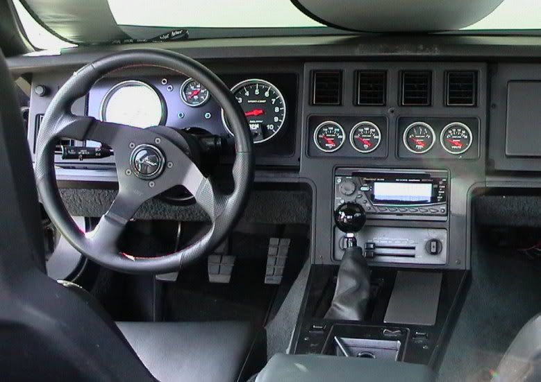

Hi, I was really never a fan of the digital 'star wars' dash of the c4 vettes. Is it possible to convert the dash to analog? If it is possible where can i look for this conversion? How much do you think it will cost?

I don't know of any "kit" but I did this in my previous '85. I replaced the star wars with Autometer Phantom gauges. It was straight forward, just spliced the appropriate gauge wires into the appropriate wires at the star wars connector (signal for the oil pressure gauge, signal for the coolant temp gauge, tach signal, etc)
If you're familiar with automotive wiring it's a pretty easy job. If not a competent shop should be able to wire it up for you.

With that link up above, you can go to say jegs, and price out the gauges you need, to give you a rough idea of what it will cost. I put a oil pressure and a water temp in my info panel area, and later on I will do the speedo, tach in the main cluster. I can't give you any other help in the cost dept. I have to many other mods going on to get to those right away. Randy
