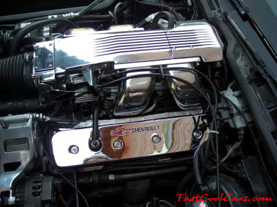

For more information and pictures these guys can do it all, and basically anything aluminum too or more. Here is a link to find out more:
http://www.fastcoolcars.com/TPI-polished-and-more.htm
