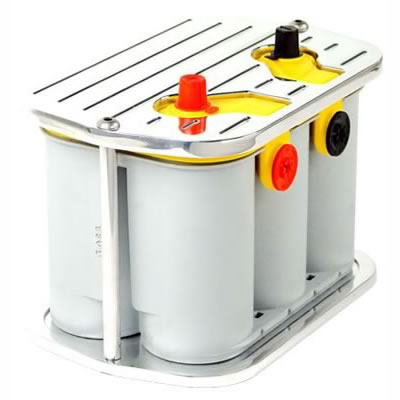

Just a bit off topic. I got a catalog from Summit Racing called Genuine Hot Rod Hardware Inc. Look at this cool (and pricey) Optima battery holder:
There was a lot of great stuff in there. More at www.genuinehotrod.com
