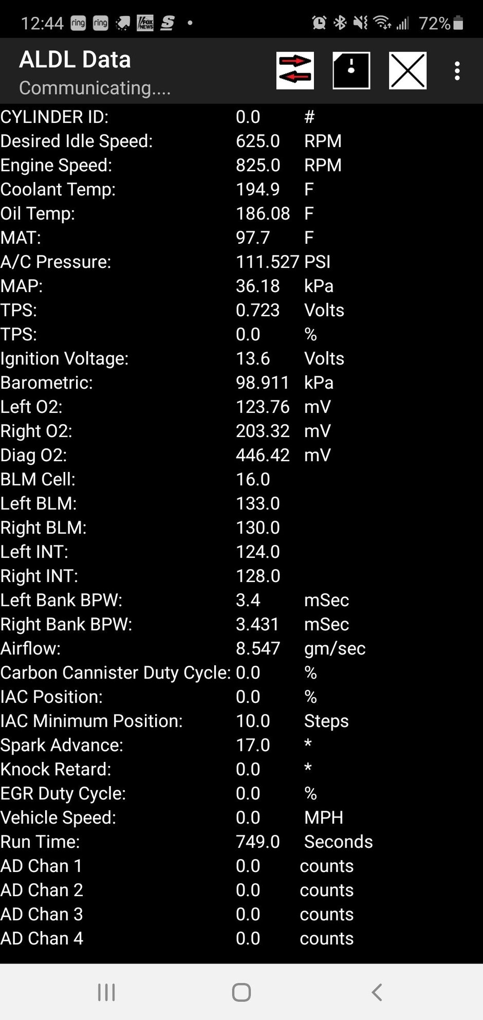

With a Tech-1 or similar scanner, you can observe the voltage swing average of the O2s as the engine idles. Normally they should read near the middle or a little less (say ~ 450 mV). But, a reading in double digits would indicate a LEAN condition. That being the case, Either the O2 is going bad, OR in fact that bank of cylinders is running LEAN.
Two ways to further investigate: The easiest is to swap sides and see if the readings follow the particular sensor, or are the readings consistent with that particular bank of cylinders? But, before you swap sides, take a reading of the injector dwell time. If the dwell is longer on the side where the O2 is reading lower than the other (by a significant amount), that is to be expected. And, if after swapping the two the dwell time also changes sides, you have double the indication of a bad O2..
Cross counts is the number of times the O2 voltage swings from high to low over a period of seconds. They vary depending on idle rpm and to some extent mixture, but they should be approximately even what ever the cross count number reads. However, if one sensor is reading significantly less cross counts than the other, (e.g., one is reading say 150 and the other is reading 20) the sensor reading low indicates a "lazy" O2 sensor and it needs to be replaced.
Change BOTH O2s. And, as mentioned, stay away from the Bosch O2s and stick with AC Delcos The Bosch have a history of failing (going to ZERO volts resulting in that side going very RICH. Ask me how I know!!)
Old Aug 14, 2020 | 01:50 PM
temcgregor's Avatar
temcgregor
Joined: Oct 2018
Posts: 70
C4 of Year Finalist (appearance mods) 2019
This is what I got
